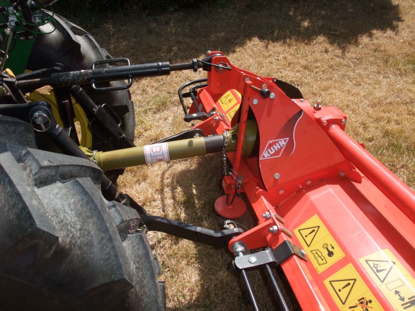

For implements that can easily be moved like a trailer or my tiller, I move the implement for the final centimeters.

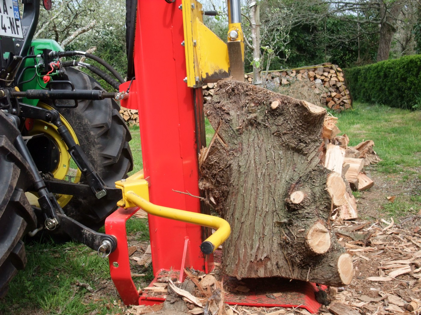

For implements with an important vertical development, like my log splitter, I hitch the third point and screw or unscrew the link to align the second arm with the pin.

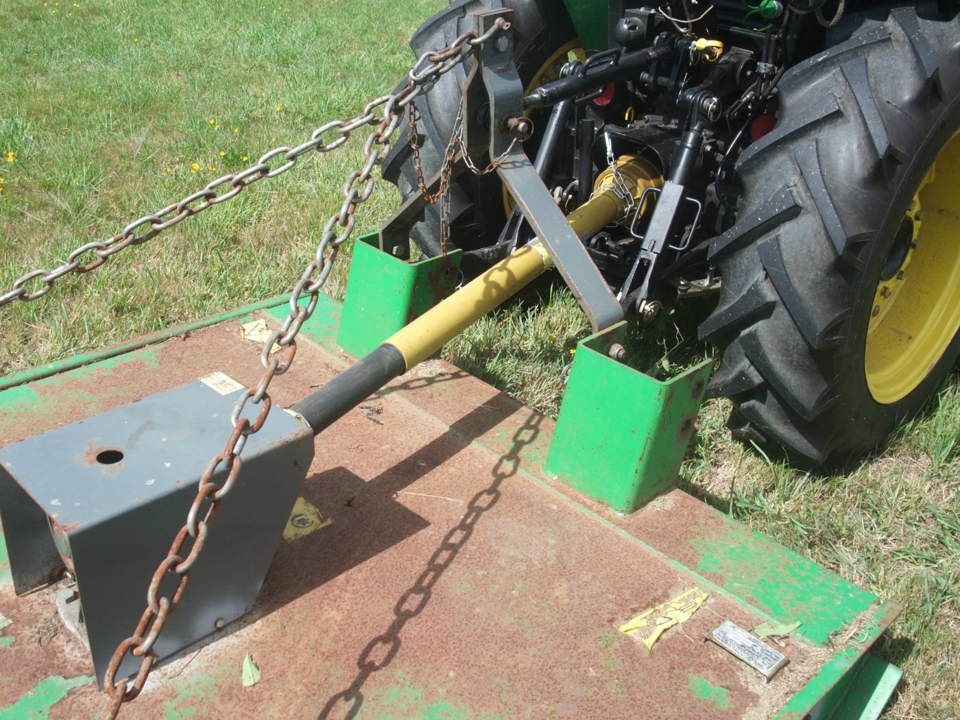

For very heavy equipment like my bushhog, I lift the implement and lower it with the one connected arm and drive forwards or backwards until the second arm is aligned. I then connect the third point and shaft.

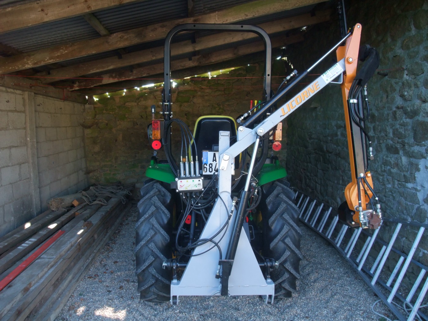

Implements that are extremely unbalanced like my hedge trimmer may require lifting with the FEL and standing on logs or hanging from a tree to get hitched.
