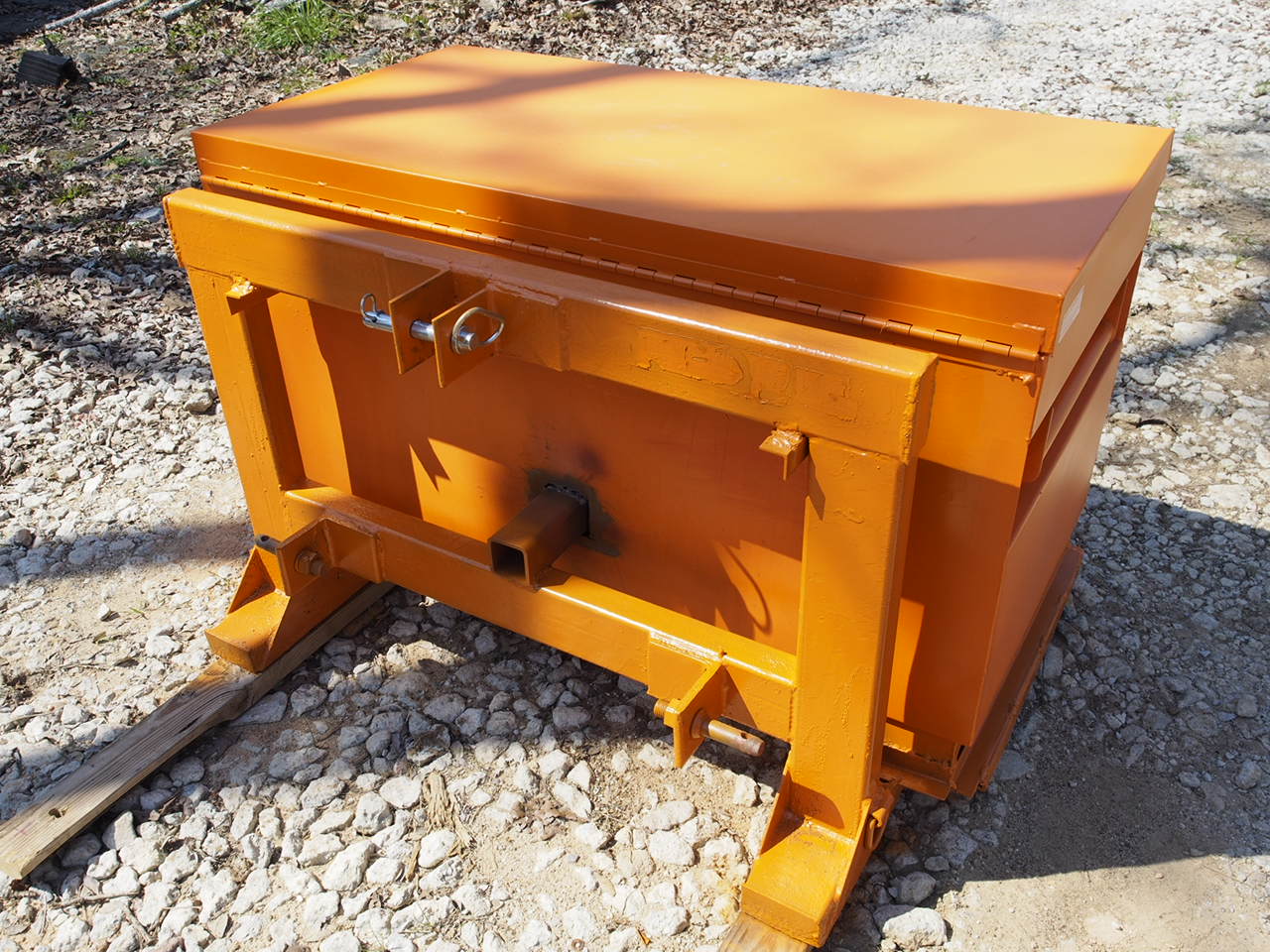

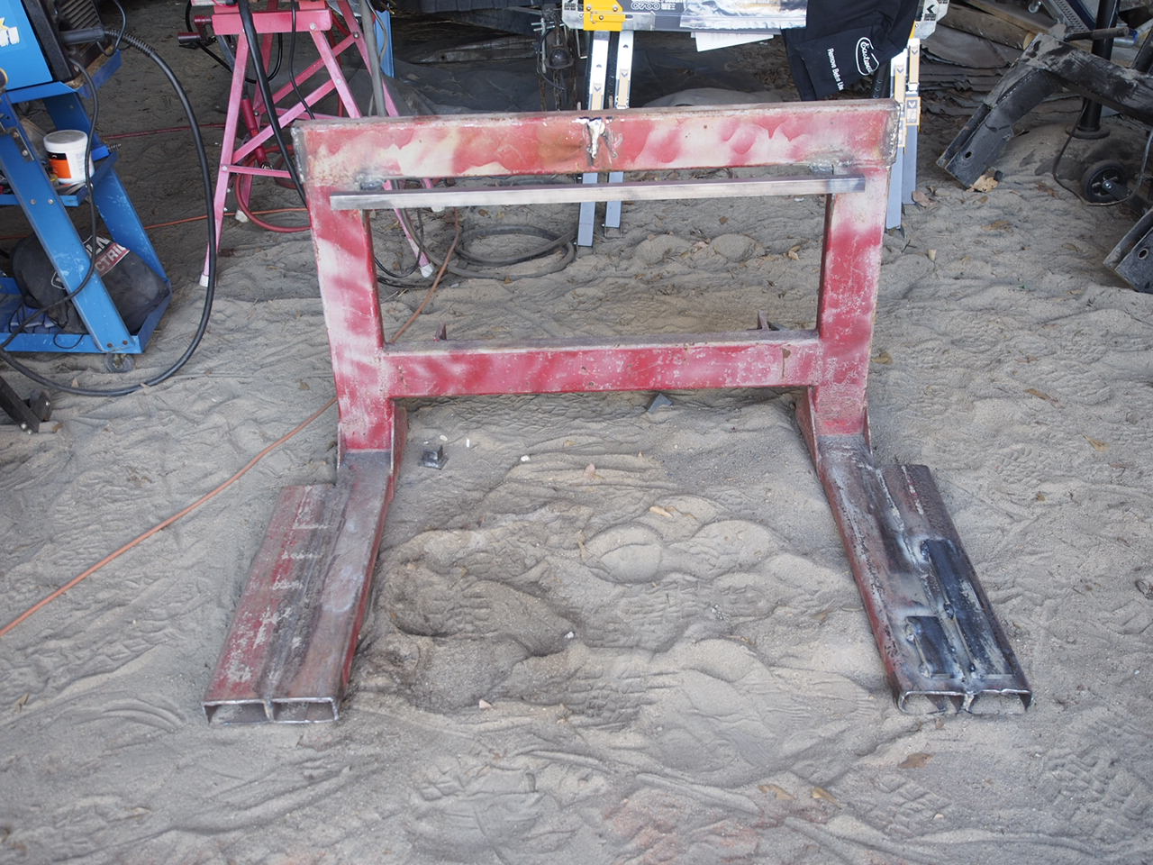

You might also check used farm implement sellers and auctions. I am in the middle of building a weight box using a donated 3PH pallet mover and a job box after not finding anything locally pre-built. Filled 1/2 full of concrete it will weigh ~ 1250# and still leave room for storing things/adding more weight if necessary.
A friend needed help moving two old Ford tractors and some implements upstate to a buyer/reseller he deals with and we both took loaded equipment trailers. While they were discussing prices and such, I was going through three+ acres of used and new implements and discovered the perfect weight box someone had built and it was only $150 U.S., complete with heavy weight wooden, steel reinforced box mounted to a strong 3PH framework. Was probably a 10 cu.' box. Mannnnn, just my luck.
My current project. Will add concrete next week when it warms up and dries out around here.
