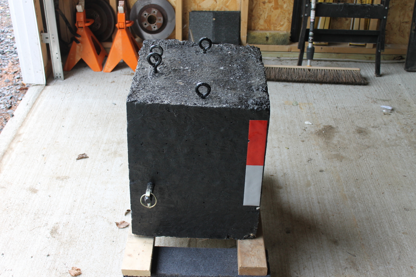

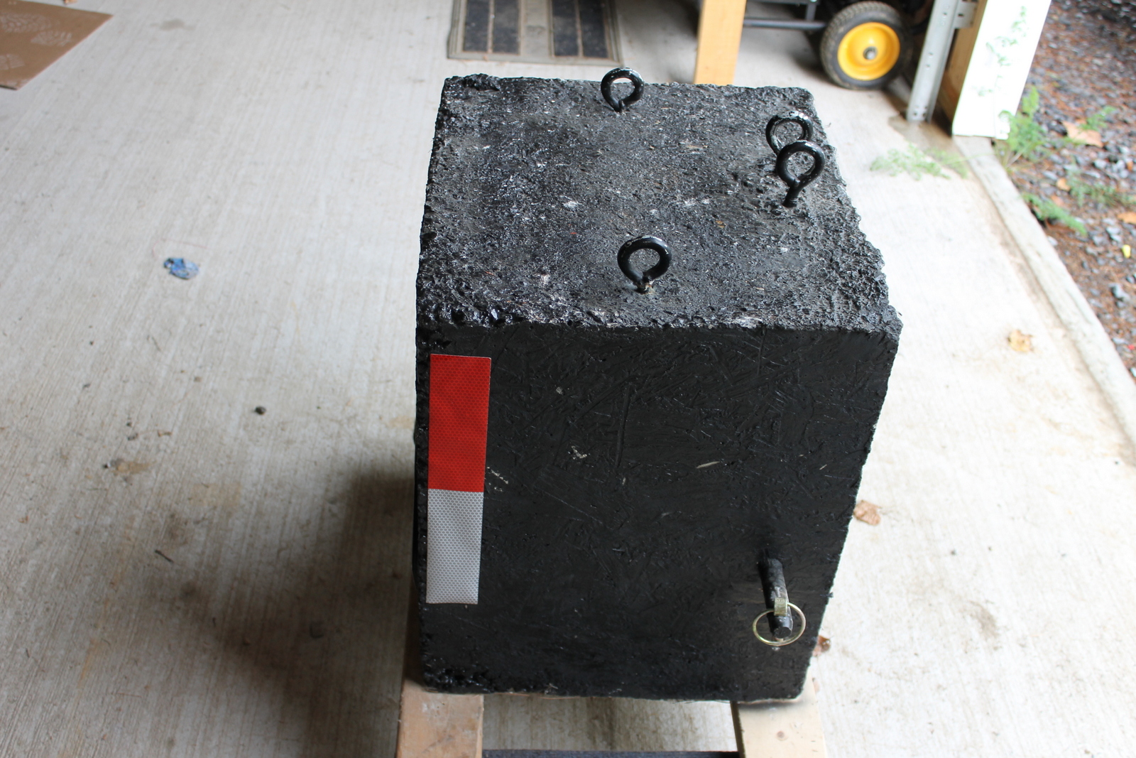

This is what I built:

That's the one I was talking about! Big, plain old bank vault of a block...and I bet it works just great! I'd do exactly the same, except maybe run an angle in the back corners of the frame - just to purdy her up a bit.

That's a LOT of Weight for those Eyelets, the way that weight will bounce around I can see it separating those eyelets. I've seen the cast eyelets break off, just make sure you get the Heaviest eyelet you can.

I welded the eyelets closed, plus each eyelet is rated at 350 lbs.

Worse comes to worse, you can always wrap a chain around it. So, how much does that block way?

Its weight is around 450 pounds. I made the forum an filled it with 4000 psi fiber, that was leftover from pouring my garage concrete slab.

So you got anti-sway chains to keep from moving? Those Cub/Yanmars are good looking lil' tractors..
