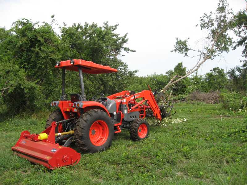

My DK40se does more damage than my CK20 when the ground is soft. However, it doesn't cause any real problems just driving over the ground, what gets me into trouble is when I am pushing with the FEL. The 40 has enough power to spin all 4 R4s (unloaded at this point) and that is how I damage turf. :ashamed: Lots of little 4 part divots in areas where I was pushing on a tree or bush without paying attention to traction.
I believe the DK40se and therefore the equivalent CT440 are the sweet spot in the Daedong line up above 30hp. However, that is mostly because I highly value the KL401 loader and its 2700lb lift capacity. If I was really just mowing pastures and doing routine FEL work rather than clearing trees and using a grapple to uproot bushes whole, I would seriously consider the DK35se or CT335 and save a few bucks. The difference in horsepower is only 38 to 41 so really pretty insignificant. The frame size is pretty close though the DK35 has smaller axles/tires so appears smaller. The motors are different (3 vs 4 cylinder) but that should not be a big deal. Importantly, the operator station and electrohydraulic controls are identical and those are very nice features and a big upgrade over the CK35/CT235. As a pasture mower I'd think carefully about the CT335 if the price difference was $2K. Worth the upgrade from the CT235 IMO and rather than going all the way to the CT440, the savings of $2K will get you a very sweet 6ft Caroni flail mower.:)
