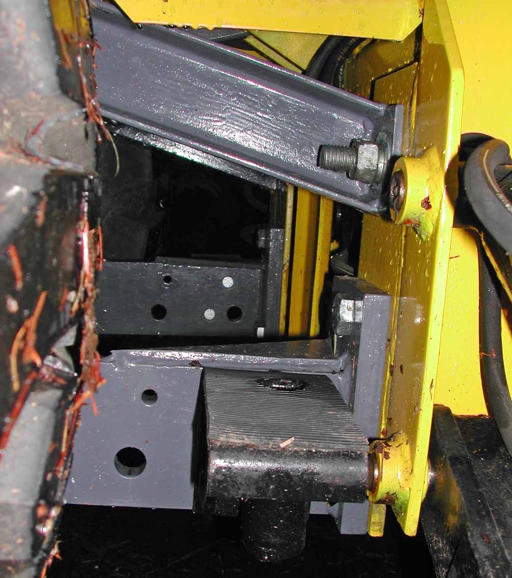

Here is another photo of the hoe side of the subframe, as requested.
The upper part connects to the bar that goes over the axle housing. Not shown it the 5th point of attachment, the enhanced toplink.
After 16y and 200 hours of digging, the subframe has held up fairly well. I have only taken it off when time for replacing hydraulic filter (every 400 hours), which is blocked. I recently replaced O-rings in the valve stack, plus the 6 heim joints used in the joysticks.
I leave the hoe mounted all the time, as the counterweight allows me to use the full capacity of the FEL. About 1400# total weight of hoe and subframe.
Two possible changes I would consider if doing this project over: even closer mounting to the back of the hoe, even if that means eliminating the steps on the sides, like the 4300 I did. Also, welding the hoe-side part of the subframe right to the hoe, instead of drilling and bolting would be easier to do.
