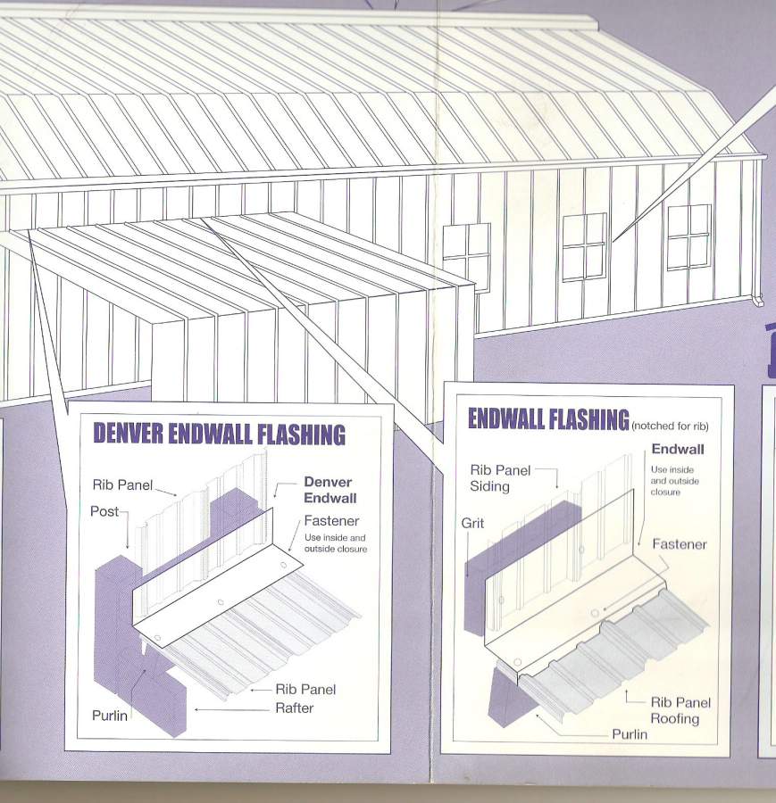

I'm looking at attacthing a lean-to to the side of my pole barn and not really sure how to get the top to seal up next to the exsiting wall, because I'm going to drop the starting point down the wall from the top of the building about 5 foot. The buildings side wall is 15 foot and I want the lean-to to start at 10 foot. So what would be the eisiest way to join the roof line to the side wall,it doesn't nesasarlie have to be 100% water tight.
/ Yet another lean-to pole barn question #2
Your siding Mfg. has what you need. (see attached) you can use Endwall flashing either flat or notched for rib style. You'll need to attach some sort of header board to the garage wall for the rafters to attach to. The metal siding / roofing company should have spacers to match the ribs in the siding. If not then you may need to cut out a horizontal section of siding to attach the header board to the structure behind it.

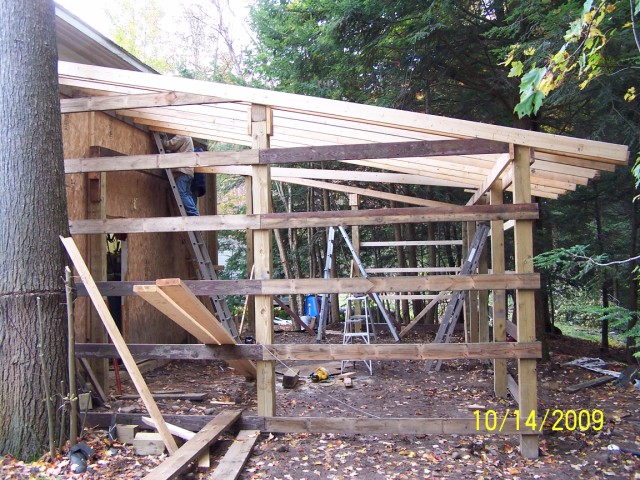

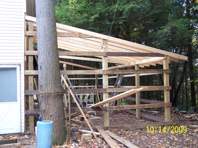

I'm attaching a 16' x 32' pole barn addition to the back of my garage. My roofing panels will butt up to the garage wall then I'll be using the endwall flashing notched for rib to complete the connection.

Georges method is the right way, but I have seen some folks that didn't want to go to the expense just use a reversed corner flashing and caulk the top where it is flush with the existing side well. Didn't seem to leak but I can see how it may in time

You said about ten foot, it appears in the picture of that sidewall that the top purlin is about that ... so snap a line and cut your exsisting side metal so you can slip flashing behind that wall and on to your new lean to roof ... done deal.

I know of an addition that was tacked on and caulked. Looks like snot. do it right, take the siding off, put a header, etc, cut the metal, use a endwall transition from wall to lower roof, etc. Make it look good and water tight. I will probably add a side to my barn in a couple years.
Check out endwall detail here:
http://www.fabral.com/downloads/details-postframe.pdf
