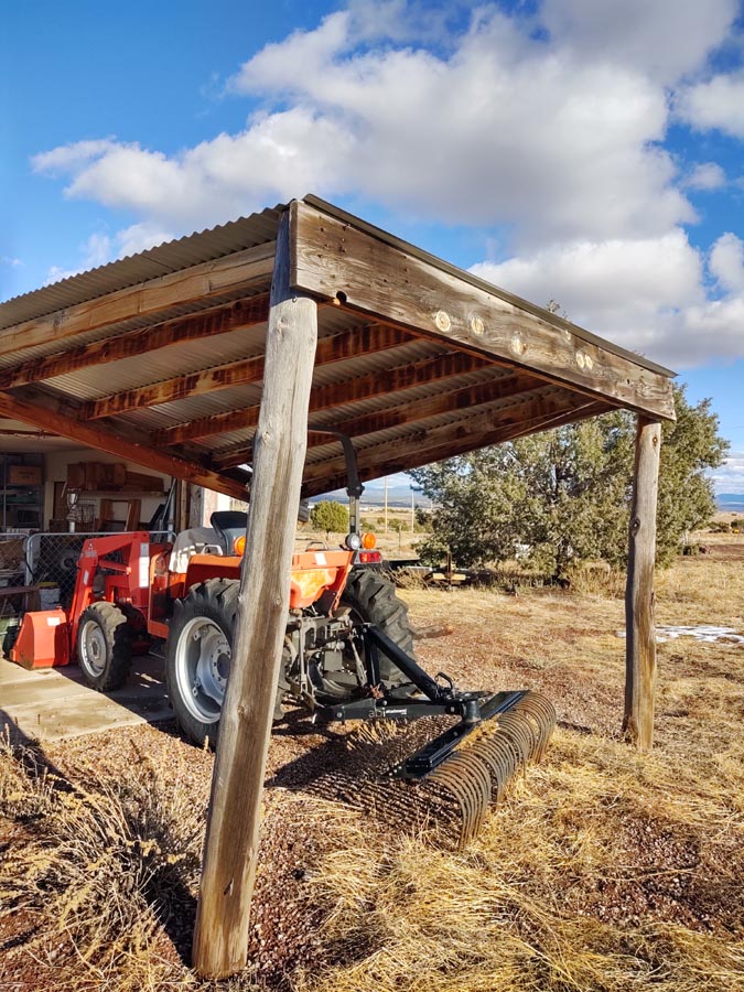

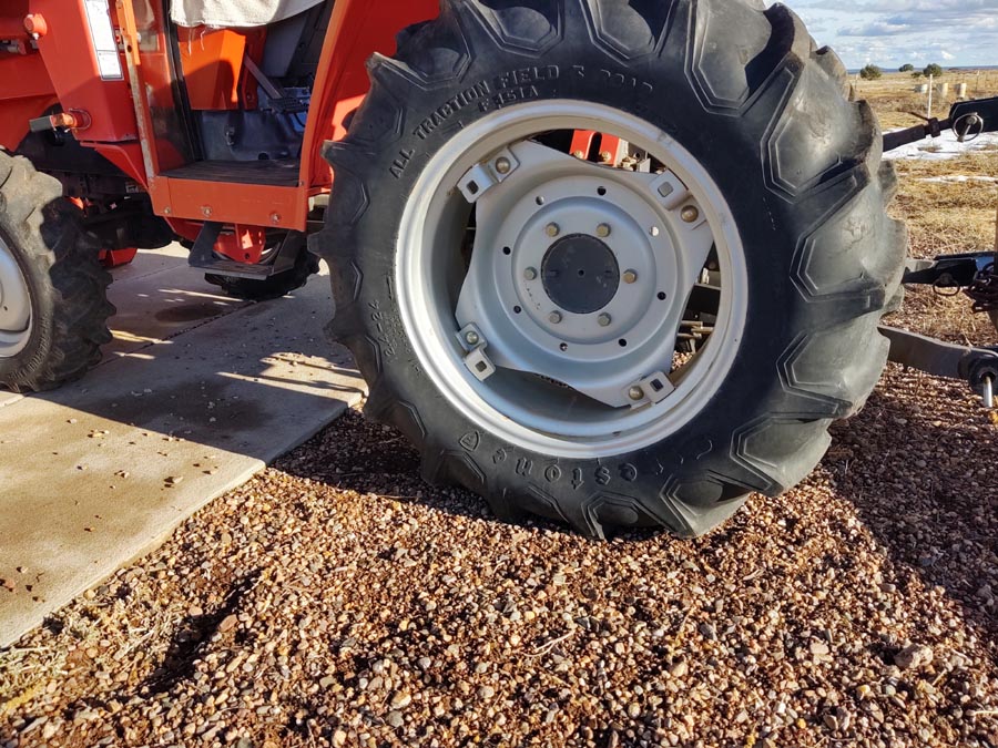

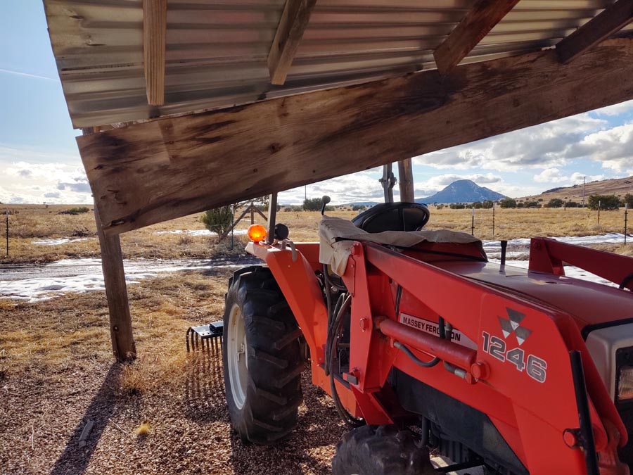

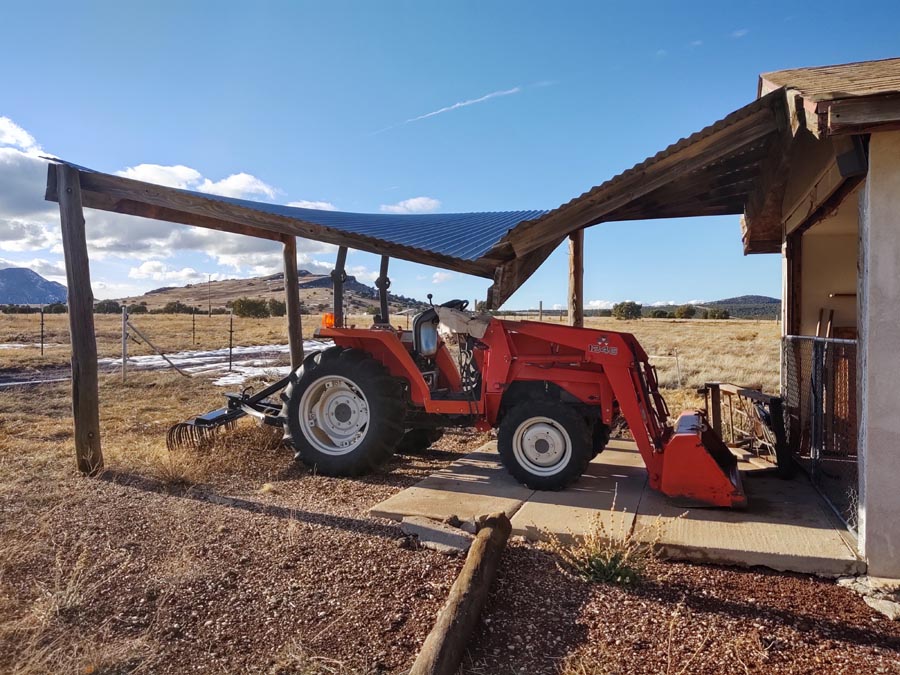

Thanks again for all the replies/help/suggestions. Some interesting reading for sure :)
Here are more pics since the snow is gone. They're before I backed out the tractor...taken as I was gaining courage to do so. Regarding the tires, both the ones on the left (they were bearing the weight of the roof) are low/flat. The ones on the right are fine. I've never had to adjust the pressure in either in Idaho or here.
The nearest tractor tire repair shop is nearly 75 miles away in Flagstaff. I have no way to get a huge-o tire into my truck :eek: There was an old guy who made house calls...this was 9 years ago...but he has since died.
Take a look at the pics. See how much the whole dang thing is ready to topple over :eek:

I still would pump them up as suggested. You have nothing to lose, and there's no way you can get that loaded rear tire without something to lift it.
Looking at that picture of your rear, I still concur with others that it's just lost a little air over time. That's to be expected, I had to put air in the front tires of my 4 year old tractor this summer.
