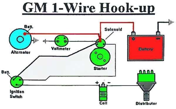

GM makes several sizes of the single wire alternator which has the built in regulator (bypassing your existing one). They are very popular and common on custom cars and street rods...and not that expensive.
You will have to fabricate the mount and spacing to align it to your crankshaft pulley. Not impossible if you're equipped to do so and as long as it's mounted to 'swing' for belt tension...your good to go with as many lights and accessories to match the alternators output.

Tis a good suggestion that Mark as offered. I'd stay with one of the smaller sized models, may be 40A, as in the upper power range this model was straining partially due to unadequate cooling. But even at 40A that's a lot of power for one of these little tractors.
Older son is just finishing up on installing one of the 12 series (3 wire & larger capacity) GM alts on his Toyota Land Crusier and other son is about to do same on his. Bracket was too difficult to fab and mount
Can't get much easier to connect than a 1 wire model. The down side to this model is at higher loads and with marginal wiring size, voltage at battery could be a little low.

Ernie (and Mickey),
I have a picture somewhere of the small GM 68 amp output alternator which listed for $79.00. It was supposed to be with this attachment:
The autor of the diagram strongly suggest an independent ground from the alternator case directly to the negative side of the battery. This will prevent diode blow out.
