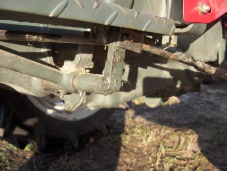

Here is a pic

   / YM 1700 PTO will not disengage #15
I think that's just the left brake linkage. It's welded solid to the rod that crosses over to the left brake pedal but the clutch pedal floats on this rod, doesn't rotate it. Not related to the pto.
#16
I think you are right. I really feel like a dummy. I can see you are correct . I don't know why I thought it was related to the PTO. NOw that I look at it that lever is for the left brake. The brakes work fine bu the way. Soundguy probably has the answer about a stuck shifter. I will try his suggestion this weekend.
Thanks guys for you help.
   / YM 1700 PTO will not disengage #17
If the link from the clutch is to disengage the pto gears when the clutch is depressed it might have dammaged the pto selector linkage. If the pto implement is pushing the tractor it is not possible to disengage the pto without damage to the pto selector due to the presure on the gears.
   / YM 1700 PTO will not disengage #18
Sure.. but as long as you clutch while in 'acceleration.. the tractor is driving th implement.. not the other way around..
Case solved anyway.. re: brake linkage. That's a good thing too.. as i thought the clutch lockup to the pto shifter was kind of a bad idea anyway..
Soundguy
