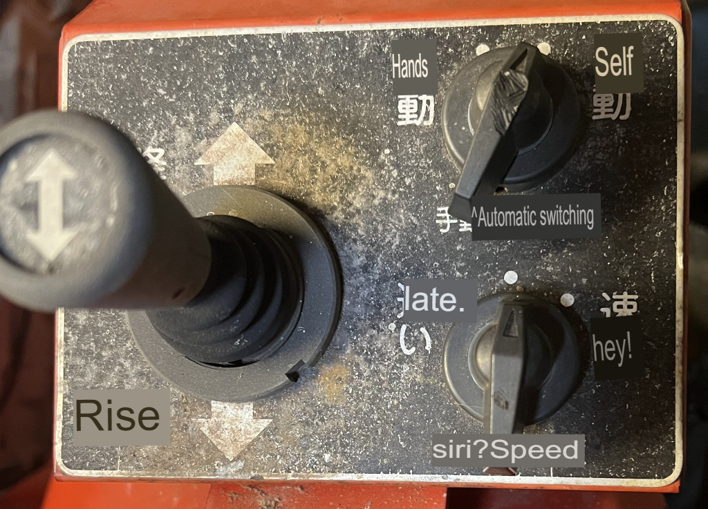

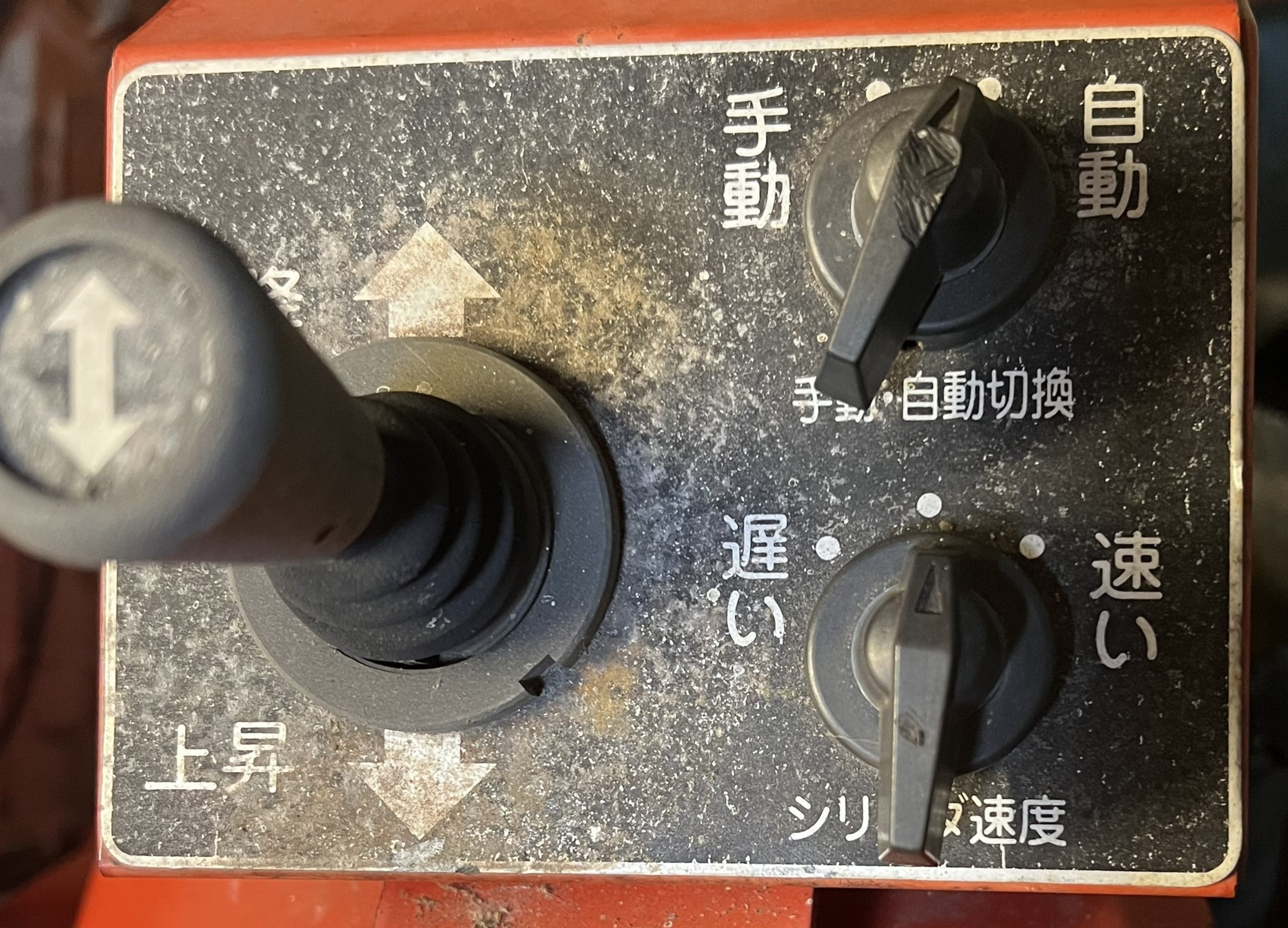

Your YM2310 has the UFO tied to the 3PT lift. Do you have these controls?
If yes, then you can make adjustments to slow the lift down.
The translation is too literal.
The big joystick knob to the left is RAISE and LOWER.
The top knob to the right sets the lift when pointed left to MANUAL mode.
The top knob to the right sets the lift when pointed right to AUTOMATIC (UFO)mode.
The lower knob to the right sets the SPEED of lift. I can only assume SLOW-MEDIUM-HIGH like the other Yanmars in the YM/F/FX Series with UFO settings.
