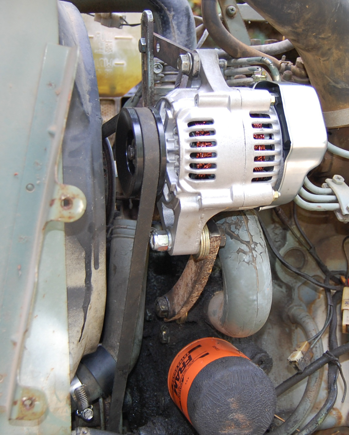

Ok, got it done. I'm real happy with the way it worked out. I have about 1/4" clearance between belt and the bottom radiator hose which I slid a "guard" over. Also the alternator is about 1/16" from the side cover without any mods to it.

Just wanted to followup on this. We have been planting pumpkins this weekend and ran the tractor quite a bit. Alternator working out great so far. Tractor cranking much quicker after this conversion. No telling how long the old setup has been dying. This is certainly a recommended upgrade.

Nice work. How did you wire it all up, since its now one wire.
I'm thinking about the same thing, my 226 has that same hose in the
way as yours did. Nice work around.

Wiring it up was the easy part. Since its a 1 wire alternator, all you have to do is wire the "1 wire" to the battery hot and your in business. I did nothing else to mine. I thought at first my alternator light would come on, but that hasn't been the case.
Its been 6 weeks since I did the conversion and all is well. We have planted a small pumpkin patch and also we have run the finish mower and bush hog probably 10 hrs or so. The one change I have made since that picture was with the small sleeve you can see on the lower hose. I swapped in a stainless sleeve for the black nylon one you can see in the photo for extra protection. The belt occasionally does kiss that area and the nylon was starting to cut. Now the stainless takes those little pecks with no problem.
I've been real happy with the little alternator. It's seems much more powerful than the previous generator type setup. Battery seems hotter all the time and the starter works first time every time since the conversion. Before it was a 50/50 whether or not it was gonna spin on first try.
