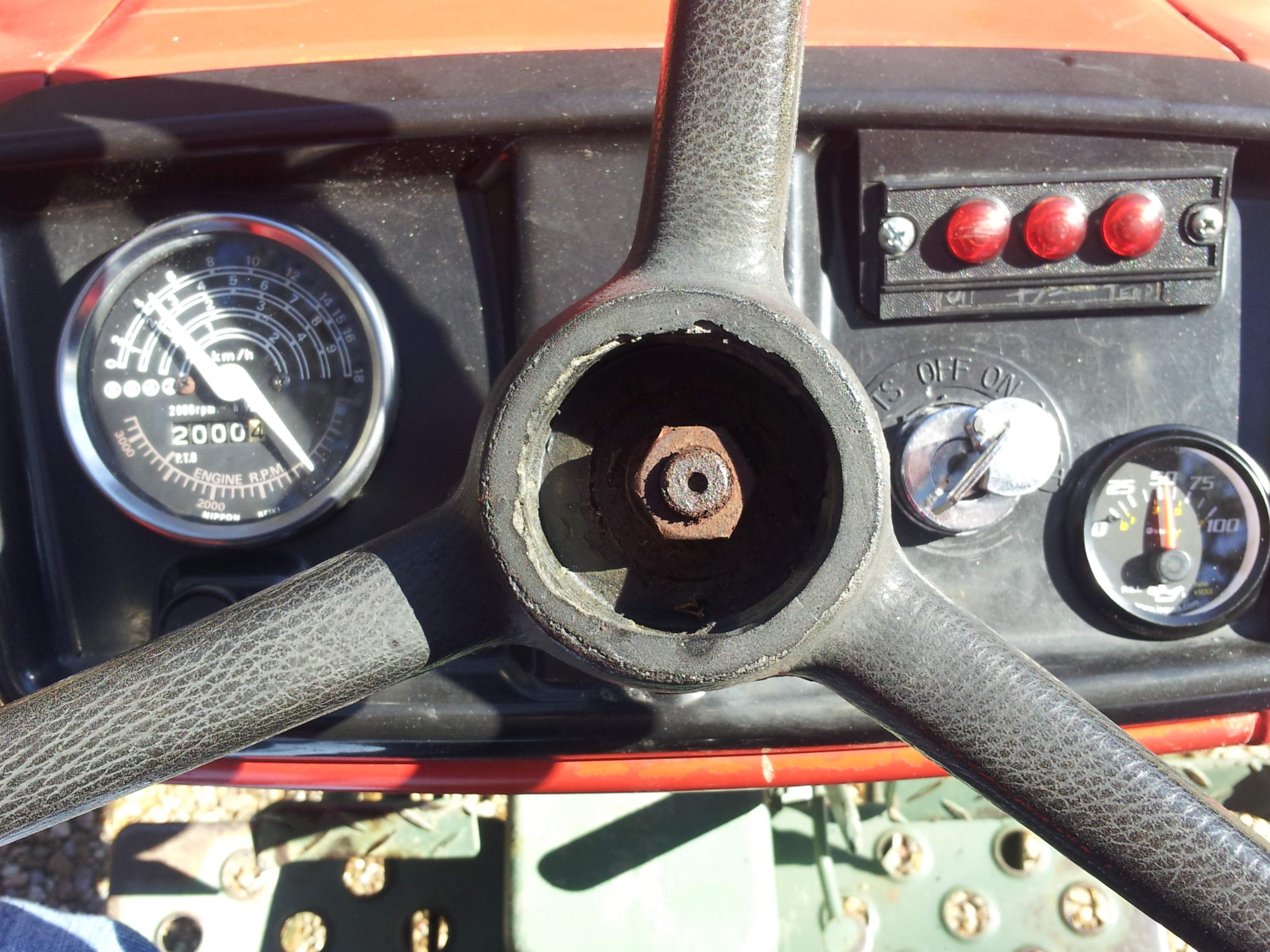

(-: Oil pressure is good (see 50 + PSI reading on dandy new pressure gauge). Must be the sender. Thanks for the help. On an unrelated topic, anybody know where I could find a cap/cover for the center of my steering wheel--before the nut rusts to the shaft?
