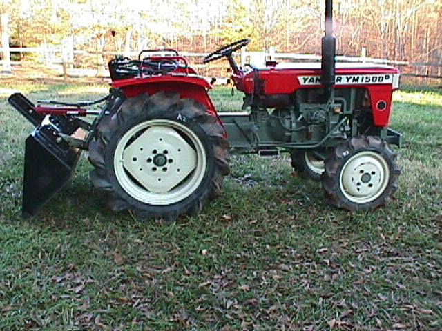

Thread with photos. Dealer-installed loader on a US Yanmar.
I've never read here of a Yanmar breaking in half at the bell housing but I've seen photos of other brands that did.
388519-dscn4220r-jpg.20688

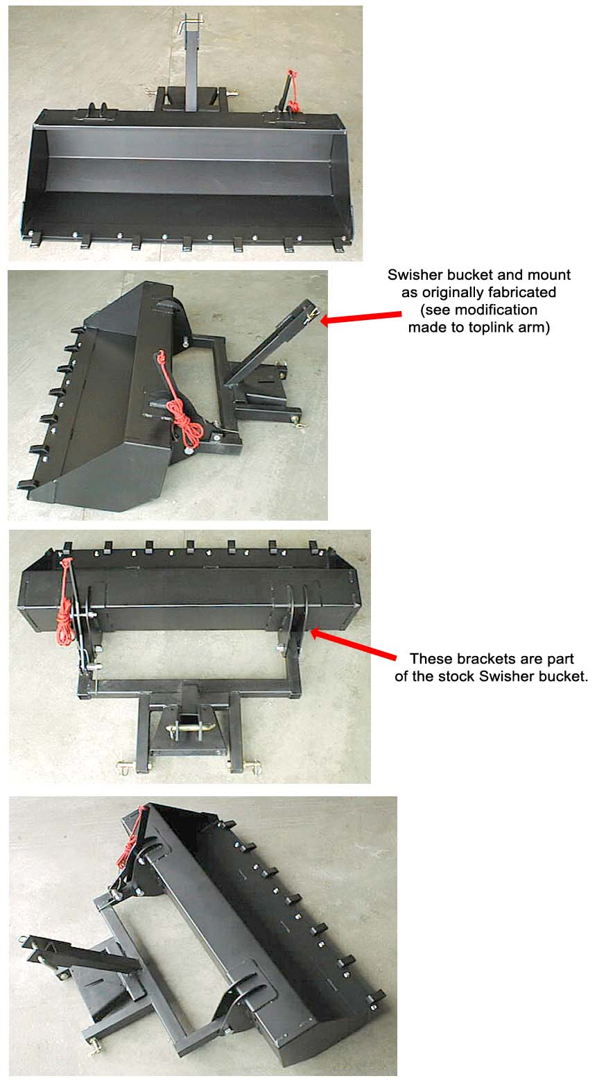

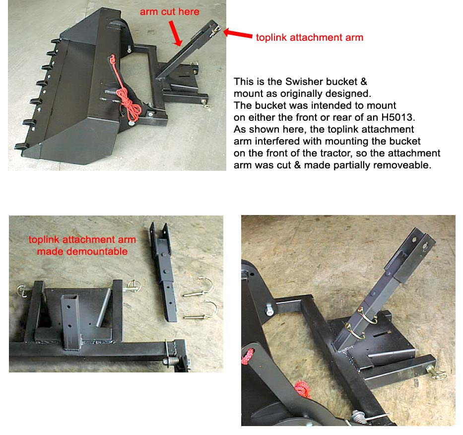

YES, I've looked it over several times.
Back around 2010, a REL would cost $700 with hydraulic controls for the top-link! The price has more than doubled since then.
The bucket is only $300. It's the Swisher ATV bucket with added 3PT brackets.
And can be adapted for front use too, just the lift isn't as high as a real FEL.
The last I looked Home Depot sells the Swisher bucket on special order. :)

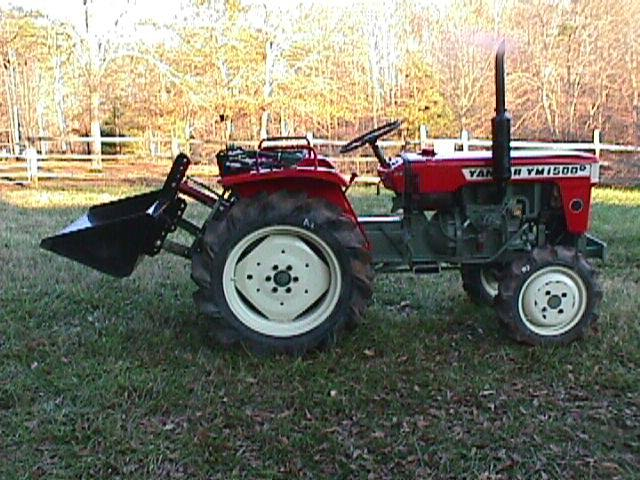

And with your pics, that loader is way out there lol
Counter weight Big Time😝
   / Ym loader install #9
The ones I looked at dis not have hydro like the ones on top.
And you didn't have a trip arm to dump...

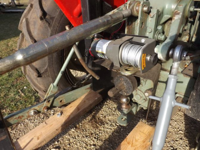

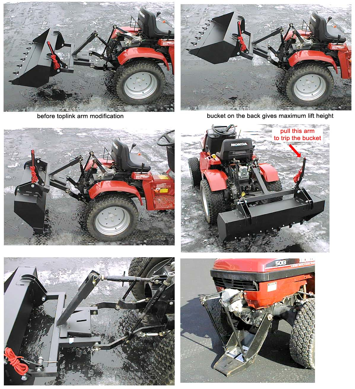

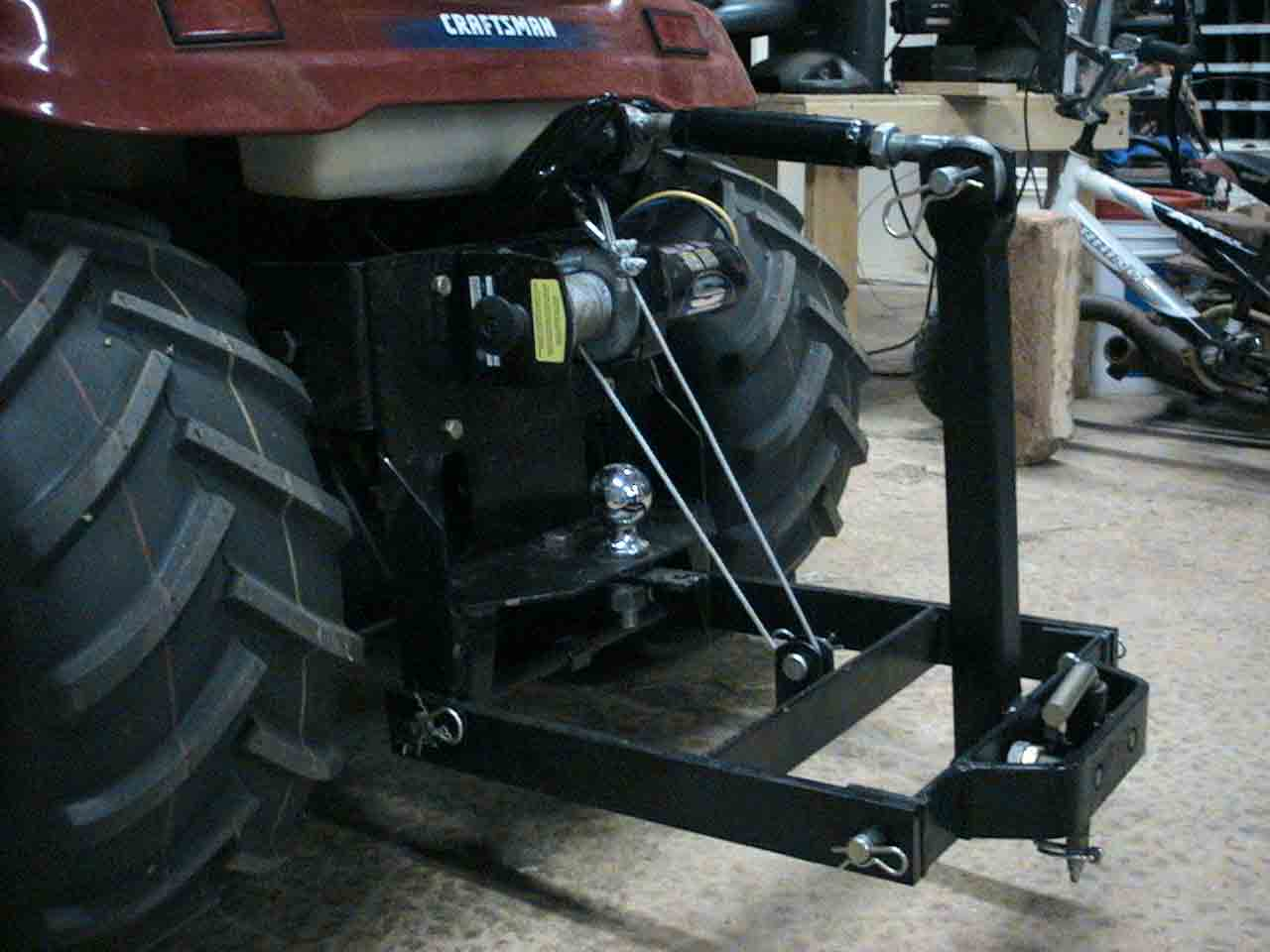

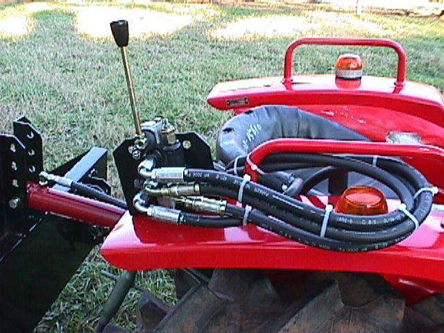

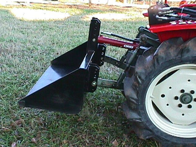

On the bigger tractor (1st one) the REL isn't too far out. The 1st one does have the top-link hydraulic dump controls.
If you don't go with a hydraulic top-link, an electric linear actuator would do the job too. Some are fully capable up to 4,000-lbs with infinite travel between end-stops. A double throw action switch to tap power to tilt or retract the bucket is all you would need. It would be a poorman's Yanmar UFO control of sorts.
The smaller lawn tractors can get by with the trip-lever action.
Now here's another IDEA.
Use the swisher bucket with the trip arm. Then buy the Harbor Freight 2,500-lbs tow winch. Place the cable at the bucket trip area. The winch has a remote control too. thus, the REL would be fully functional for way less than what anyone else sells today. :)
This is where mine sits on the back of the Yanmar.
