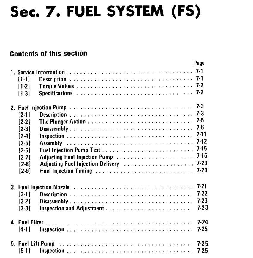

Jeff, I had noticed Yanmar made a 2T72LE genset engine back in the day. This service manual is in English as the engines were used in refer units on semi-trailers.
On the YTOG, look for,
YANMAR T-LE ENGINE SERVICE MANUAL 2T72HLE 2T75HLE 2T90LE 3T72HLE 3T75HLE 3T80LE 3T90LE.pdf

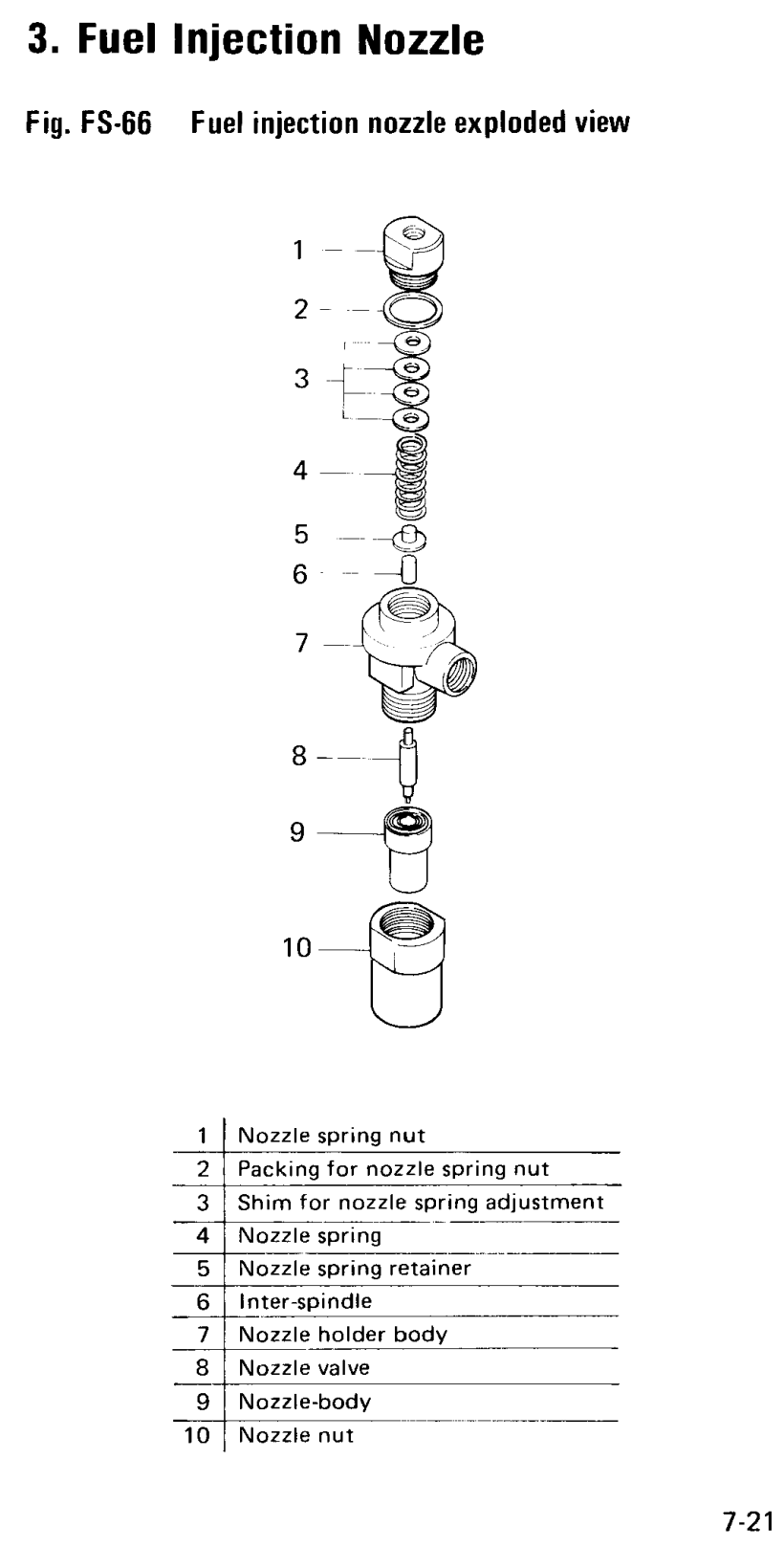

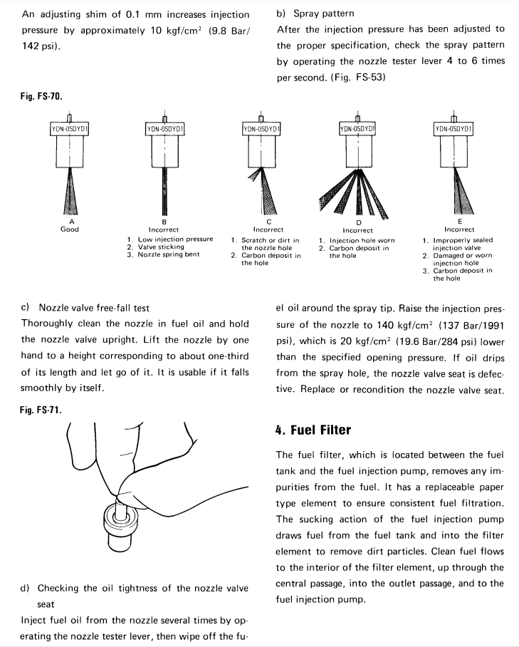

I'm showing "IN-2100" Injector Nozzel for the 1110
1 "IW-3854" Fuel Injector Valve Insulator. The first washer down from the Nozzel.
Then 2 "GW-4900" Chamber gasket washers. Dia. showing Between the Rear Inj. Chamber and the Inj. chamber front. 3 washers in all..

In regards to the washer needs for the injector, it's now clear to me that there's a dark gray washer between the injector and engine head.
