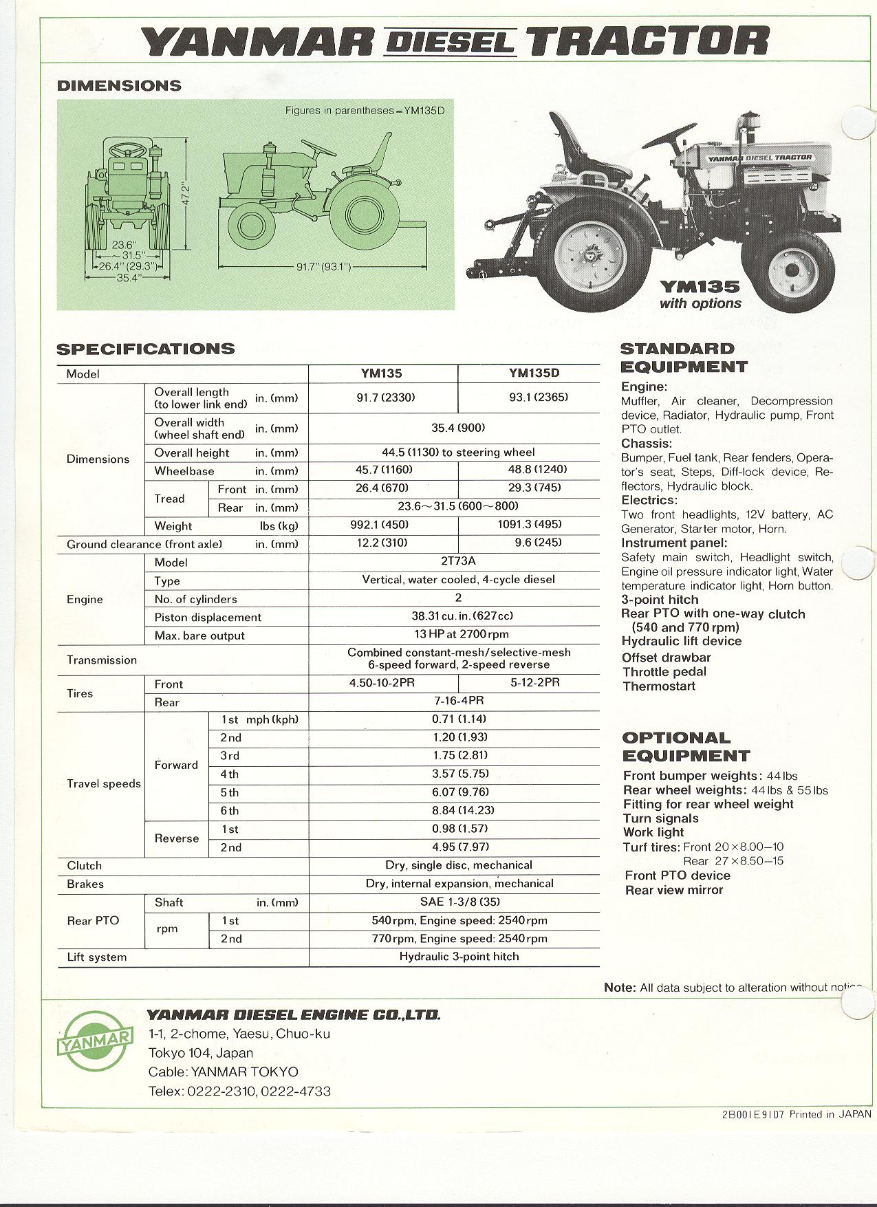

   / YM1110D Won't Charge #28
Just curious about your 1110D. Hoyes shows "YM1110 - very limited chance of getting parts - very rare model - no sharing". Wondering what 2 cylinder engine is in the 1110D?
I wouldn't worry too much about parts. That 1110D was very similar to the YM135D which sold quite a few in the USA at the time. Also, the same engine was used in marine shops all over the world and still is common.
Here is some info that you will find interesting, and a workshop manual that is applicable to these small tractors.
rScotty
