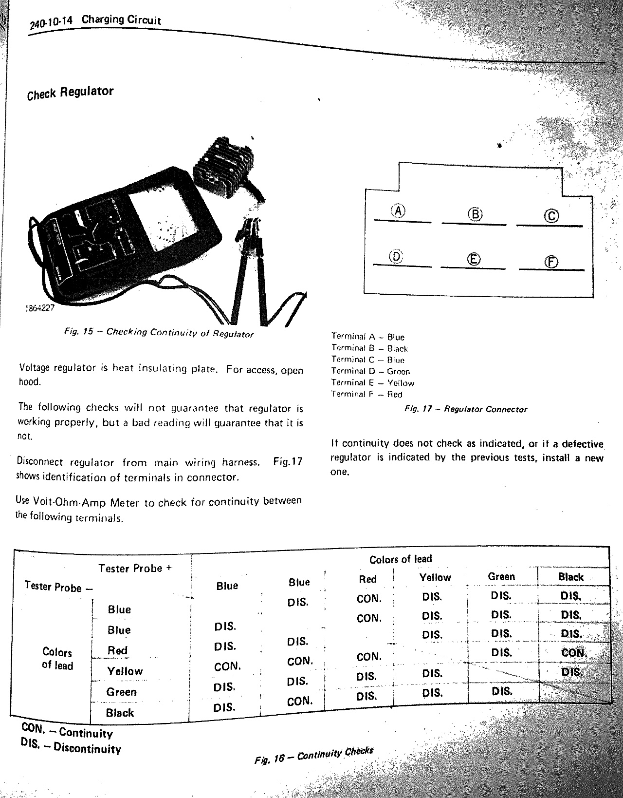

Followup - the YM186 Shop Manual has a chart of continuity/no connection between all the terminals on the regulator.
The regulator failed that test so I went to Gmiller's recent post and searched Ebay on all three numbers he shows for the regulator.

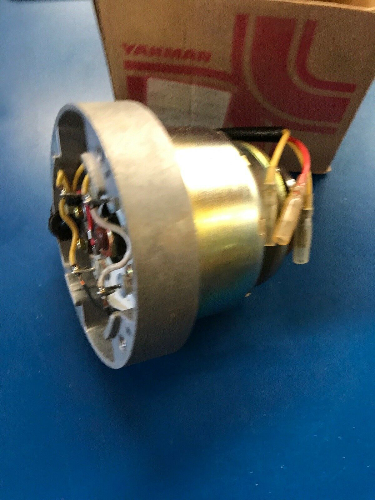

Investigating a little farther - that YM1110 thread discussed the early alternator that has the diodes inside, controlled by an external 'Current Limiter' that sends a signal back to disengage some of the alternator windings when the battery is charged.
I just looked at the YM135/YM155 Service Manual that bmaverick posted on 11/30.
It has a through discussion of that internal-diode alternator.
I then looked at my slightly more recent (1980) YM186(D) Service Manual. It confirms that YM186 uses the later alternator that looks the same but doesn't contain diodes. The diodes are over in the firewall voltage regulator. This external regulator is the one that is often on Ebay for $20 and up.
This is good engineering on Yanmar's part. Replacing a $20 regulator is less than the $90 and up asked for a replacement alternator after the diodes - the weakest part in the charging system - fail.
Here's the troubleshooting page from YM186D Service Manual. No voltages are shown, just a go/no go chart for testing the regulator. Note the Probe +, Probe -. That's likely significant on a good regulator.

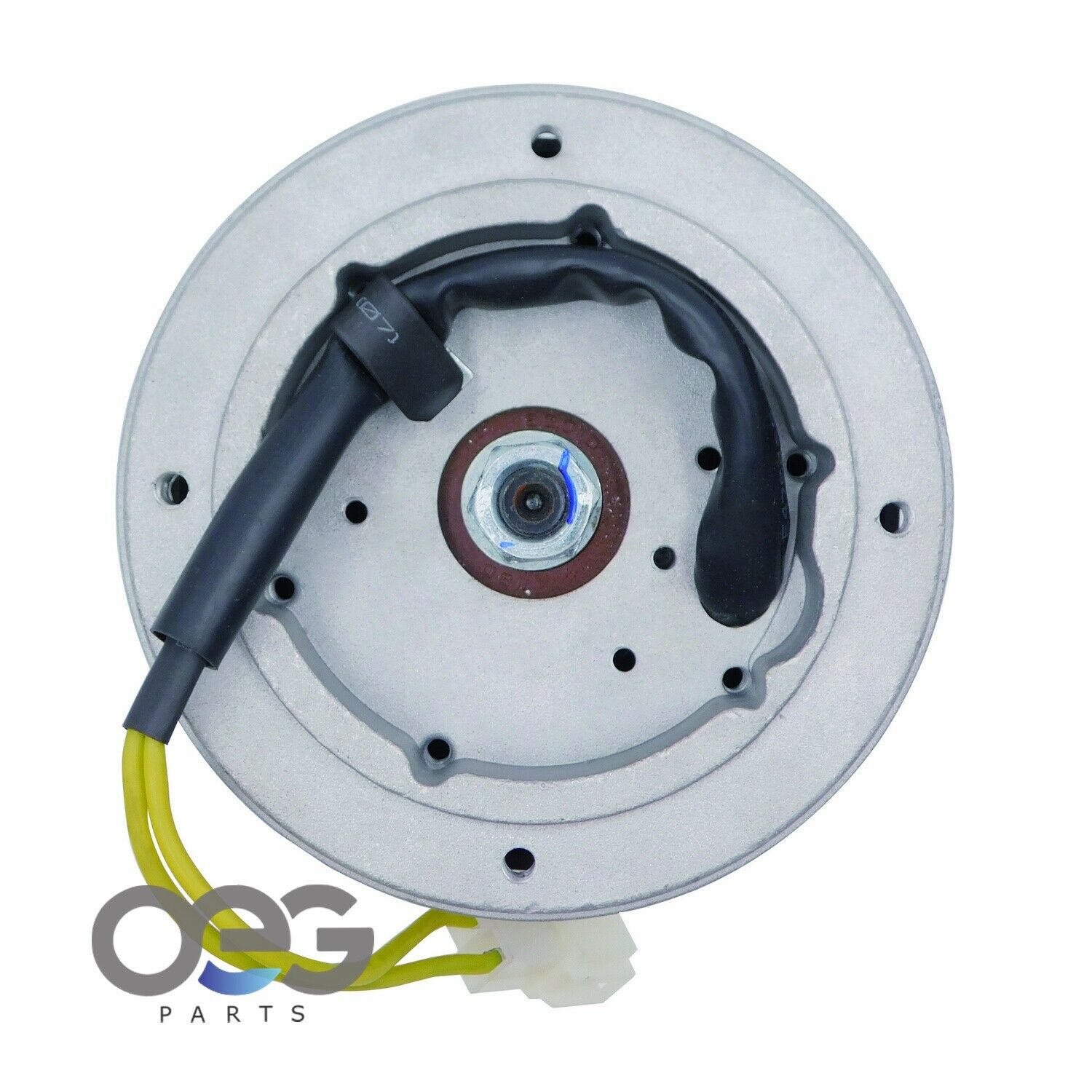

How to determine whether or not your YM135 alternator has internal diodes (3-wire regulator "current limiter"), or has external diodes (4-wire regulator, or can be converted to 6-wire regulator):
Option 1: Inspect the back of the alternator. If you see two semi-circle plates full of connections and components ("soldered stuff"), your alternator has internal diodes.
If the back of your alternator is bare aluminum with just two wires protruding, your alternator has external diodes.
Option 2: Use a multimeter to test for the presence of diodes in your alternator.
* Grab a digital multimeter with a diode testing function (the $7 one at Harbor Freight can do this)
* Disconnect the alternator leads from your tractor's wiring harness
* Connect the red lead of the multimeter to one lead of the alternator - then, connect the other multimeter lead to the other alternator lead
* Does the multimeter read zero, or some non-zero number?
* Swap the leads (red to black, black to red)
* If the multimeter reads zero in one direction, but non-zero in the other direction - your alternator has internal diodes
* If the multimeter reads non-zero in both directions, your alternator has external diodes
* If the multimeter reads zero in both directions, either your diodes are bad or your alternator winding is bad
If you have an internal diode alternator that you want to use with an external diode regulator (4-wire or 6-wire setup), you can perform surgery on your alternator. Unscrew the diode plates from the back of the alternator. There should be two wires coming out of the alternator housing to the diode plates. There should be two leads coming from the diode plates to connect to the tractor's wiring harness. Simply bypass the diode plates - cut the diode plates out, and connect the leads to the tractor directly to the wires from the alternator.
