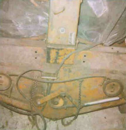

One of the dealers has a used Woods 348 which was the original equipment belly mower for the YM169/YM169D. The YM169 is the closest US Yanmar match to your YM1401. He wants $500 for the deck, but it is missing the electric clutch. It is a rear discharge as well. I was going to purchase it, but I don't think it will work on the YM1110D I wanted to put it on. Its just too big. I attached a photo.
Here is the dealer's information if you are interested.
