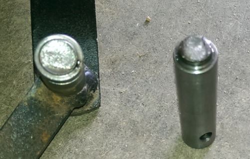

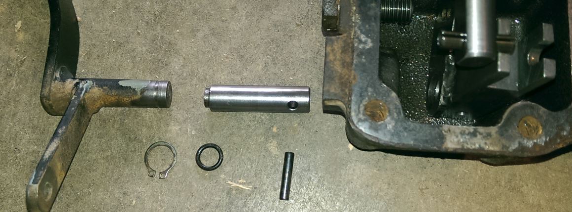

I pulled the 47-1 assembly and removed the valve from it. The control arm axle is connected to a linkage block and secured with a drift pin complete with safety wire. How to tap the pin out is the current challenge. There is no room to get a tool in there to tap it out, picture attached. Ideas welcome ...
added another view with valve assembly still present
   / YM1510D 3pt control lever broke... seeking repair advice for lesson #2 #5
Looking at the second picture would there be enough sticking out to get hold of it with vice grips to twist and turn it out? Second silly idea is to use a short home made punch and prying tool to push it through working from the left side of picture #1.
Looks like two grooves in the shaft. One for a snap ring, the other for an o-ring.
   / YM1510D 3pt control lever broke... seeking repair advice for lesson #2 #6
..Or something similar to ViseGrips with compound leverage to push the pin, a little at a time?
Yanmar sometimes uses a small rollpin inside a larger one. I don't see one in Winston's diagram, but I would still check for this.

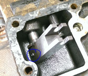

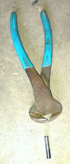

I was able to pull the pin using an end cutter with minimal damage to the pin, it "buffed out". 3pt_control_shaft_6.JPG
Challenge now it to find or fab a new one.

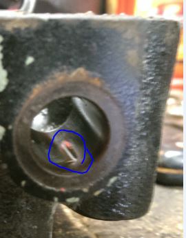

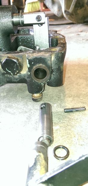

Guessing item #4 (liner) is still in the housing?
#9
yes, there appears to be a pressed in bushing that is the full width of the casting. The highlighted artifact is a reflection, not real.
