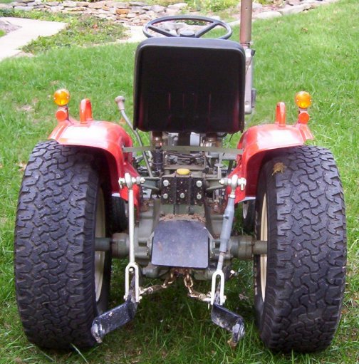

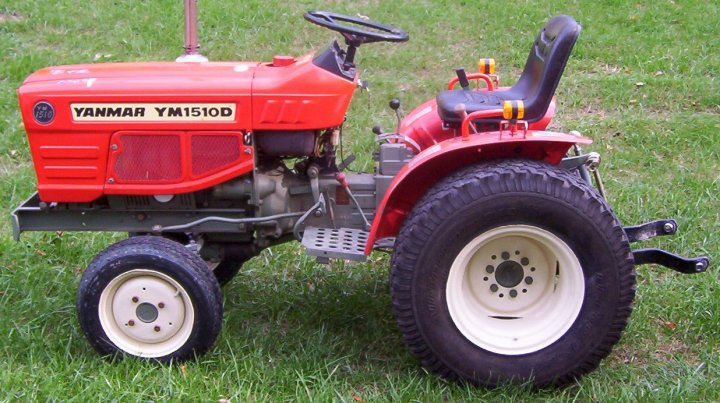

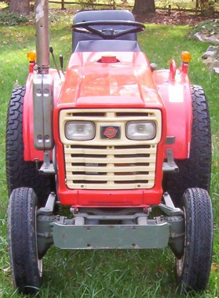

I thought some folks might be interested in my inexpensive turf tires. I installed 4.80-12 trailer tires ($18 each) on the front wheels, and 285/75R16 truck tires ($25 used pair) on modified rear wheels (drilled new bolt pattern). All the diameters are the same as the original tires, and I still have the rear rice tires for snowy days. Pictures attached.

Rear View...

Front view...

Why did you need to drill the rear wheels? They look the same as ours. Did I mis-understand?

Nice job! How are the tire and wheel sizes in relation to the 4WD? Or do you not use it with that turf setup?

The John Deere bolt circle on the wheels was too large, so I had to drill a smaller diameter circle for the lug bolts.
   / YM1510D Custom Turf Tires
The tire diameters are same as the original rice paddy tires. I drove in 4WD on pavement, and there does not seem to be any wind up in the drivetrain. I also laid down some rubber accidently. I shifted the powershift a little too quick, and the rear wheels actually chirped before they grabbed on the cement. I might need to bolt the seat down a little tighter with all that traction. /forums/images/graemlins/grin.gif

Then what you've got is a set John Deere rims (on the rear) with 285/75R16 tires on them(?).
