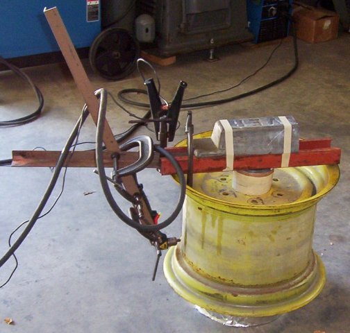

ChuckT - They are John Deere wheels that I also had to reduce the width. I rigged up a plasma cutter jig for that process. Picture attached. In hindsight, I would have bought a set of steel Chevy truck wheels for $35 a piece. I think they just need the lug nut holes slightly elongated and the pilot hole enlarged.

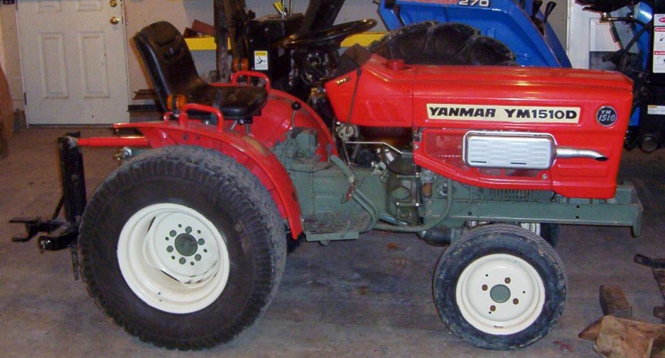

Nice! Is that exhaust standard or did you extend it? I have a YM186 an often find myself wishing that my exhaust stack was taller.
   / YM1510D Custom Turf Tires
#15
It was standard for the YM1510, but I have since reduced the size to prevent hitting tree branches. FYI: Based on previous experience, if anyone modifies their muffler this way, make sure you point the exhaust away from the tractor and not straight forward. It will quickly clog your air filter.
