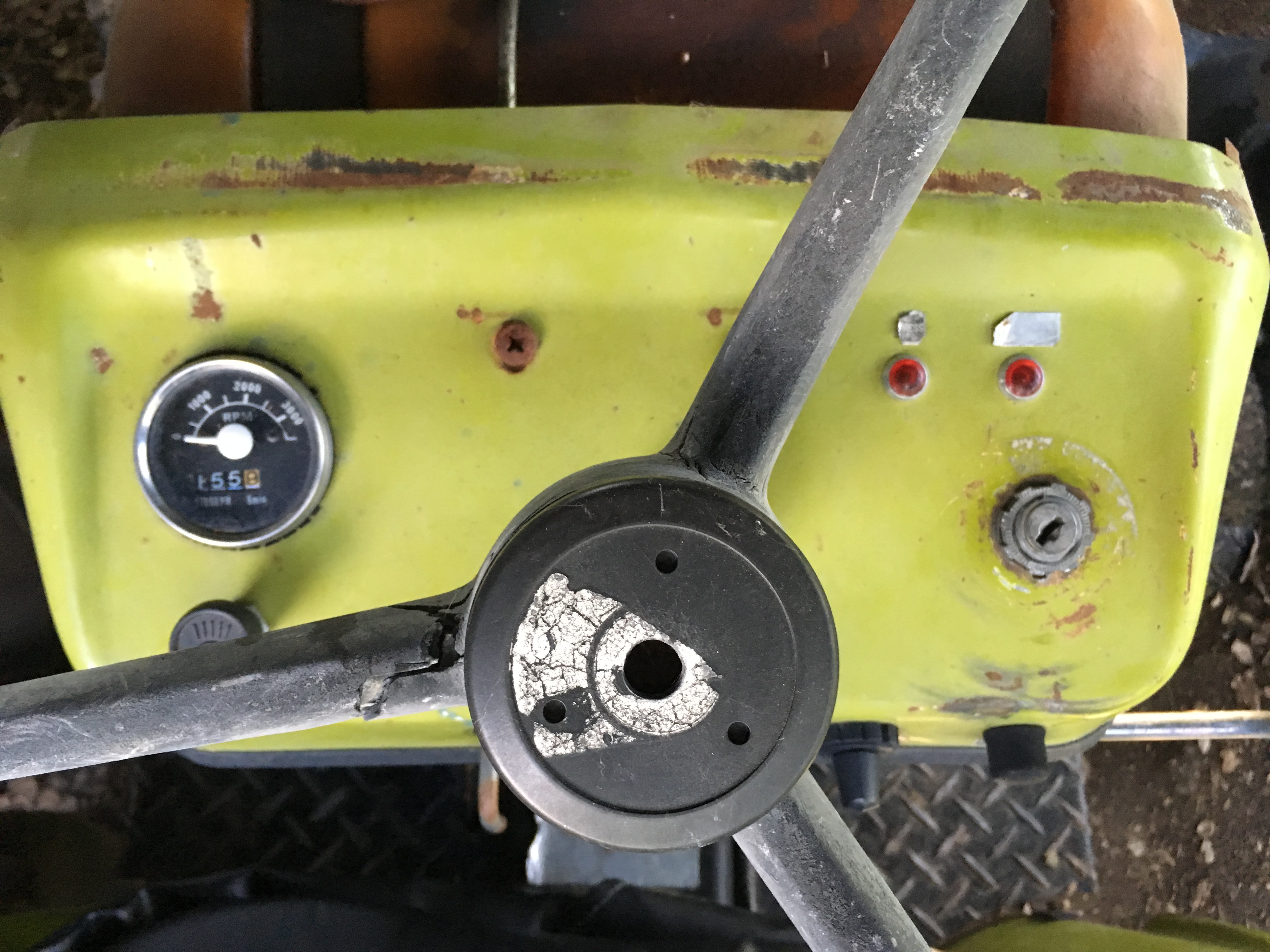

I think my lights may have been reversed? (The manual says the left light it temp and the right is oil pressure. But then it says that the oil light comes on with the ignition, and on my tractor the left light comes on. So the right side light is likely temp and I don't know if it's connected.)
Is your indicator light panel like this?
(Photo from my initial setup/minor renovation of the YM240 in 2003. The lights on the right were dangling at my knee. :eek:)
Test the temp light bulb and its electrical circuit: Turn the ignition key to On. At the temp sender, slide the connector partly off the sender and slip a grounding wire in, to ground the wire that goes to the dashboard. The dash light should come on.

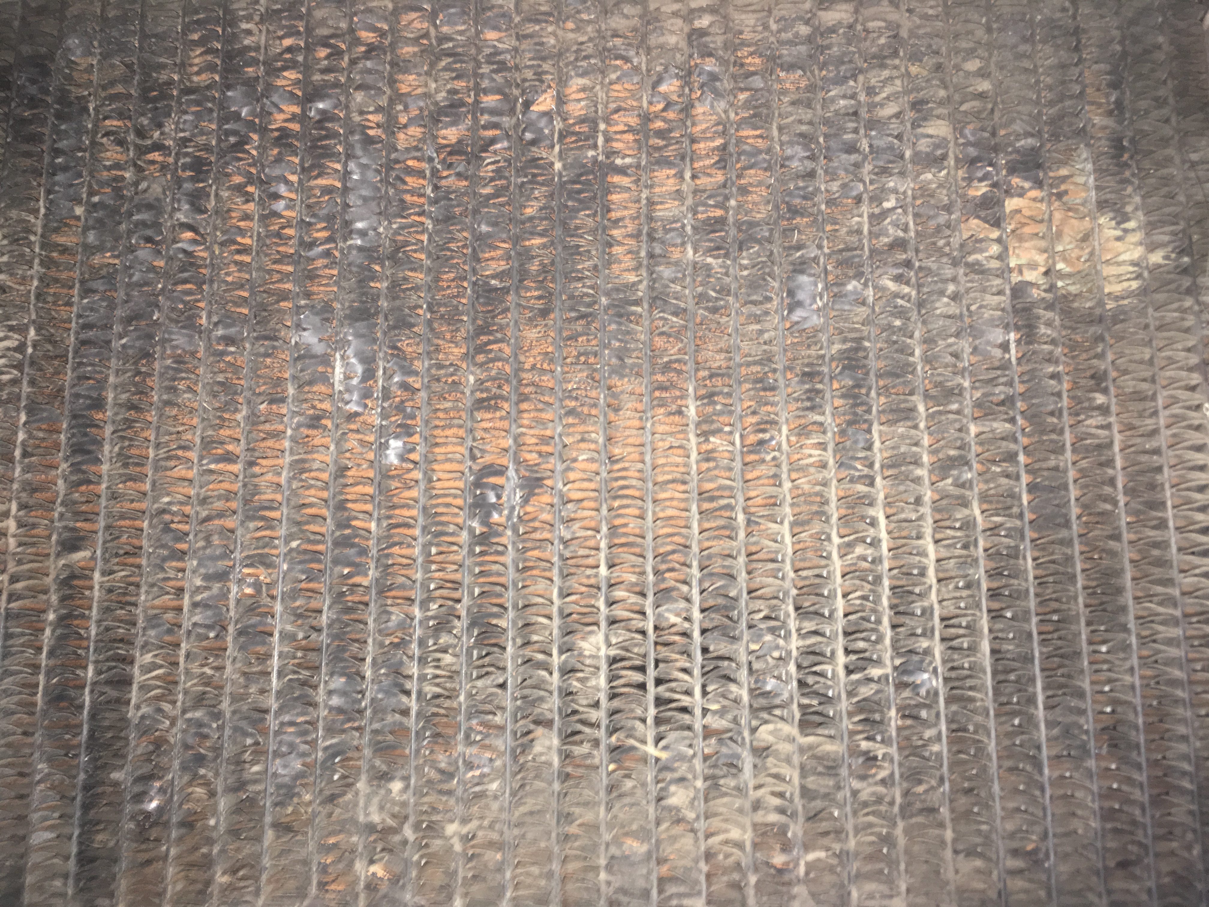

Alright, good news, mowed for an hour and a half last night with no overheating issues or radiator venting! Looks like it just needed to be blown out real good. Still excited to receive the temp gauge, will help put my mind at ease and let me enjoy my seat time. Rad cap probably an unnecessary desperation purchase but it's only $5:thumbsup:
The fins were clogged with what must be straight up red dirt, like it came in as mud and then caked.IMG_0712.JPG
California, here's my light setup. Figure it's less important to fix if there's a temp gauge there instead.

I suggest get the warning light working properly, test it occasionally, trust Yanmar's designers, and just get on with using the tractor.
At most buy a new temperature sender if you don't trust the old one (test it on a stove in boiling special fluid). With the new radiator cap, you would sense overheating (heat, smell) long before you approach boilover temperature. The light will come on before boilover.
I started off with the same experience as you, a plugged radiator exterior causing heating. And like you, cleaning the fins solved the problem. I've never seen the temp light since (except when testing it) nor felt that the engine was running excessively hot, on three Yanmars I own/owned. The temp gauge I bought immediately in 2003 is still in its box.
