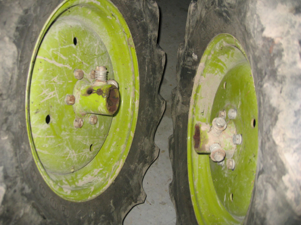

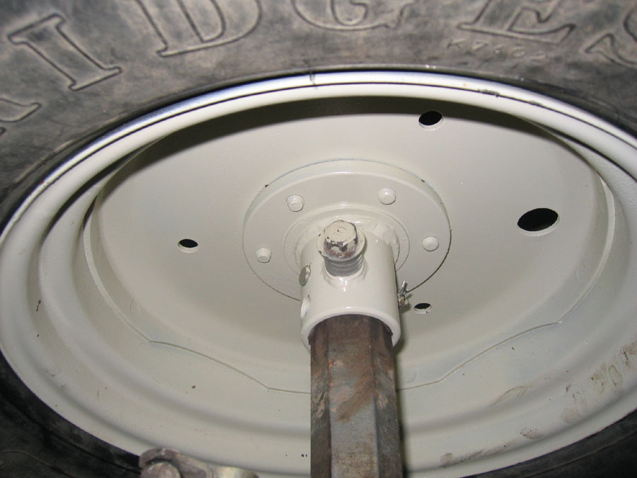

No need to apologize. You should be able to tighten up the bolts with the springs on them to take out the slop. I recently bought a set of rims for turf tires and oddly enough, they have just one set of "set screws". This results in a little bit of play, but I don't notice it while under way. In the other picture (green rims) there are two "set screws" and those don't have any play on the hexagonal shaft when tightened.

You will want to ensure the axle play is eliminated. This is a commonly ignored item and will result in wear to both the hubs and the axle. Good observation.
