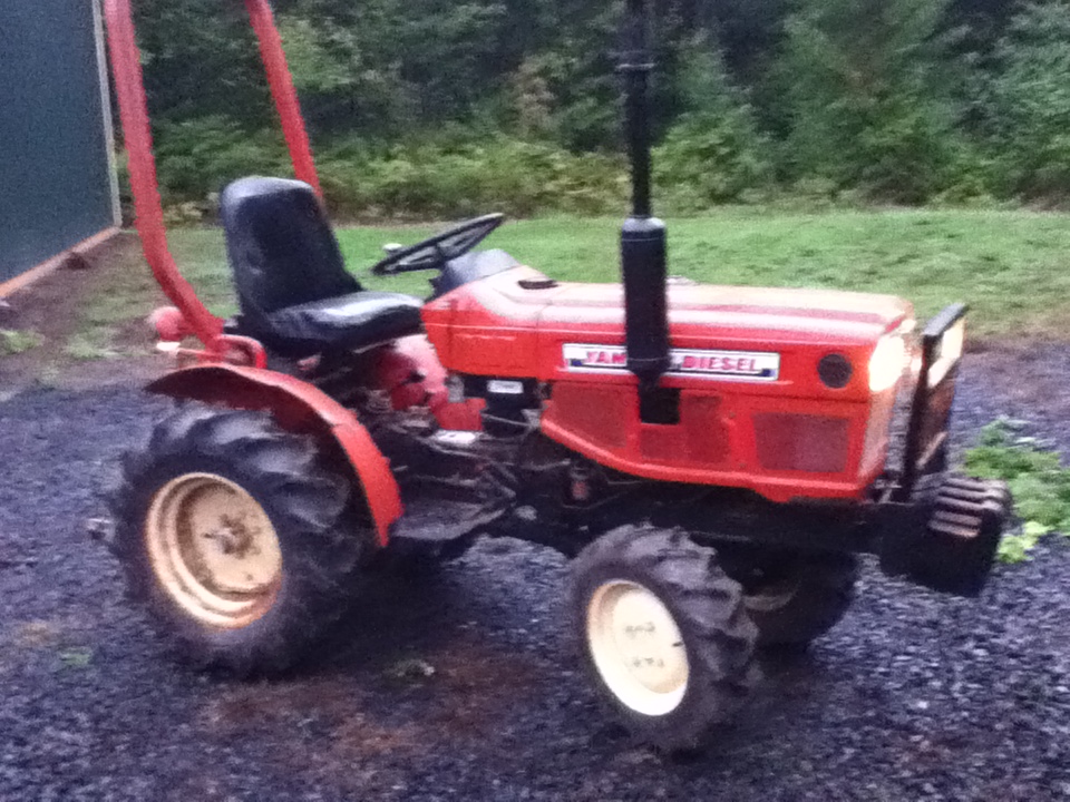

Now I am am doing some general clearing of various "piles" and in moving some "things' to the back corner of the property I stumbled (I continually stumble onto new things as he keeps bringing stuff) onto a Yanmar RS1200 tiller that looks to be in pretty good shape - will this implement attach to the 1600 as is or will it require some mods. (I have a full machine shop and am a competent welder.)
There are 3 other tractors back there also. 1 is a Farmall 100 but I can't tell what the other 2 are. Is it permissible to post photos and ask for ID help and whether they are worth trying to return to service?

Sounds like a fun place to me. :laughing::D The tiller should already fit the Yanmar, in fact I bet it came with that tractor when he bought it. The last question, well lets just say people around here LOVE it when you post pictures of tractors. :D:laughing::cool:;) I will even post a picture of the old Yanmar YM169D I used to have, it was the best first tractor i could have asked for. :thumbsup:

As John said, that tiller matches your YM1600.
One point that may not be obvious: Most 3-point implements you might use (mower etc) use a standard top link, but Yanmar's tillers use a special short top link that goes half way forward to meet a temporary 'bridge' attached where the front end of a normal top link attaches. You might look around (or ask FIL) to be sure you have both types. That special tiller top link is hard to replace.
And again as John said - we love photos. I don't think anyone minds if you start in this forum. Title a new thread something like "What model tractor is this?" and the whole site will pour in here with well intentioned advice - probably including invitations to come post more photos in the Farmall forum etc.
