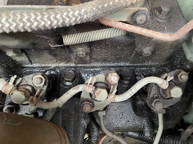

Hi everyone. Looking for some advice on how to cure a black soot problem from the exhaust of my Yanmar 1610. I've owned this tractor for 8 years and it's always blown the black liquid from the exhaust but seems it's time to try and resolve the issue. The bonnet is covered black.
Any advice would be very much appreciated.

Take a picture of the tractor making this soot and post. I changed my fuel filter yesterday and put on a new water separator screen. Both plastic filter housings were filled with black gunk.

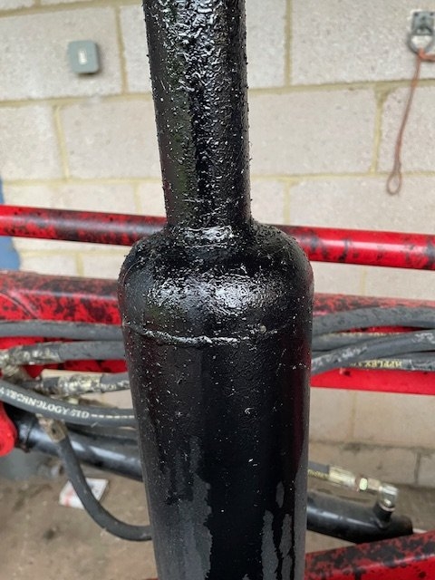

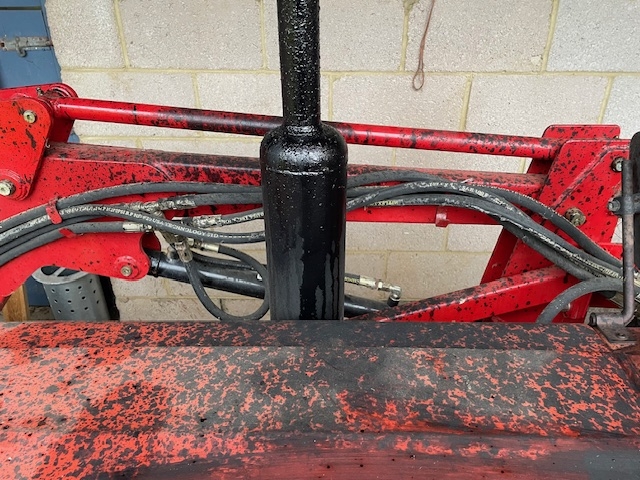

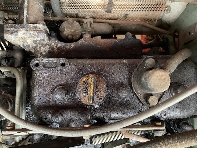

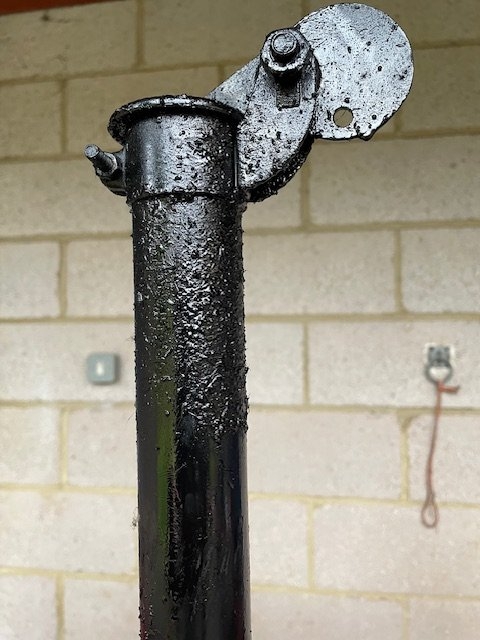

#9
A few pics to show the extent of the problem.

   / YM1610 Black Soot #10
Reads and looks like "wet stacking".
link
If it's that basically your not using it hard enough.

   / YM1610 Black Soot #11
Won't hurt that to clean it that's for sure. May have to do it a couple times. When I turned my Cap/Lid around just be careful it's will be easy to catch a low hanging limb etc.. Now mine stays back turned around like normal no oil bombs Etc.. While you have it off look inside the exhaust manifold for excess oil and carbon and clean it. Mine was nowhere near that bad Cardon in the manifold that looked dry and normal. My guess it's going to make a big difference

   / YM1610 Black Soot #14
From the look of your exhaust you are running cold ,doing litle jobs and not getting hot enough to clear the exhaust. To fix it you need a job of a couple hours or more to rated pto revs under a good load (brush hogging, cultivating) to get some real heat in the exhaust to clean it out.
I used to get this problem in my MF135 when it only had light work and cold running. Harrowing a paddock after the cattle had eaten it out (commercial farm) would fix the problem.

   / YM1610 Black Soot
#16
Thanks everyone for the advice. I removed the exhaust, gave it a good clean with petrol, changed all filters and running at a higher RPM, problem seems to have been solved :). If the problem returns, I'll try turning the exhaust 90 degrees.
