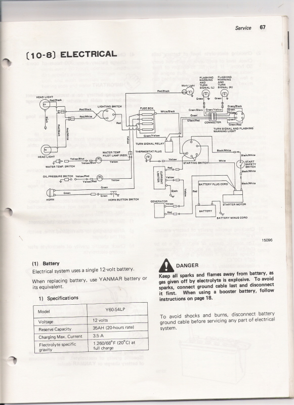

I have a YM165D. I just got a new starter and it won't engage. If someone has a wiring diagram so I can check voltage to the starter I would appreciate it. Thanks Dan
   / YM165D Wiring Diagram Needed #2
Here is a copy of the electrical out of my book. If you cannot read this pm me your email and I will send it to you .

Thank you I will test the connections tonight. Could be my Clutch sensor not activating. Maybe I will just wire direct to test.

Do you have the service manual? My other tractor a YM146 has a trouble shooting guide in the service manual. It shows ohms and voltages for the wiring ect. So you can track down where the trouble is coming from. I could have a relay or a voltage regulator that is bad. Thanks Dan

Got the starter to work tonight. It was the flywheel housing. It was too rusty along with the mounting bolts for the starter. I sanded the area down and it fired up. Now a new problem no oil pressure and I can't get the dipstick out of the rear transmission case.
   / YM165D Wiring Diagram Needed #7
I checked my manual and I do not have the section you need. Sorry I am glad you figured out your problem. I to had an oil psi problem mine ended up being the regulator behind the filter as long as I took it apart and cleaned it I got psi. I ended up flushing the motor and so far no more problem. Good luck
