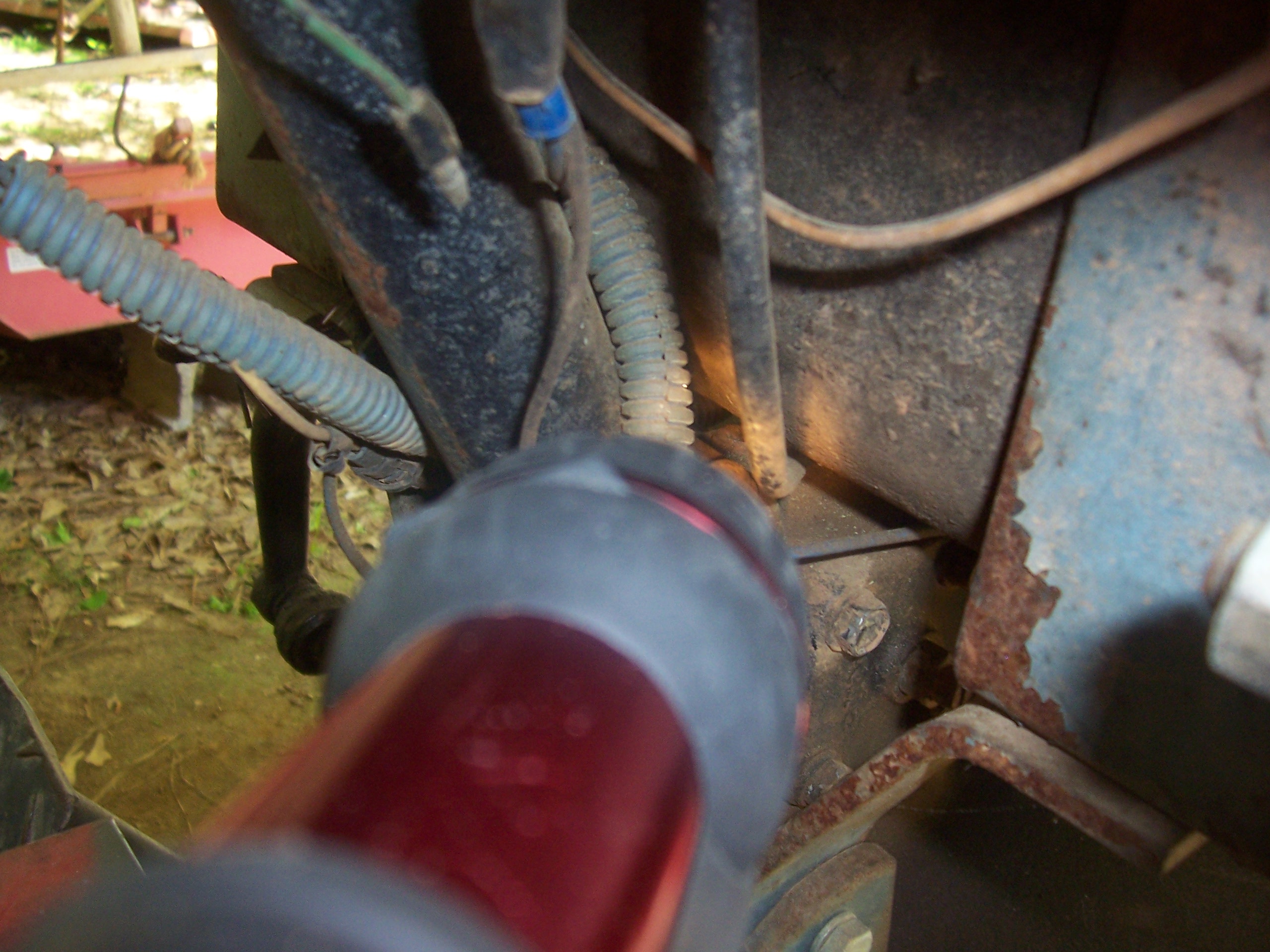

My plan was to remove it so that I could get oil in it and make that there is no water in it. Is there a way to do that another way? I was looking at the parts diagram and there appears to be a plug on the top of the box. I may be able to get to it by removing the fuel tank.
The plug is on the steering shaft. Look on the fuel tank side under the steering wheel. It's just a rubber plug.

Ok I found the plug it has a wire coming out of it attached to nothing. Tomorrow I will get some gear oil and see if I can put some in it and see what happens. 8w90 oil the correct one?
   / YM1700 Hard Steering #25
An Elec. wire.? That's weird. A ground to something apparently. If it's even the correct plug not seeing it and someone has been in the steering. Put a flexible hose on a 2$ Cooking baster then you can add a cleaner to it. Or if you just want to add gear oil that way for now and see what happens. Any 90W gear oil should be fine. And then with the baster if it does come loose you can suck the dirty oil out and fill it again. Won't hurt to do it a few times.

They all have that wire! Doesn't show on the Dia. But that's something I would leave alone. If you want to add oil through it then have at it :laughing: Were my flash light is pointing I'm on the R. hand side your see the allen wrench plug. I'm sure you have it. That's the Grn. wire it's not a California spec...LOL..
