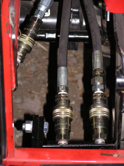

</font><font color="blue" class="small">( Mickey,
Good idea, but it does require some hardware and some additional plumbing. Sometimes it isn't so easy to find a good "tank" location to dump the bypass either. )</font>
Here's food for thought.
Plumb in the pressure regulated by-pass so it reestablishes the original flow path, i.e. by-pass the FEL plumbing. Another way is to plumb in the pressure regulated by-pass to the down stream side is tapped in to the same flow path as the lowe pressure return line on the FEL.
On my rig the FEL line are up up tight and outa sight so little if any chance to get caught on anything. Both hi-pressure lines are secured to the mount on the FEL via the flange both hoses pass through. I've got my QD plumbed in at this point. No loose ends.
   / YM1700 hydraulic problem #17
I posted about this same problem in the Chinese forum. We had pumps coming in all the time (and still do) because customers would unplug the disconnects while the tractor was running. We put a pressure bypass at the pump just like soundguy mentioned with a hose that would spray oil if the lines came apart. The problem is that the pumps working pressure was way lower that the shock pressure during loader work. In other words if your front tire dropped in a hole with dirt in the bucket the pressure relief would spray fluid everywhere. To stop that we had to crank up the pressure bypass so high that the pump would blow up anyway.
Next we routed the bypass line around the loader valve. Still had blown pumps coming in. The disconnects would come undone and the owners would just keep driving around, or worse yet would unplug them to take their loaders off and forget to hook them back together. The pumps on these smaller tractors cant run at 90% load for very long. Heat builds up and the pumps die. They are not built like pumps on large machinery and cant handle any abuse.
The final thing we did was to eliminate the disconnects in the main flow and hard mount the valve to the tractor. then put disconnects on the working ports of the loader valve. When you take the loader off the valve stays. It is more expensive to do it that way, $100.00 or so (2 sets of extra disconnects, more hose ends and fittings and bracket building and mounting) and I offer it to everyone that buys a tractor. To date I have not had one person willing to pay the extra $100.00 :)
I have only seen 2 tractors that had disconnects come apart by accident. The rest are operators thinking about fishing instead of tractoring. Funny thing though I have never sold a $400 replacement pump twice to the same person.
Buck
