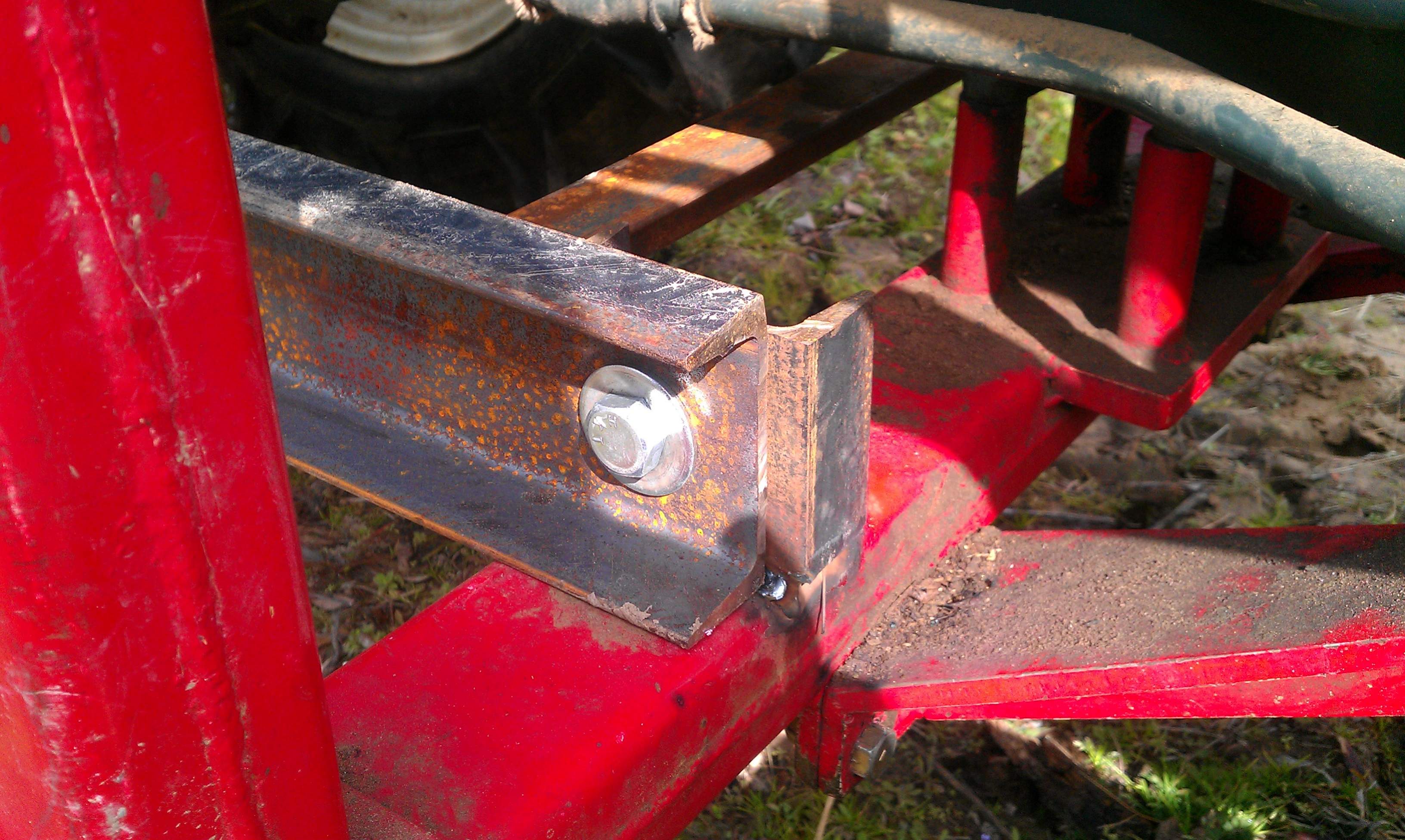

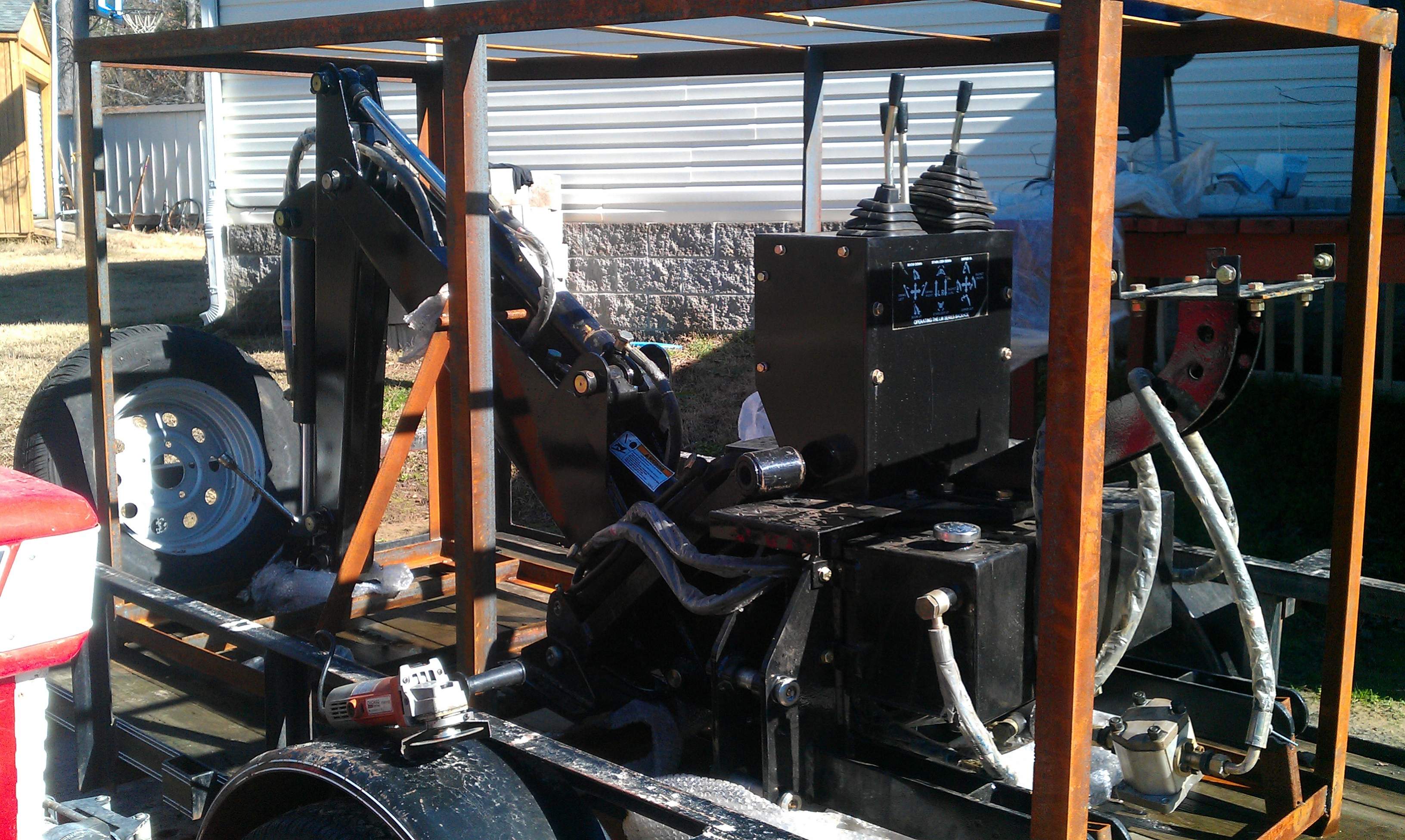

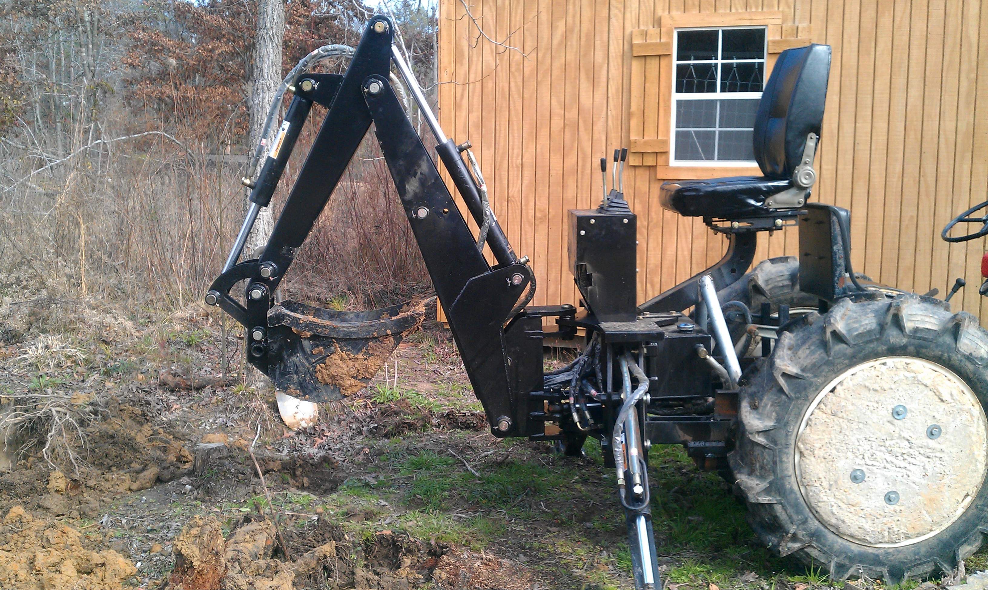

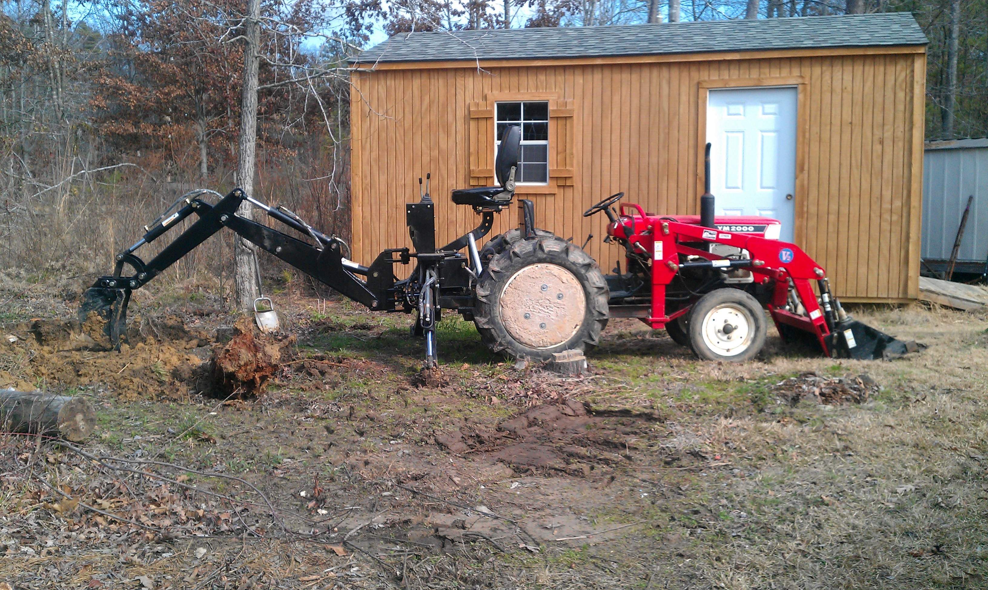

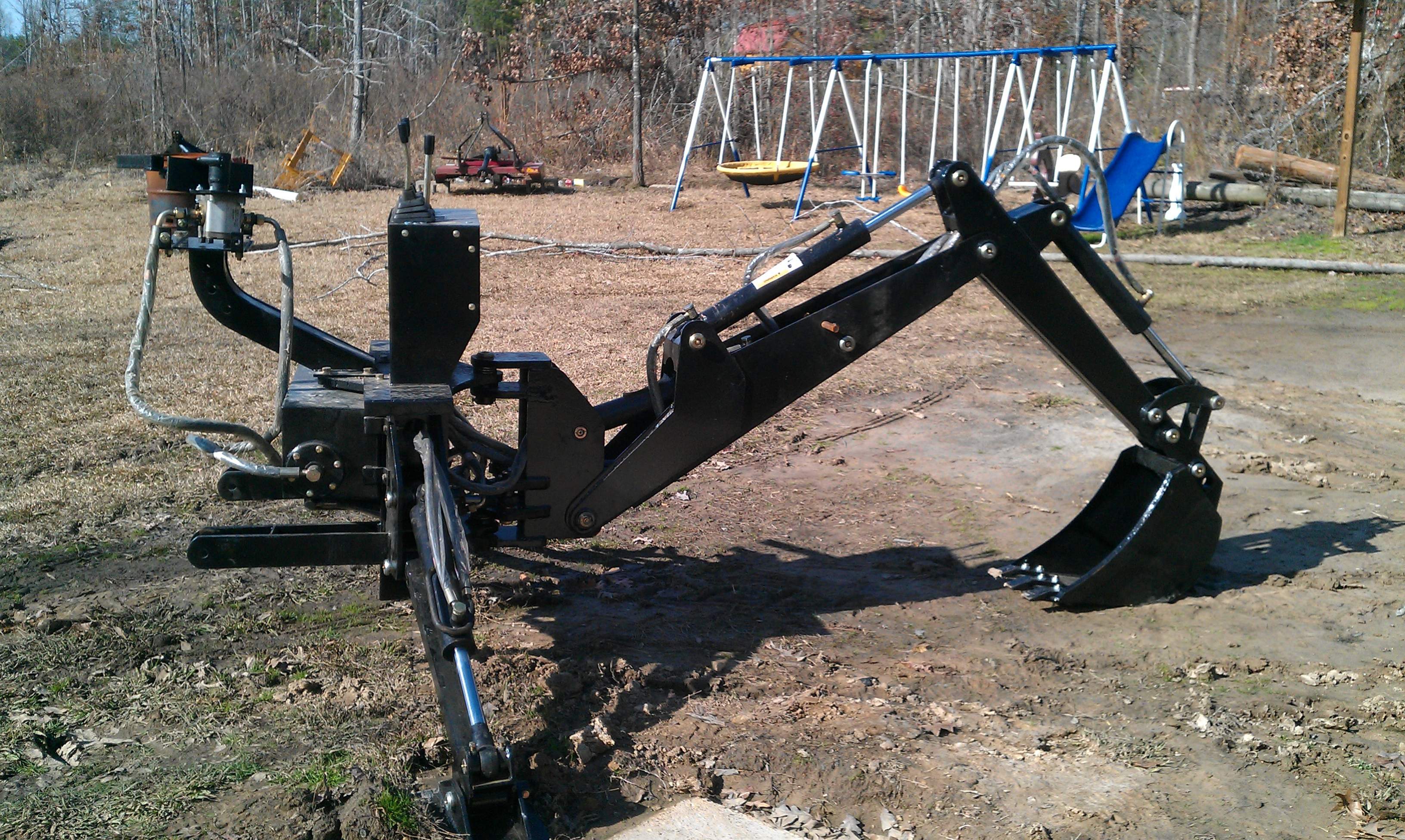

I spent 4 days, working off and on, building a sub-frame to mount the backhoe to tractor. This is a heavy backhoe. One of the reasons it took so long is that I have a (15 months old today) grand son that demanded I spend time with him every time I went inside. I didn't mind. You grandpas and paw paws know what I am talking about. Another is that I have never built anything like this before and was taking my time, being careful, measuring 4 times, thinking to much about what I was fixing to do, then cutting once and re-thinking to much again, welding, second guessing, adding another pass with the welder etc...

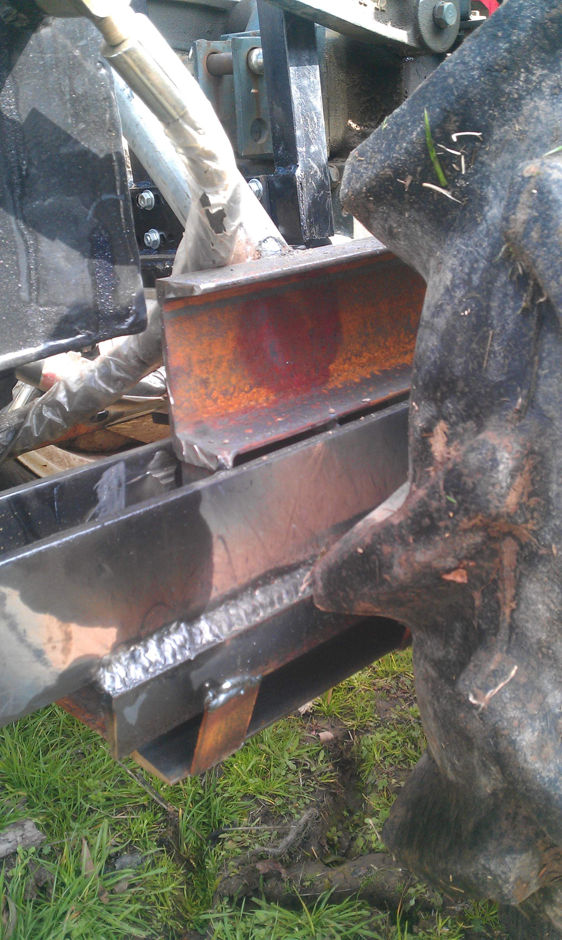

I used about 20 feet of 4 inch channel for the main body of the sub-frame with a few little pieces of scrap steel I had laying around to reinforce it. Also used a couple of sections of 2 inch pipe to weld the upper part (where the top link goes) to the subframe. I was concerned about the structural integrity of the sub-frame, due to my welder, so it is built like a tank. After using it today to dig up 3 stumps, I am no longer worried if it will hold up. It is an amazingly stout design that comes off the tractor by removing 4 bolts. I took the fenders off temporarily to make it easier to do all this and will remount them later.
Thanks go to dfkrug, a member of this forum. Without his excellent and informative post in the "build it yourself forum" this project would never have been attempted. Here is the link to the post.http://www.tractorbynet.com/forums/build-yourself/171760-how-build-your-own-custom.html

Thanks for sharing. I'm thinking I see the pump in the first picture. Does that have a bracket or something to hook to your pto? Your an ingenius fellow, I remember your wheel weight thread.
/ Ym2000 meets LW6 backhoe
Good morning winston1,
The pump bracket assembly and pto to pump shaft coupler was included with the backhoe. Once assembled the bracket fits between the lifting arms of the 3 point hitch, no bolts to mess with. Thanks for looking.

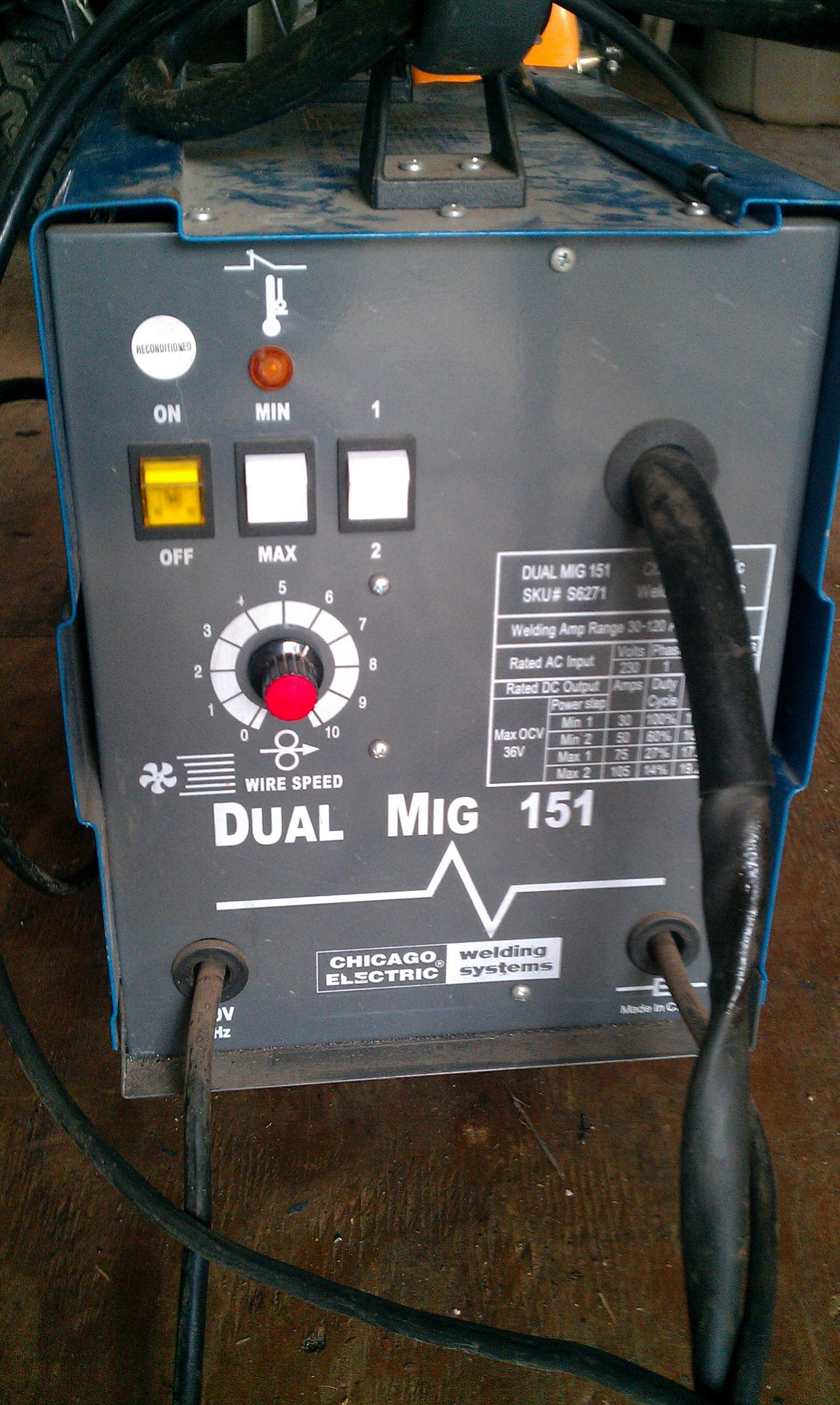

... 2nd, this entire project was put together with a $179.00 harbor freight (bought 3 years ago) dual mig/gasless 220 volt/105 amp wire welder. Take that however you want. I have not had a single problem with this welder ...

Captain, I have a bunch of questions. :)
How does that [Jinma] LW6 hoe work on that tractor? Does it dig ok, drag the tractor all around, operate smoothly and without breaking down? Does it seem too heavy to drive around with? What's its practical, productive depth?

I keep looking at HF's current version of your welder, now model 180. What do you think about these, are they worth ~ $260 when they go on sale? Did you use FC or gas for that project?

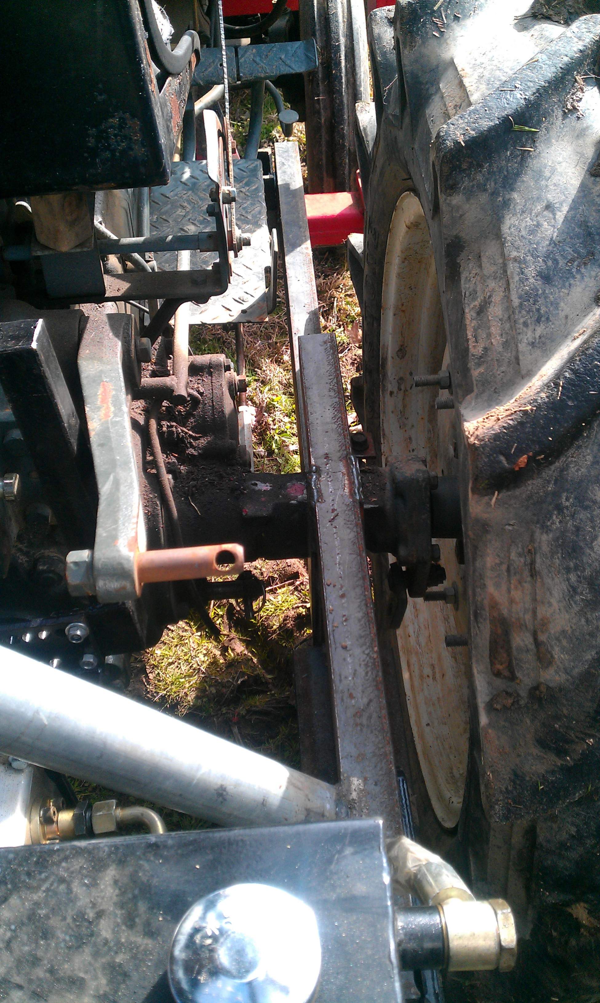

Captain, good looking mount, every bit as strong as the mount on a my jd970 for the #8backhoe. One concern though. I notice you have attached to the cross brace on your rear FEL mount. This mount is bolted to the bell housing with 4 bolts. Having had a bad experience on my YM 3000, ( sold it last year ) you might want to extend the brace to the frame mounts on either side of the engine. Reason is, the bell housing is used for the frame on these, and where your front mount is just puts more of a load on what could be the weak joint between the bell housing and the motor block. Behind the flywheel there are 8 or so 12mm bolts holding the flywheel to the bell housing. When changing my clutch I found 4 or so broken with the bolt heads half ground off by the back side of the flywheel rotating. Biggest load I ever had on that tractor was a 5' brush hog. My JD950 ran a 5' flail mower for most of it's life and had the brace added between the bell housing and the engine block long ago for that same problem. On this forum there have been other posts relating to this problem, I for one, have had this problem as well. That backhoe is going to produce much more stress at that joint. If you extended the front of the frame to either side of the engine block you would remove the load from that joint. If you were to tie into the bolt pattern that attaches either side of the block to the frame of the tractor with a little longer bolts, much of the stress would be taken from that joint. If you had room to use more of that 4" channel, it couldn't get stronger. Nice fab work, hope it works out in the long run.

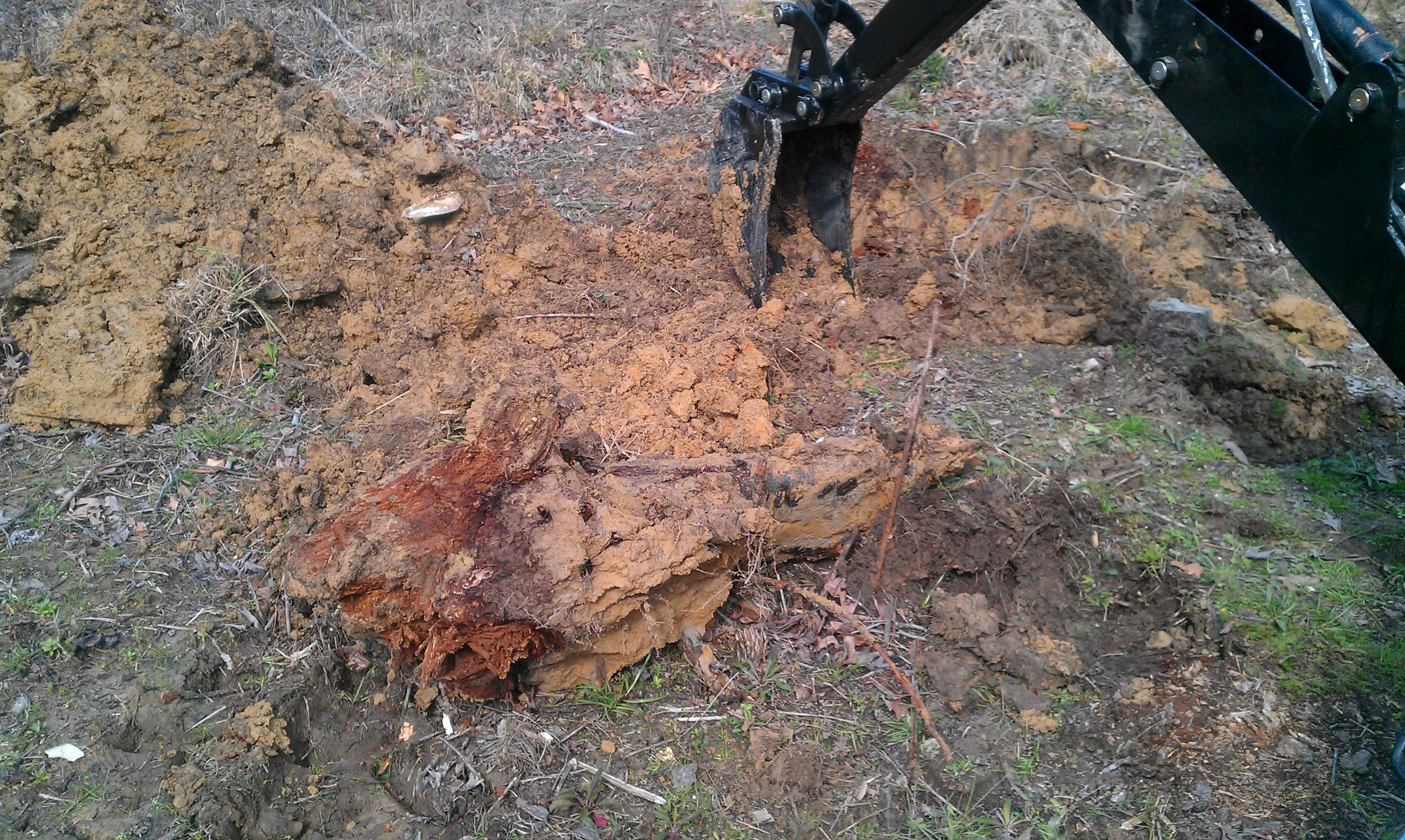

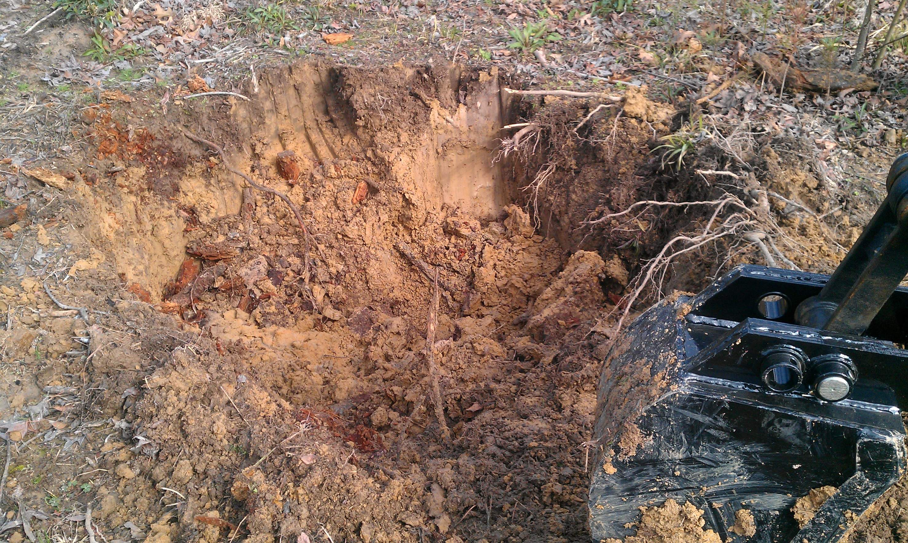

1. It works and digs fine and I enjoy the stick time.
2. It is a very strong backhoe and can drag the tractor around with no problem while operating.
3. If you try to work fast the controls are jerky. A more methodical and controlled approach will smooth it out. I did break the band poles that connect the ram to the bucket while trying to pry out a stump and another time bent a ram trying to do the same thing. Power is not an issue for mine. All major breakages have been the fault of the operator and not the equipment. It did eventually blow a cylinder seal and I was unable to find seals for it and had to buy a different cylinder to mount. I bought 2 in case/for when it happens again. These have seals I can replace if necessary. 100 bucks a piece on Ebay.
4. It is heavy. I put it as close to the 3 pt. as I could get it to try to balance the weight but it is light on the front end. Not dangerously so, but it feels like it has power steering when it is attached. Steers real easy.
5. Digs a little more than 5 feet deep.
6. No. I kept the fenders off. It was easier for me. I could fabricate some brackets....

8. The welder I bought was a refurbished model and was around 179.00 or so. VERY HAPPY WITH IT!! It is still performing great and I used it to fix my front axle in a post several months ago when it buckled while bush hogging the back property. Your experience may vary but i could not be more satisfied with the performance with this welder. I used flux core .035 for this job.

1. The loader is a VTEK that was purchased in Mesquite, Texas at VN Tractors. That's all I really know about it. It has been a good loader as I have not exactly been kind to it.
2. While the subframe is on the tractor the 3 pt holds the hydraulic pump in place. When it is off the tractor the 3 pt. works normally.
Chris
Hey Chris,
Thank you very much for that information man. I will check into this when I get off the boat in mid April. I have been pretty hard on the equipment so I will give a good visual inspection when I get home. I need to replace the pin in my transaxle lock so that will be a good time to check it all out. Thanks again!
capt.
/ Ym2000 meets LW6 backhoe #14
I guess the bellhousing problem isn't that uncommon. When Sacramento Tractor was in the business of selling grays, they had several in their bone yard for parts in a cage outside. Several had broken bellhousings, and were split for parts. Years later working on my YM3000, finding the broken bolts, I found out why. One of the weak points on that YM design was using the bellhousing as the frame. Be darn sure if you ever split this thing for a clutch, that you remove the bolts holding the flywheel to the crank shaft and re-torque the bolts holding the bellhousing to the motor. Could have been engineered a little stronger with thicker cast iron or more/larger bolts.
