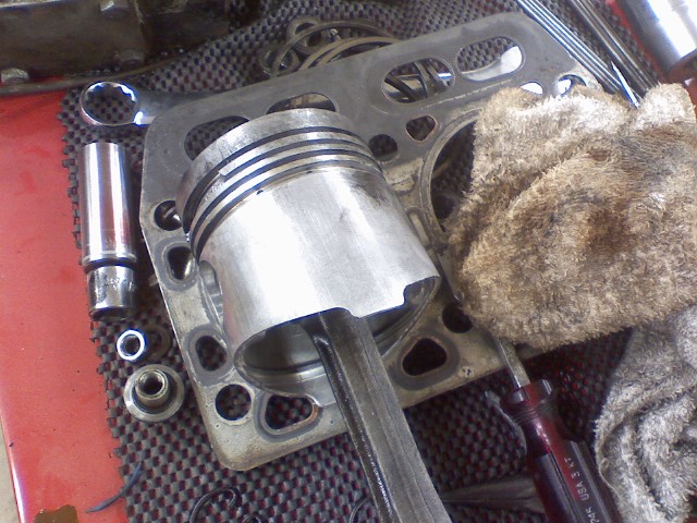

Here is a picture of the piston I pulled out of my engine today.
The rings looked really good but part of the piston was broke inbetween the top two rings.
I think this may be my hard start and lugging problem when taking off from start.
What are your opinions?

Ouch. where did the broken piece go ?
Was there a comp test done before tear down ?, results ?
   / YM2000 piston. I think I found my running and starting problem #3
you found the problem...were the pieces in the oil pan? How do the liners look?
   / YM2000 piston. I think I found my running and starting problem #4
Any pics of the cylinder wall?
The piece was still in between the rings, in place just loose.
There was no wall scaring at all. I could not believe it myself if I did not see it.
I did not do a compression check before hand.
   / YM2000 piston. I think I found my running and starting problem #6
that makes sense. I would still give the liners a once over. new rings and bearings and you should be all set.

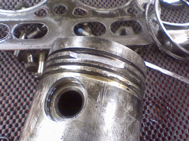

Is it possible that the piston broke during dissasembly? The break and casting surface looks very clean to be broken for any extended run time....Just playing the devils advocate here.

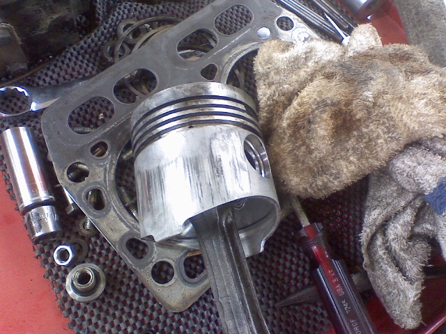

The only reason I think it has was broke before I got it is that there is scoring on the side of the piston like it was pushed over to one side.
See the pics one of each side.

I broke one it looked just like yours when I didn't ream the ridge off the cylinder (young and naive) I just hammered it out. then I reamed the other 7on that motor and they slid right out and reamed then first to get new pistons back in.
