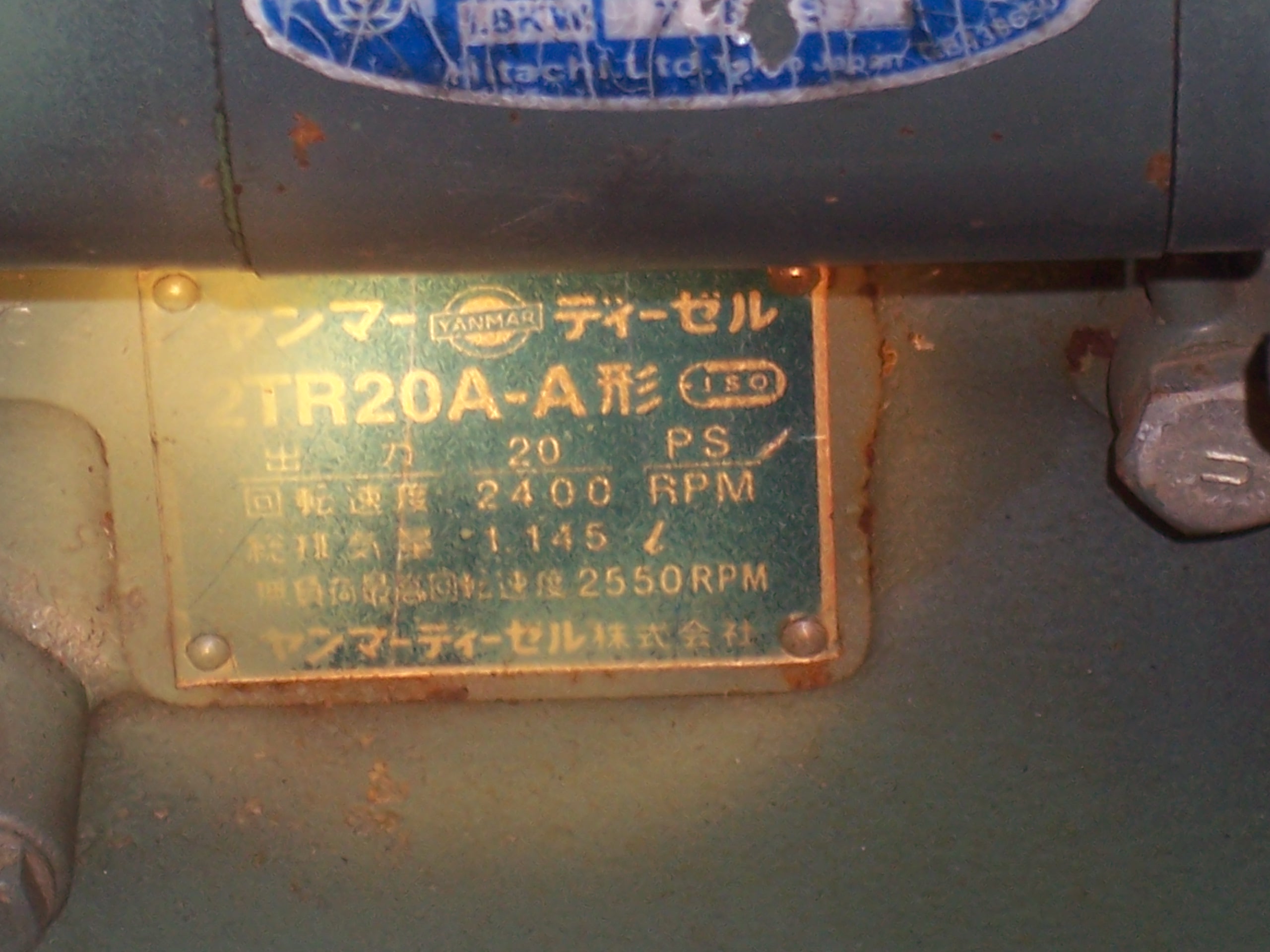

Engine series 2TR20A was in most (all?) of the YM2000's sent over here. I think 2TR20A-X (same as my '81 US Yanmar) should be in a YM2000B.
(all?)Thats what I havn't been able to figure out myself as for -A.
Translation:laughing:

Carey, that tag looks different than mine. I dont have mine here to take a picture of but mine does not look like that?? Do i have a knoc off chineese implant yanmar engine in my VN tractor?
   / ym2000BD is the price right? #34
I had a feeling of that Clemsonfor. Nobody has been able to clarify it yet. Steve at Spalding is as about as Honest as they get. When I bought and asked him. He said he didn't know were it came from. A trade in Believe. My guess was a VN. imp. that was able to get put back together. I ruled that out when I was going through it straightening out a few things. Looks as though the Head has been off at one time thats about it. But definatly not Split.
Carey

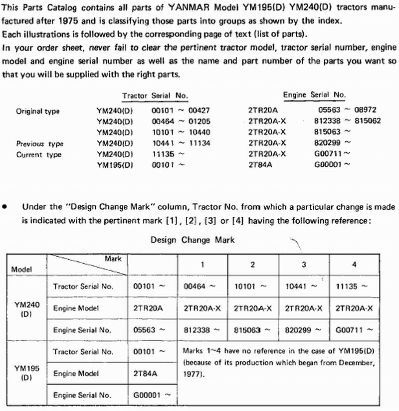

FWIW here is the revision level chart for US YM240, the twin of YM2000.
In contrast to YM2000 Green (rare here), YM2000 Red, and YM2000B, which I think were single-year models, the US Yanmars were sold from '75 (?) through the end of sales in 1981 with little change.
Revision Level 1 had headlights on the side of the hood same as YM2000 Green.
My YM240 is revision level 3. (Level 4 had the air cleaner outside the hood). But my engine # falls between level 3 and level 4 according to that chart. The engine plate says 2TR20A-X while the engine # stamped on the block nearby is 2TR20A G00----.
I don't know how much of this applies to the Japan Yanmars. My guess is that YM2000B would be equivalent to level 3 or 4, except with better sheet metal and instruments.
