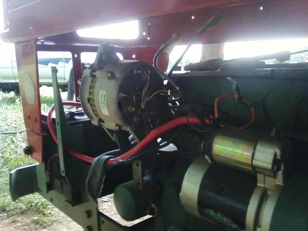

Ok, the mechanical part is complete. A few pictures to show that. I put the alternator next to a coffee can so you can get a better idea of the size of it. Used a 39" A belt.
Now the bad news. It won't charge. I first hooked it up as best I know how according to the hand made drawing Scotty Dive had attached in post #17. Nothing there with charging although all electrical worked including warning lights. I then disconnected everything except a wire from the battery to the post on the alternator. Still no charge. Showing only battery voltage. Have I got a bad alternator??? :anyone:
This is the alternator. Alternator Chevy Mini Denso Street Rod Race 1 Wire 8162 | eBay
My reading indicates this is suppose to be a self energizing alternator.
Back with an update. I have found running a hot wire to the spade terminal closest to the post terminal will excite the alternator and it puts out a solid 14.5 volts. This tells me the alternator is ok. Just need help in making proper connections. I know there is help coming so I will be waiting.

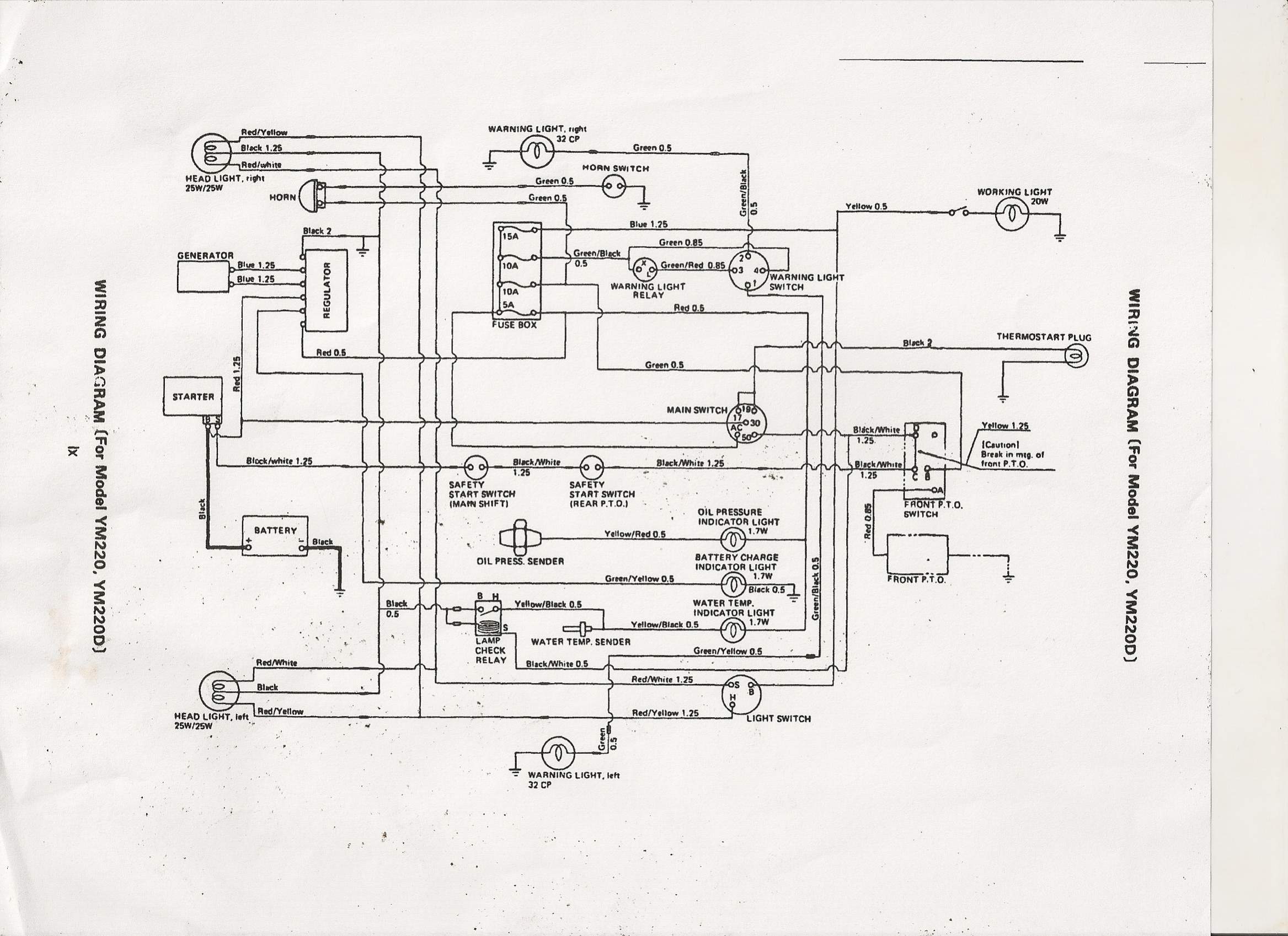

Another update. I am attaching a scan of a 226 . The plug colors of the regulator are identical to my 2002. Anybody tell me what colors go where, etc.
Well, I'm having fun talking to myself anyway. I found these instructions. I am part way there. If I can figure out the ignition light wire maybe I will get it. Going to be busy tomorrow so may not get to tinker with it. But I will be back. http://westfield-world.com/daihatsu_alternator.html

OK, i see 2 terminals and the stud. 1) Stud connected to Batt+ for charge 2) one of these spades is the charge light and the other needs a switched + wire from the ignition switch for voltage sensing. you may also have to change your charge light lamp for a 5W one if it's not already for it all to work correctly.And another thing, i told you that you were cluey enough to sort one out.....:thumbsup:
   / ym2002d alternator possibility
#31
Thanks for your response Neat, my post wire goes down and hooks up right before the fuseable link that is right before the solenoid. Pretty confident this is correct. Closest spade to the post on the alternator is the exciter spade and I have it hooked up to a wire coming out of the old regulator plug that is energized when the switch is turned to the on position. This arrangement has the alternator charging.
Problem is the warning light. I know the green and yellow striped wire coming out of the old regulator plug goes to the charge light because I can touch 12 volts to it and light it up. I really don't understand how it works. If it takes voltage to light it, then seems like cutting the voltage off is what turns it off. I am thoroughly confused about it. Hooking it to the other spade on the alternator doesn't do anything. Anybody tell me just what kind of signal is suppose to be coming from that other spade on the alternator??? I feel pretty stupid and confused right now. :confused3:
   / ym2002d alternator possibility #32
You need to put 12v+ on one side of the warning light and the other side to the alternator, job done. It will then operate correctly. it turns to a - when it is NOT running, therefore illuminating the lamp. When it is running it becomes a + thus extinguishing the lamp. Thats the basic mechanics of that terminal :D
#33
I pulled the dash out far enough to access the bulb. It has a 3.4v bulb with two wires. One of the wires goes to ground. The other wire I have identified as the green and yellow wire on the regulator plug. Schematic shows it goes straight there without going through any other place. No voltage on the green and yellow wire with key in any position. Are you saying if I hook up 12 volts to the green and white, then take the ground loose and run it to the alternator spade that it should work?? I'm slow as you can see. :confused2:
   / ym2002d alternator possibility #34
correct. do you mean 3.4watt? it needs to be a 12v lamp at 5 watts to work, the older alternators needed this but i am pretty sure the newer style with voltage sensing dont need a lamp that big but it wont hurt it. and yes ignition supply to lamp, other side of lamp to alternator and thats all it needs.
#35
Oops :ashamed:, sure I meant 3.4 watts. I'll give that a try this morning and see what happens.
I am back with a success story. I did not change the bulb but hooked up as you dictated. I am charging with light out. Light comes on with key in run position, once she cranks, the light goes out. Thank you very much Neat 1500 and also thanks to all those who have given me input. I hope this will be a long term cure. Moving on now to the FX24D.
