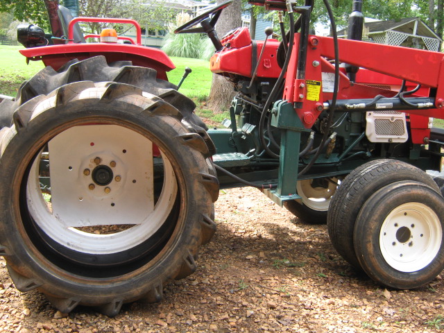

Though not sure of the actual size different in height of a 5" tire verses a 6" due to this size being the width not actually the height, The 14" wheel size remains the same, does anyone know what is the height differences between the two?
I know the difference on the rear from 8.3 <to> 9.5 in approx 1.5 + 1.5 giving a total of approx 3" in height ,
the attached photo can provide reference to the difference you see when changing from 8.3 to 9.5
