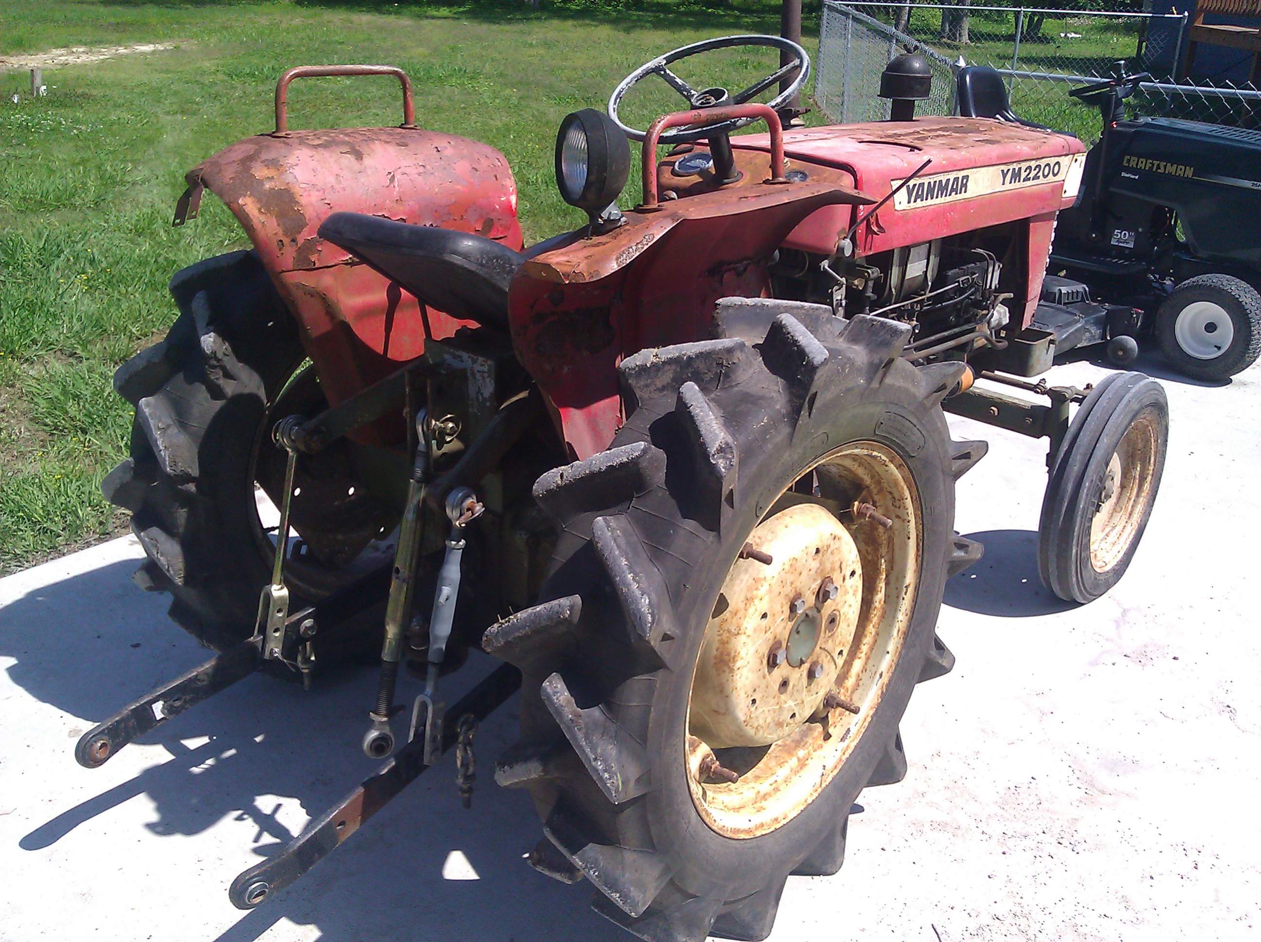

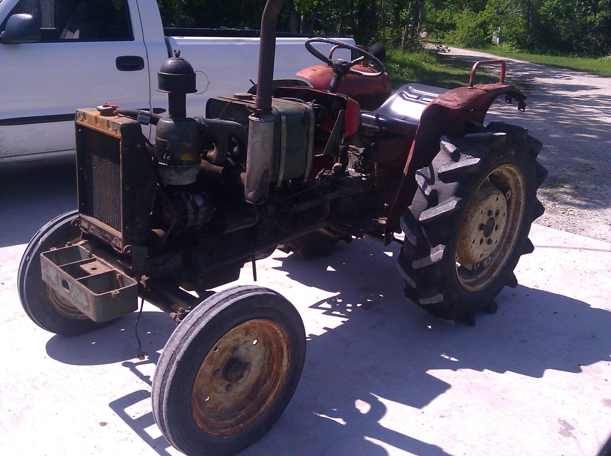

Just wanted to update my thread. I couldnt find a buyer in my neck of the woods for a non running yanmar and so I decided to work on it a bit. I discovered one of the push rods had bent and came away from the rocker arm. I assume when it ran out of fuel it caused the engine to stop hard. I removed it and placed another in and it started right up. I still want to sell it, but that means I need to ask more for it. Has quite a bit of rust forming, brakes are gone, gauges arent working and needs a new seat. Other than that it starts up, PTO engages and hydraulics work fine. Anyone in SE Texas want this for a good project let me know, I will also list this back on craigslist and go from there.

Id either explain that in CL add or use different pics in totally different bacgrounds from different angles. Folks will be suspicious if not, as last week you were selling a non running tractor this week it "runs" and costs 1K more?
