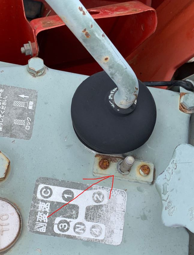

A few days ago I bought my first Yanmar tractor. The shifter pattern shows 1 through 4 but it also has a "C" gear listed. I can't seem to get it to go into this C gear. Anyone know what it is?

C is creeper... lower than 1st.... shift into 1st and keep pushing forward to creeper
   / YM2310 transmission question #3
My YM2002D also has a creeper range. Mine has a 10mm hex pun which blocks it going into creeper mode. I have removed it to check it out. In high gear in creeper, a person can easily out walk the tractor speed.
In practical application, I have never found a use for the creeper range gears. Range 1 gear 1 has more than enough torque and is slow enough for any activity that I have ever needed. This includes tilling ground that had never been tilled and pulling several vehicles out of ditches, mud, snow.

You will just need to pull that little knob straight up in order to move the shifter into the C range. As others have mentioned it is EXTREMELY slow.

I saw that knob and knew it had some purpose. I'm gonna try it out tonight.
