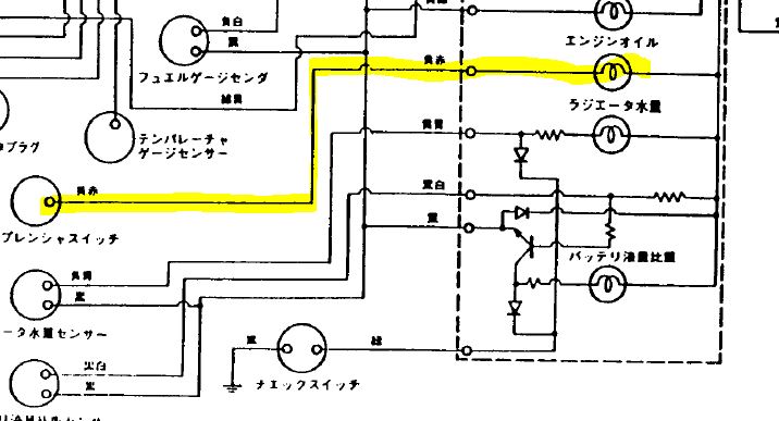

I might be wrong but I don't think the check button does anything to the oil light on the 2310. Unless I'm interpreting the wiring diagram wrong, I think it only checks the temp light & low coolant lights (both lights would be difficult to check without this feature). Some other models like the YM1610 show the 'check light' diodes going to the oil pressure light as well but not the 2310. The oil pressure light & circuit can be 'tested' by just turning the key on. Does the check button light up your oil light now that you fixed the connection?
   / YM2310D Oil Pressure LIght
It does. When the connection was bad, only three of the four lights would glow. I knew that before, all four would glow. Now that the connection is good again, all four glow when the check button is pressed.
