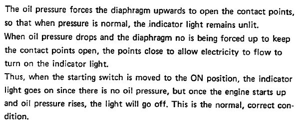

If the sender "sees ground" to display a warning light, and oil pressure "opens" the switch to remove ground and turn the light off, wouldn't disconnecting the wire "remove ground" and turn the light off? After reading Aaron's post above, I believe mine is now (since re-connecting) "ON" with key on engine off, then after starting, the switch "sees" pressure and opens to turn the light off. I do think (going to double check this evening) that pressing the "check" button with engine running will turn ALL 4 warning lights on to confirm function. Maybe the 240 is "normally open" instead of "normally closed"?

From the YM240 service manual....
I guess I have an unexplained mystery. I saw the light on steady as I drove back to the barn, over rough ground that would have jiggled an intermittent ground. My instincts were saying 'Stop and investigate the failed oil pressure, save the engine!' while I kept telling myself the light on meant nothing. Heck maybe I dreamed that the following night! :pessimist:

Alright...I checked mine and Aaron is correct. When I turn the key on, the Alternator and Oil Pressure lights come on. Once engine starts and the sender see oil pressure the oil light goes off. As an aside, the alternator light doesn't go off until I get enough RPM to start charging the battery. When running, if I press the "check" button only the "battery" light and the temp lights come on.
