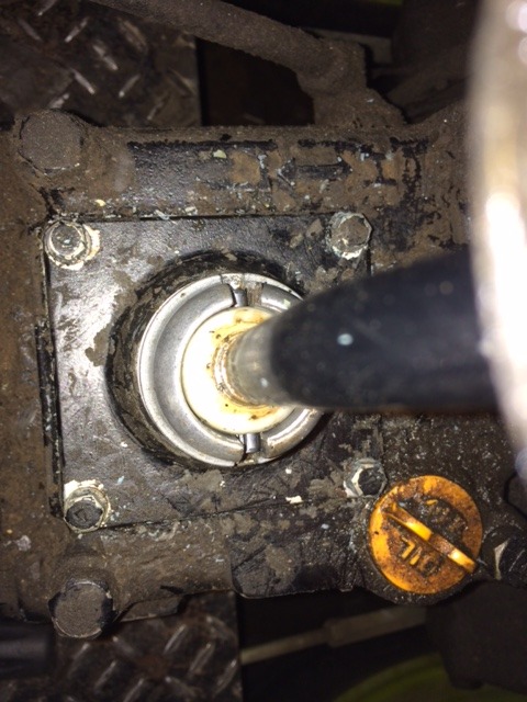

Sorry about that, see if I can get the pictures to work...

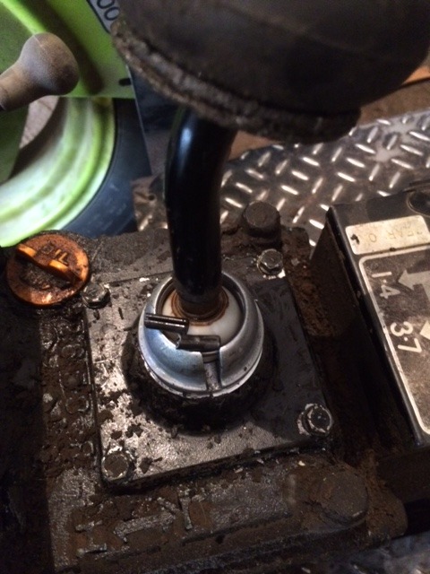

Nice job, looks like it was fairly easy once you figured out what the problem was.
   / YM240 Loose Gear Shifter
#13

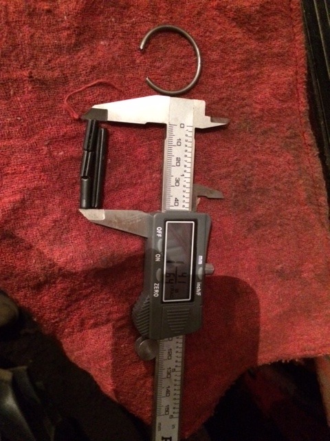

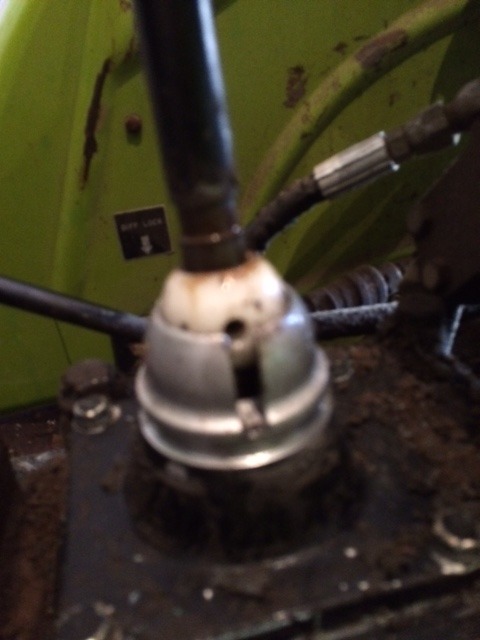

Very easy, and even better, CHEAP! Putting the pin back in and everything back together was less than 5min - taking it apart was probably 20min but most of that was trying to get the clip maneuvered around to get it out...which again may or may not have been necessary but I will say the ball didn't want to turn as easy to expose the hole w/ the clip in there since my pin was in 3 pieces and had rotated around but it could probably be done. Thanks again for the help everyone!
