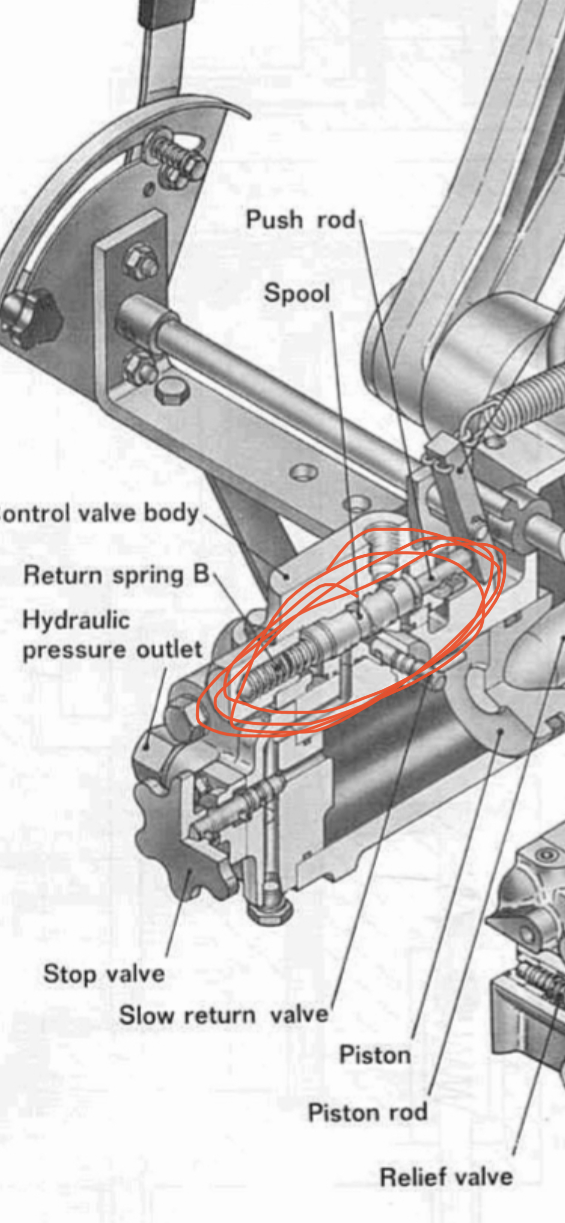

Next I removed the pressure relief valve. Found nothing, then cranked the engine again to flush it out.
Next, I removed the Spool cap and spring.
It appears the Spool is stuck solid. Should this be able to slide out when the cap is removed?!

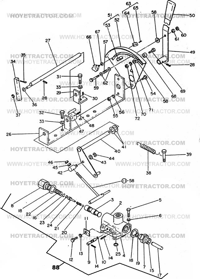

   / Ym240d 3 point stuck in up position. #24
You cannot use the loader valve with power beyond unless you have purchased the adapter from Hoye.
Yes the spool should come out.

I completely removed the spool housing from the machine so I could take it into the shop
To work on.
I removed the pushrod, cleaned and inspected it. It appeared okay and moved well within its seal.
I then tapped out the spool assembly. Nothing seemed odd with that other that it didn’t remove easily.
Clearly machines surfaces, but I would have expected a little more free movement of the spool within the housing.
Again, having never worked with hydraulics before, I’m not totally sure what is required.
I cleaned the entire assembly including the spool with clean diesel fuel.
reinstalled and hooked up the hydraulic line.
The lever moved the pushrod easily again with the engine off. Before I couldn’t budge that pushrod.
Fires it up and everything is working well again.
I’m not clear as to what the issue was, but appears somehow the spool or pushrod got stuck in the extreme up position.

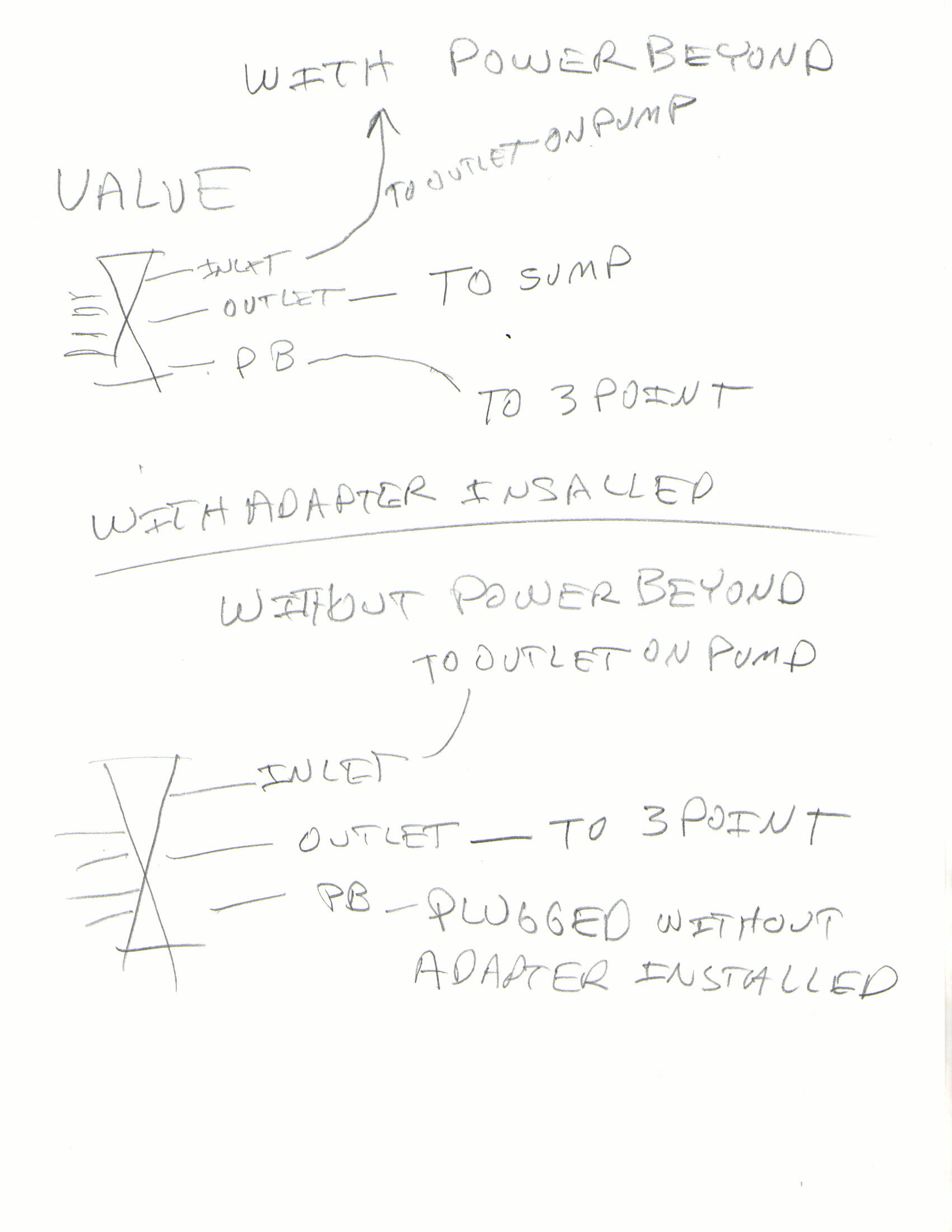

As far as the power beyond adapter goes, I guess I’ll just leave the loader unhooked for now and order the power beyond adapter from Hoye.
If I understand correctly, I would also need to add a new hose from the output port on the loader valve (currently blocked), which dumps back into the trans.
Am I correct?
   / Ym240d 3 point stuck in up position. #26
Correct, however, many a Yanmar is running without power beyond. You would be perfectly safe to run from outlet to 3 point with the power beyond plugged.

That’s what I see in a couple other threads.
I might just swap the ports used on my valve and see what happens.
I sent a support ticket to Hoye to better clairify the power beyond.
I wish they had sent some actual instructions with the loader valve. Oh well.
   / Ym240d 3 point stuck in up position. #28
Rather crude but it is this simple.
   / Ym240d 3 point stuck in up position. #30
I cannot tell you exactly but can tell you with it in use when using the loader valve the outlet will go straight to the sump and not be restricted by the 3 point. But when using the 3 point the flow will come through the power beyond straight into the 3 point control valve. This will give a little faster loader speed but not a lot. This all based on my experience with my old 2002D that I converted to power beyond.
