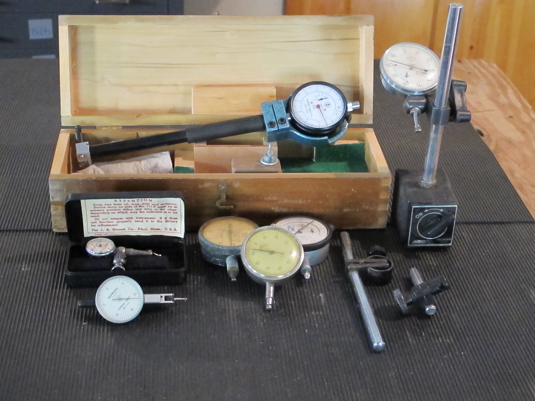

Here is a selection of mechanical dial gauges for precision measurement and setting up backlash. One tends to accumulate these things. Today most measurement is via laser. These old mechanical style gauges last forever and with luck can be picked up cheap at used tool stores. I bought these in the 1960s - and most were used at the time.
As several others here have posted, after you have set up a few things you will get used to the "feel" of backlash and then the dial gauges become almost superfluous. One simply substitutes feel for measurement - as in "some play, but not too much". For the experienced person that says it all. But I still like to use dye to confirm that the engagement of the gears is roughly across the center of the mating teeth. The shop manuals and that video you posted show examples of tooth engagement. It's an art as well as a science.
rScotty
