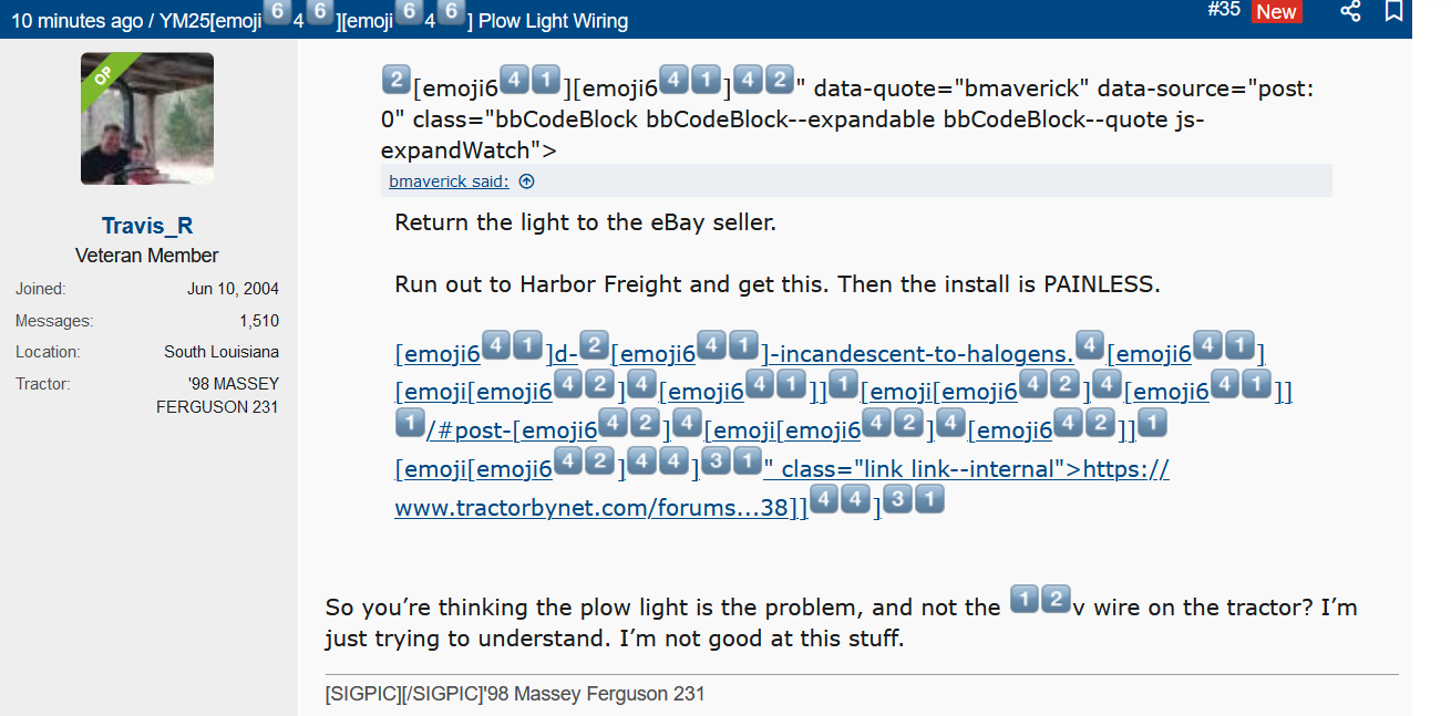

***UPDATE 12-16-2024***
PROBLEM SOLVED! The plow light is now fixed and working exactly like it should.
I had roughly 8 hours in it with about 4 packs of blown fuses and couldn’t get it to work.
My mechanic had it properly working within about 8 minutes.
The switch on the plow light was wired wrong from the factory! They had 2 grounds going to each side of the switch. My mechanic had to do some cutting and splicing and route the hot wire into the switch. That’s all there was to it!
