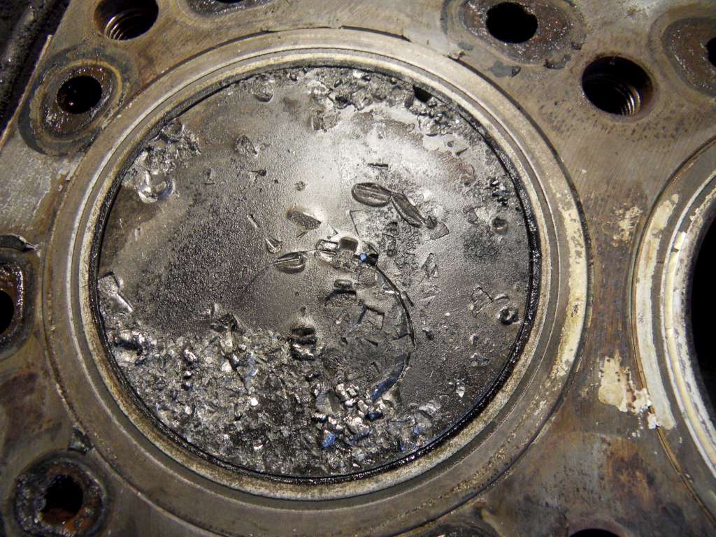

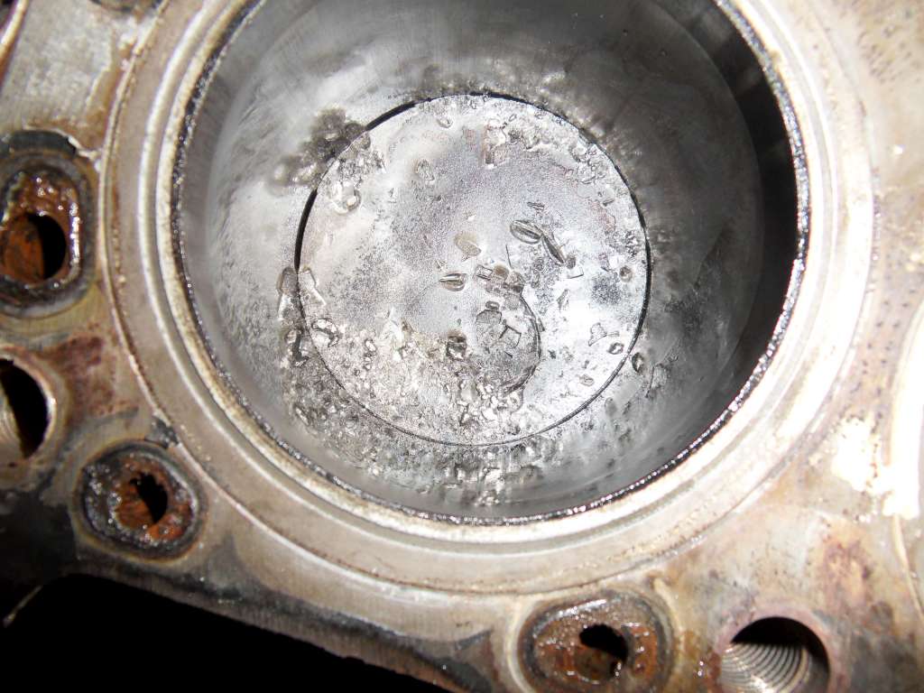

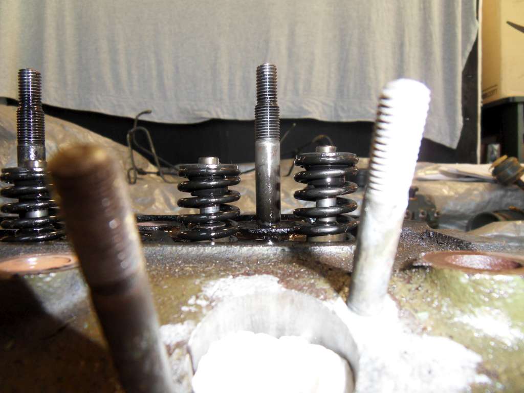

OK I've had some other fires to put out but finally got to pulling the head on the motor and can't believe what I found. At some point in time this motor had dropped the exhaust valve in #1 cylinder. You can see the damage it did to the piston. Whoever rebuilt the motor decided to use the existing piston and it has been running for 2 years so I can't really say it was bad but it looks bad. Cylinder must have had the sleeve replaced because it is in great shape. Not even the slightest scrape. You'll see in the pictures that it reflects the piston head onto the walls making them look pitted but that is only a reflection. The exhaust valve must have hit the head and damaged the seat area because they cut out metal in the head and then made a new valve seat area. I've never seen anyone do something like that. Unfortuantely they didn't do anything to the valve spring so when it has no seating pressure when it is seated. You can push it down with any finger and little to no pressure. If they were going to do this they should have at least added a shim to the top of the spring to make up for the metal they took off the head. I'm guessing I'll need to find a new head for this motor. The push rod was also bent and they did not replace it either? What does everyone think on the piston? Replace or go with whats working? I really don't want to replace it but feel like it might be best. I'm trying to avoid any more cost but not sure. Please let me know what experience any of you have had with running pistons like this one. Appreciate any help or suggestions. SDC10115-1024.jpgSDC10118-1024.jpgSDC10120-1024.jpgSDC10126-1024.jpg

i think you will be unhappy unless you look for an other piston,take the head to your favorite machine shop and get some advice before tossing it,keep us posted,and thanks for the pics
