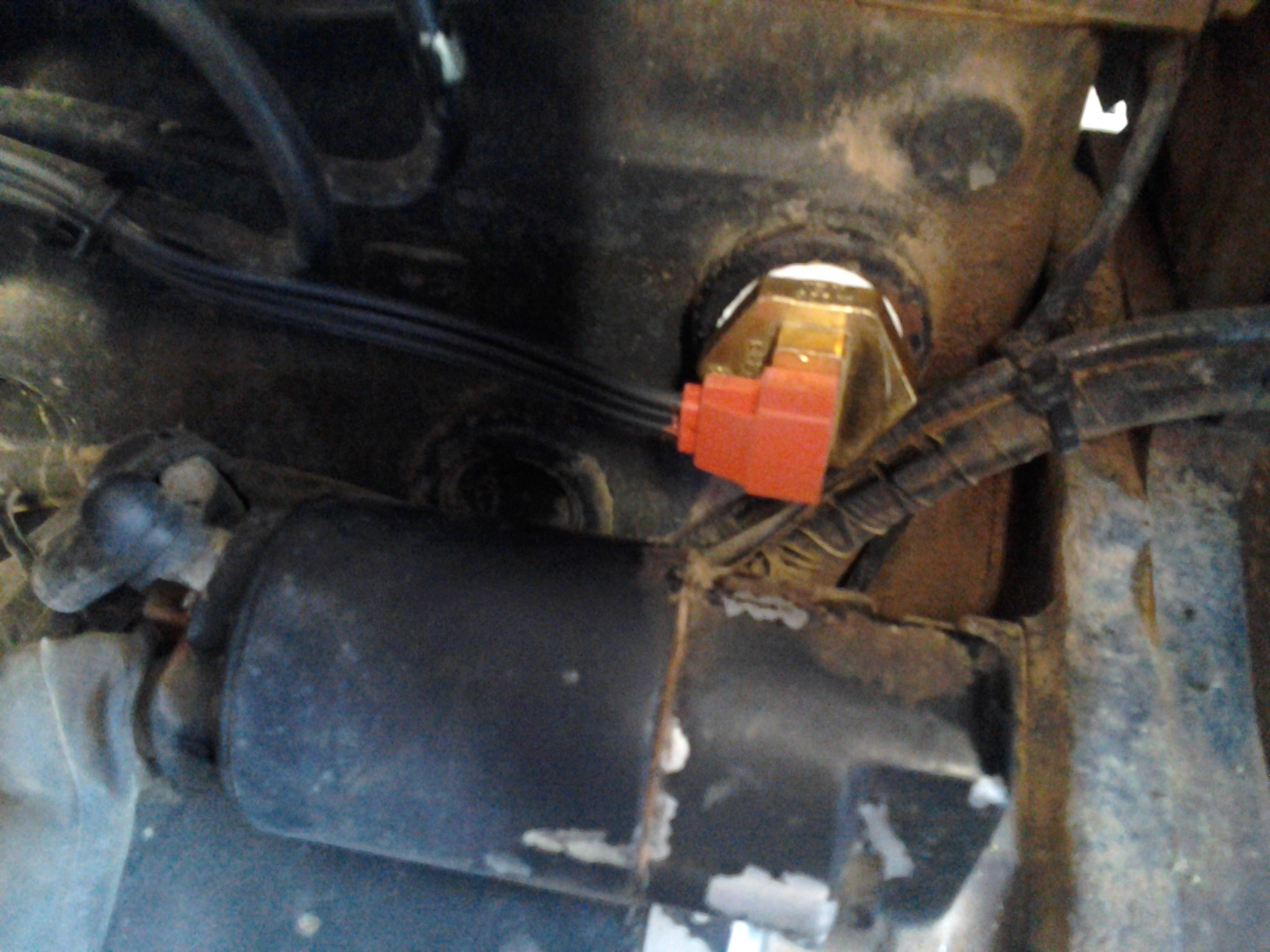

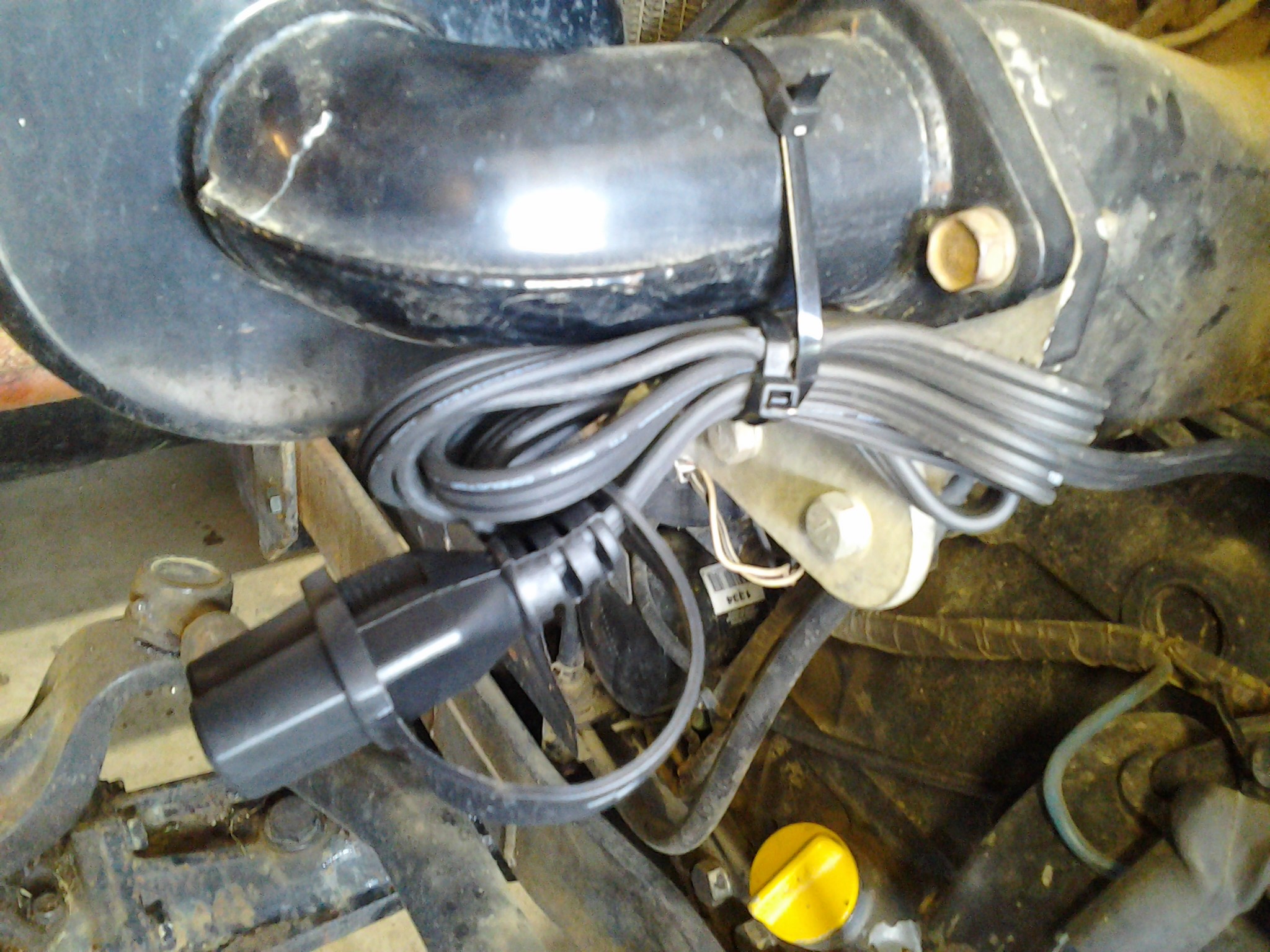

I finally got around to installing the block heater. I could not believe it when I put the power handle on it came out like it had been installed yesterday instead of 30+ years ago. I think this will be an asset this winter when I'm setting out round bales. 0925151100.jpg0925151121.jpg0925151121a.jpg
