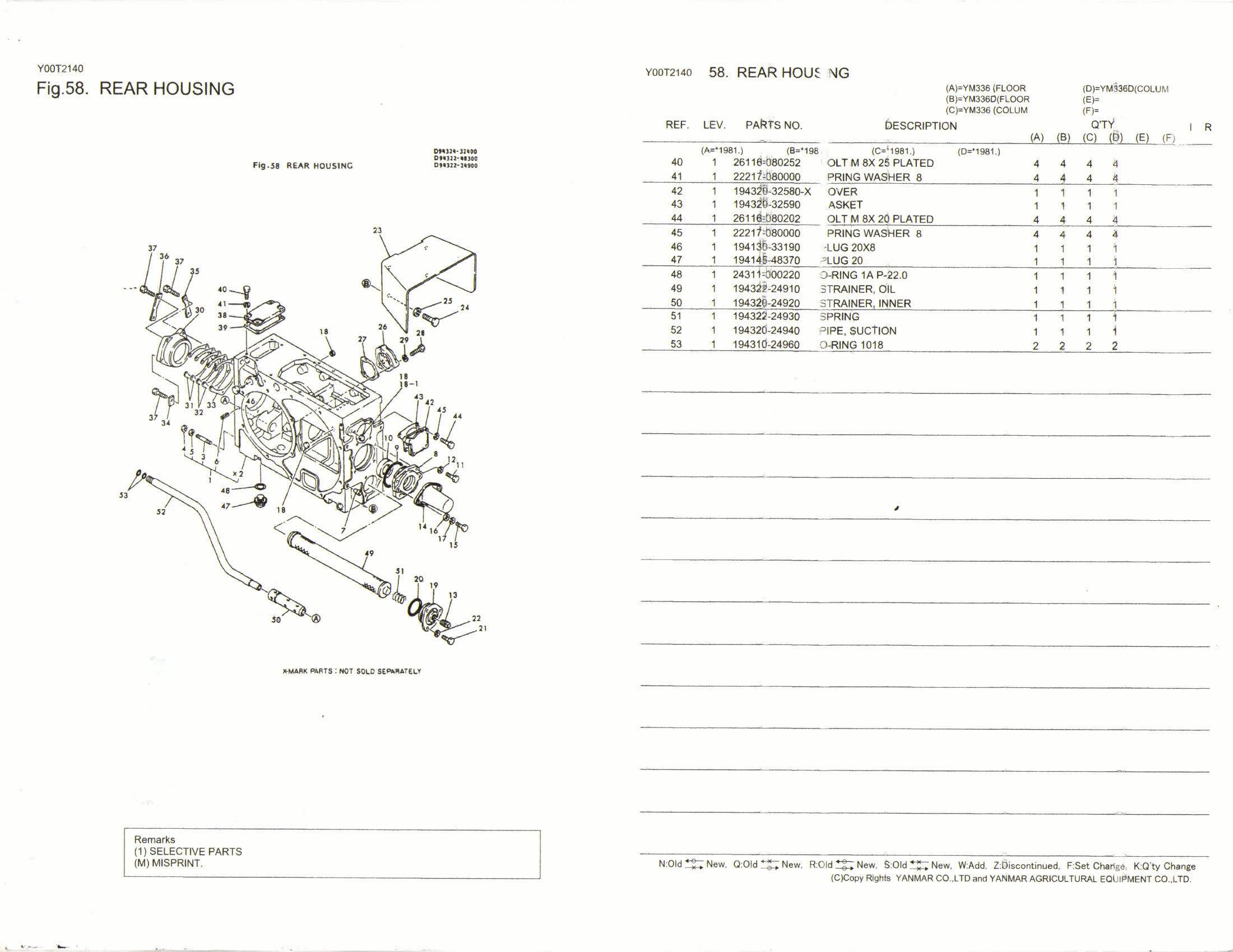

The parts manual shows an o ring for the flange seal. So you just remove the flange and pull out the screen? Is there anything else to consider while the fluid is drained?
/ YM336D Hydraulic Problems #5
You probably noticed the parts manual also shows an inner strainer (#50) that feeds the powershift pump. I am not sure just how much access one has to that.
Looking again, I do see that but don't know where it is. Is it internal or external?
/ YM336D Hydraulic Problems #9
Internal, but no idea how you access it.

#50 is inner strainer, not sure how you access it.
