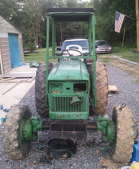

Looking at car docs diagram looks like 2 reds coming from head lights and 2 greens coming from horn. Do either of these items work?
   / YM336d: What are these parts?
#13
That's a big negative on the headlights, Houston :p
attachment.php
I have yet to find a horn, so I'm going to guess that is missing, too. Luckily I have a nice air horn set I was going to put in my boat.. muahahah! :laughing:
   / YM336d: What are these parts? #14
I can see why the wires might have been cut. Could be some grounding out going on there. The horn should be inside the hood right between the lights or where the lights used to be.:D
