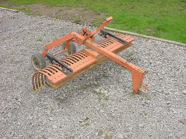

Yep, kind of steep but they last forever... I would guess the one I have is probably 15 years old and almost looks like new. All tines are straight and everything works perfectly. They did it right in that the picture on their site is identical to what they made 15 years ago. (pic of mine attached)
Brian
EDIT - PS - The price will pay for itself considering the time and pain of raking out rocks on 3/4 acre by hand.
