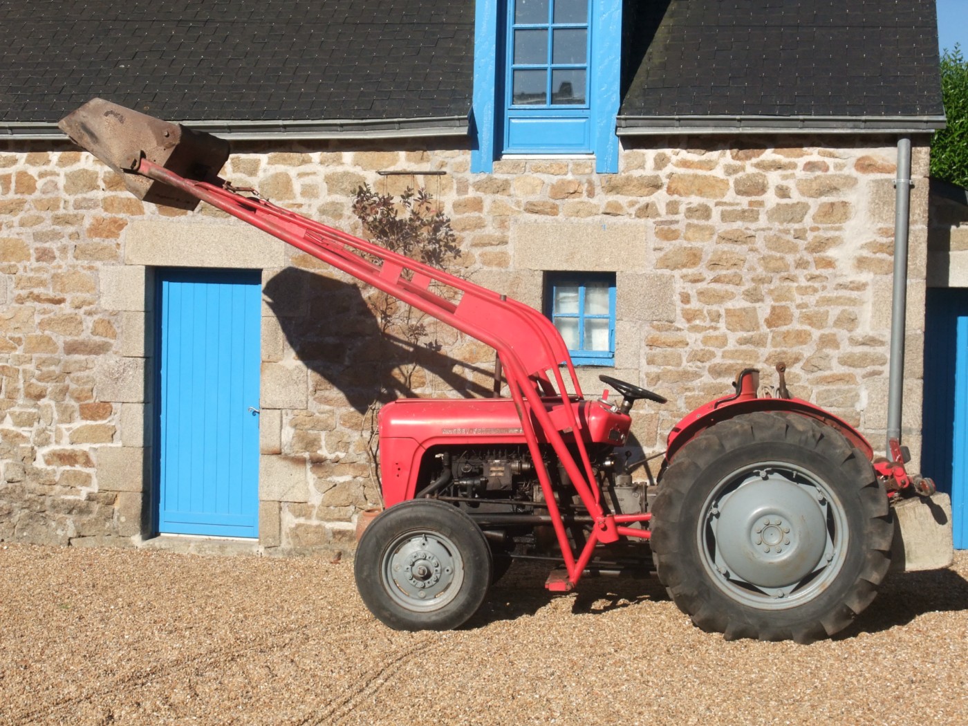

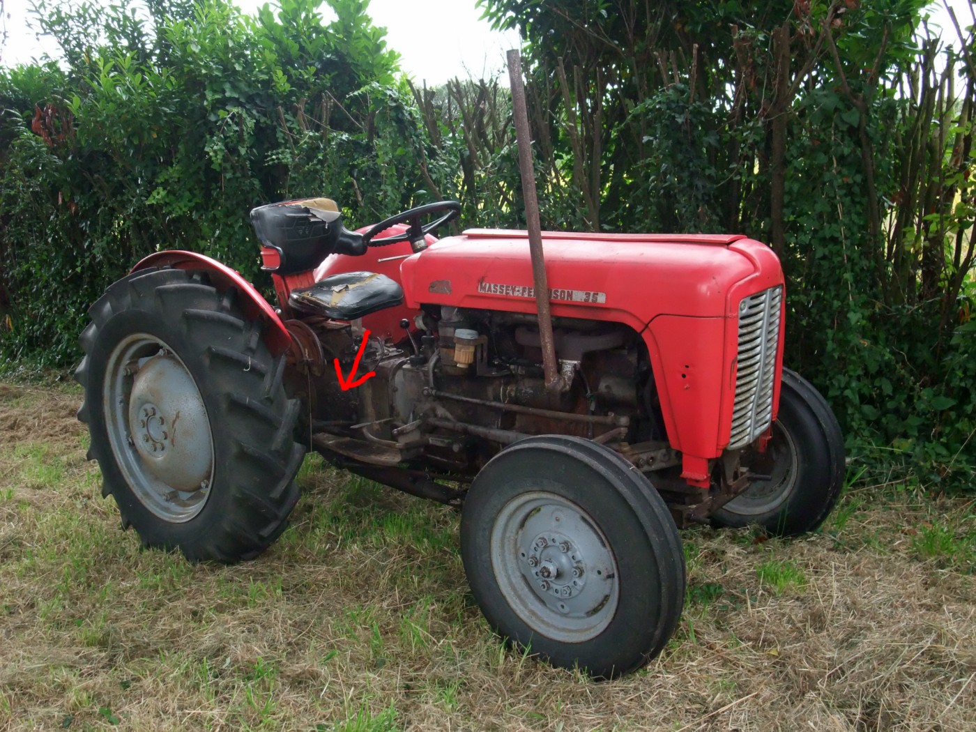

Aren't the rear tires a bit big on your Massey 35 as compared to the original tires on mine ? Or are you in a particularly muddy part of Wales ?
   / You can't use telephone wire to wire up you outlets anymore in Iowa. #72
They're standard 11 x 28, just a quirk of the photo, the tractor is on a bit of a slope and isn't all of Wales a bit muddy? Too wet at the moment to even drive over a field. Why do you think the next project is a 4 WD. Got a set of twin rear wheels to go on it as well.
