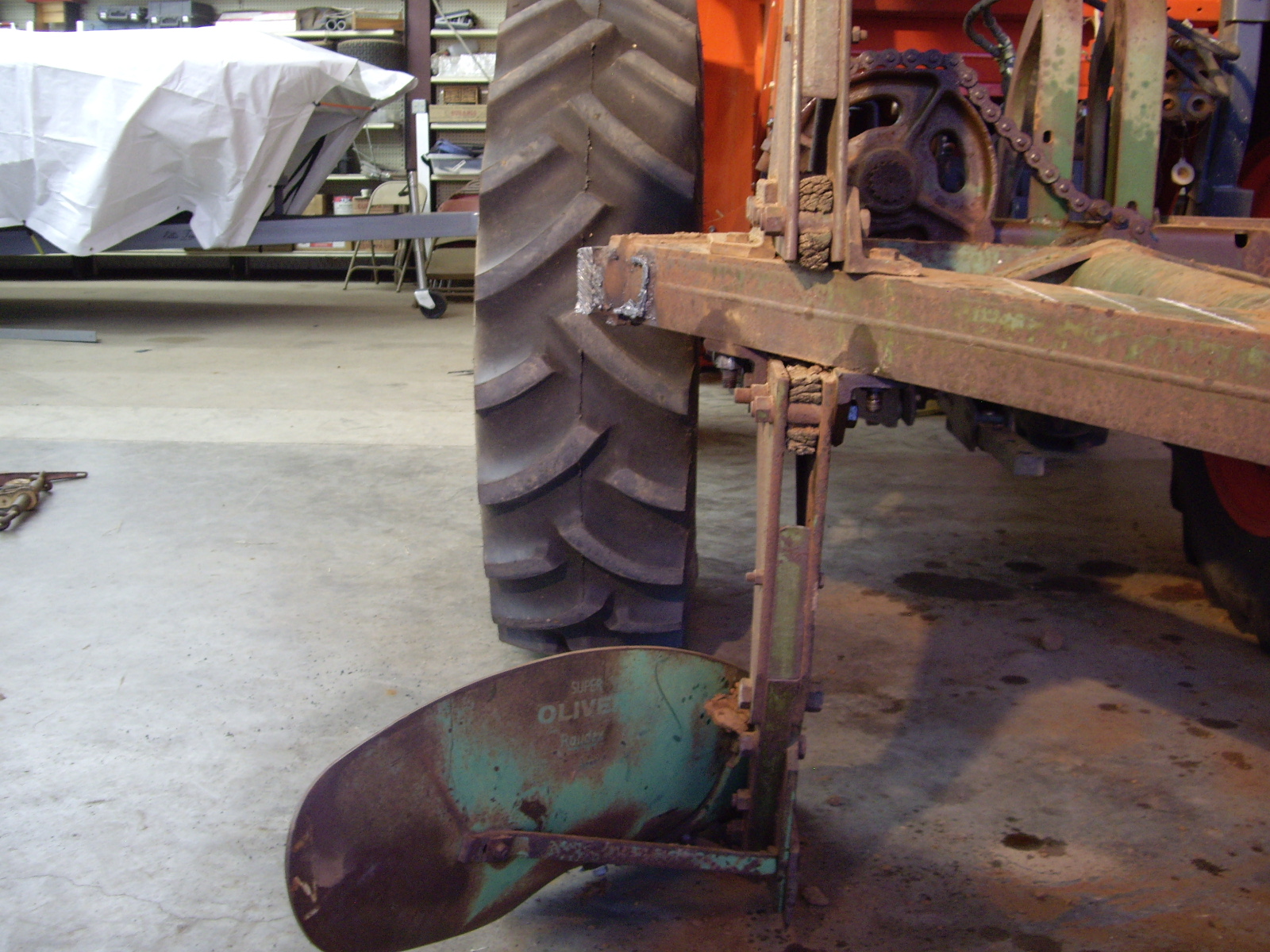

The problem is wheel spacing. I "can" get my rear tires wide enough but I don't "WANT" to set my tires wider. Once I get the plow set up at it's minimum (14") setting, I'll see what if anything I can do. I need a 6 inch wider tire spacing.
I think I understand, but you can confirm. Your tires need to be wider so the right side plow won't ride too far into the previous furrow, right? Or is it something else I'm not considering?

You are correct but it's both sides. this is a left and right plow. I think I can fix it. I'll have to drill 4 new holes in the frame. Pics in a few of what i have to do

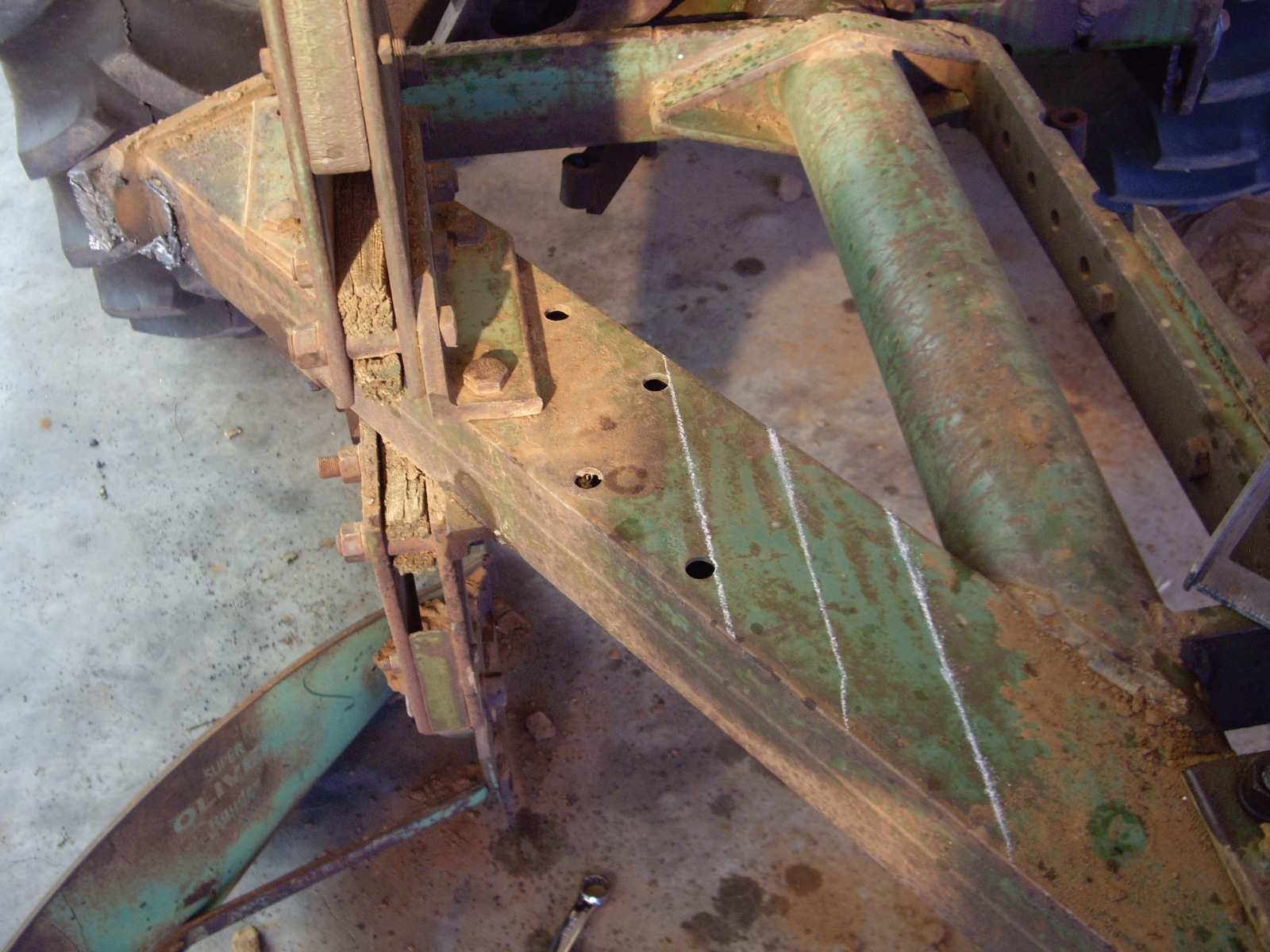

this shows the plow set up at 18" for a real tractor ;) and you can see that my wheels aren't far enough apart. the picture of the adjustment holes shows the holes where you would move the bottoms for a 16 or a 14 inch plow. I am going to put the bottoms inside teh 14 inch holes and drill new holes. Kinda hard to explain but it put the bottoms in the same place in relation to the center of the plow frame as my ford and the ford works perfectly I have a lot of work to do. every freaking bolt and nut might as well be welded together the rust is so strong. :(
When I do this the front pair of bottoms will move toward the center of the plow 8 inches, the middle pair will move 4 inches and the rears will stay where they are and I will then have a 3 bottom 14 inch rollover that will fit my tractor.

View attachment 293857View attachment 293858
Interesting project. Keep the pics coming. I'm hoping to following this until some actual plowing occurs.
