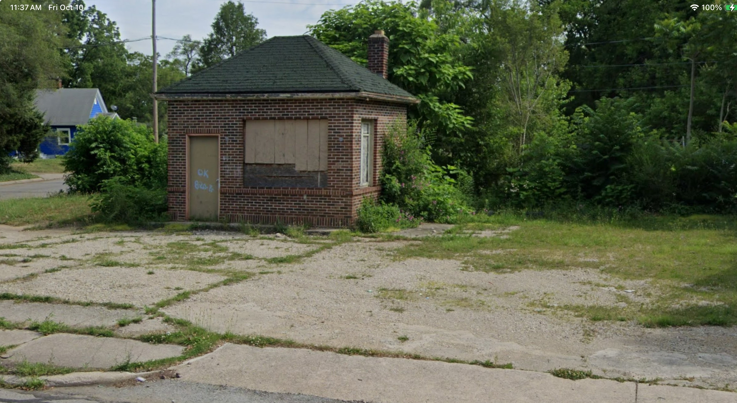

This little service station is still on the corner of LaPorte and Walnut in South Bend. As I recall, it was owned by a man named Steve Starzinski. (think that was the name on it). It had a gas pump out front and to the right of the building as you faced it they had a single post hydraulic lift outside. I still remember seeing a guy standing under it working on cars, winter, summer, didn't matter. You can still make out the concrete tracks where it set into (if you use your imagination 🤣 )
When I was growing up you used to see all sorts of little gas stations like that, some kind of in the middle of nowhere. Don't remember seeing any that had an outdoor lift. Indiana winters probably aren't as cold as those here in N.H., but still wouldn't want to be outside working on a vehicle if I didn't have to.
