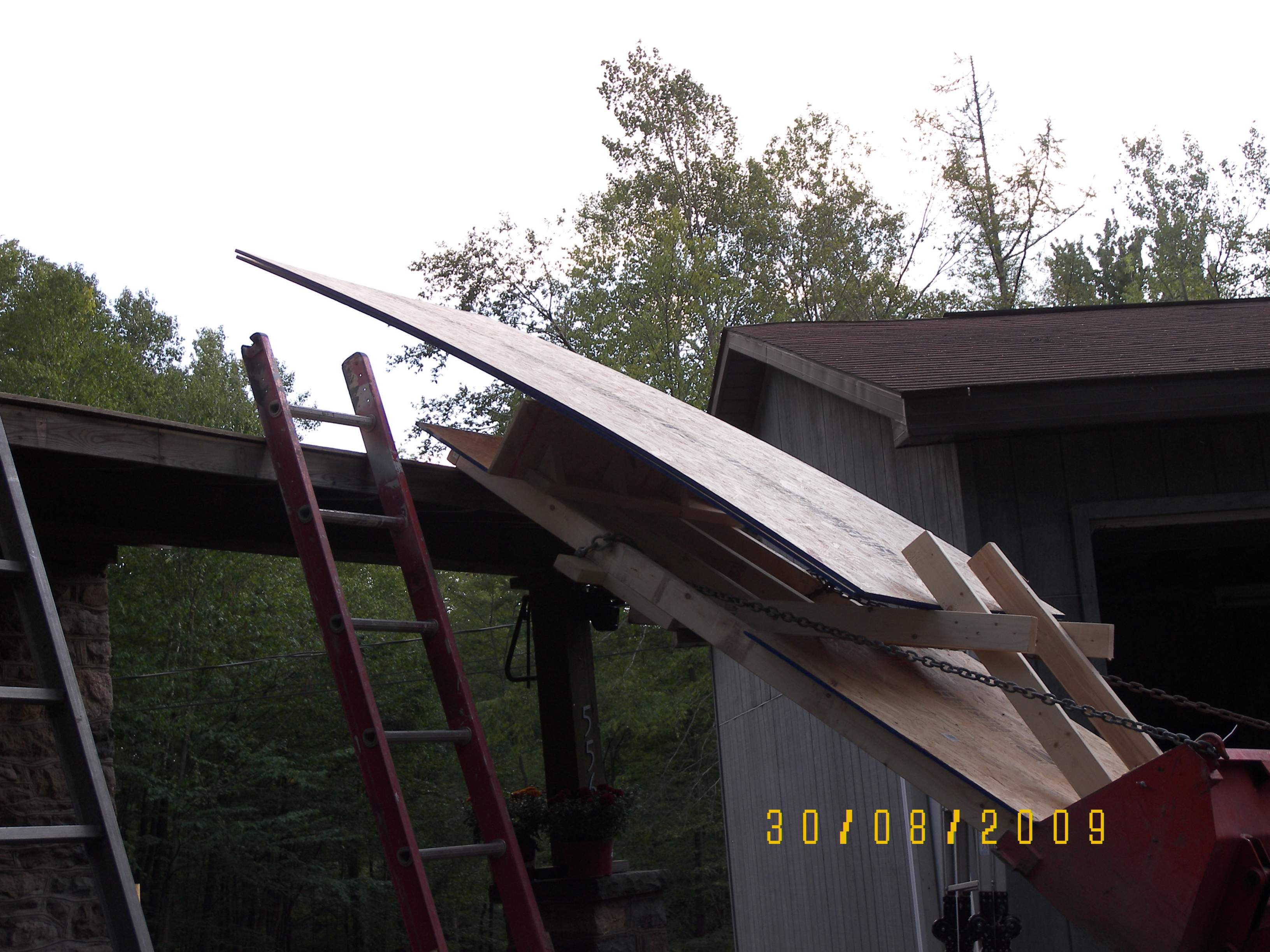

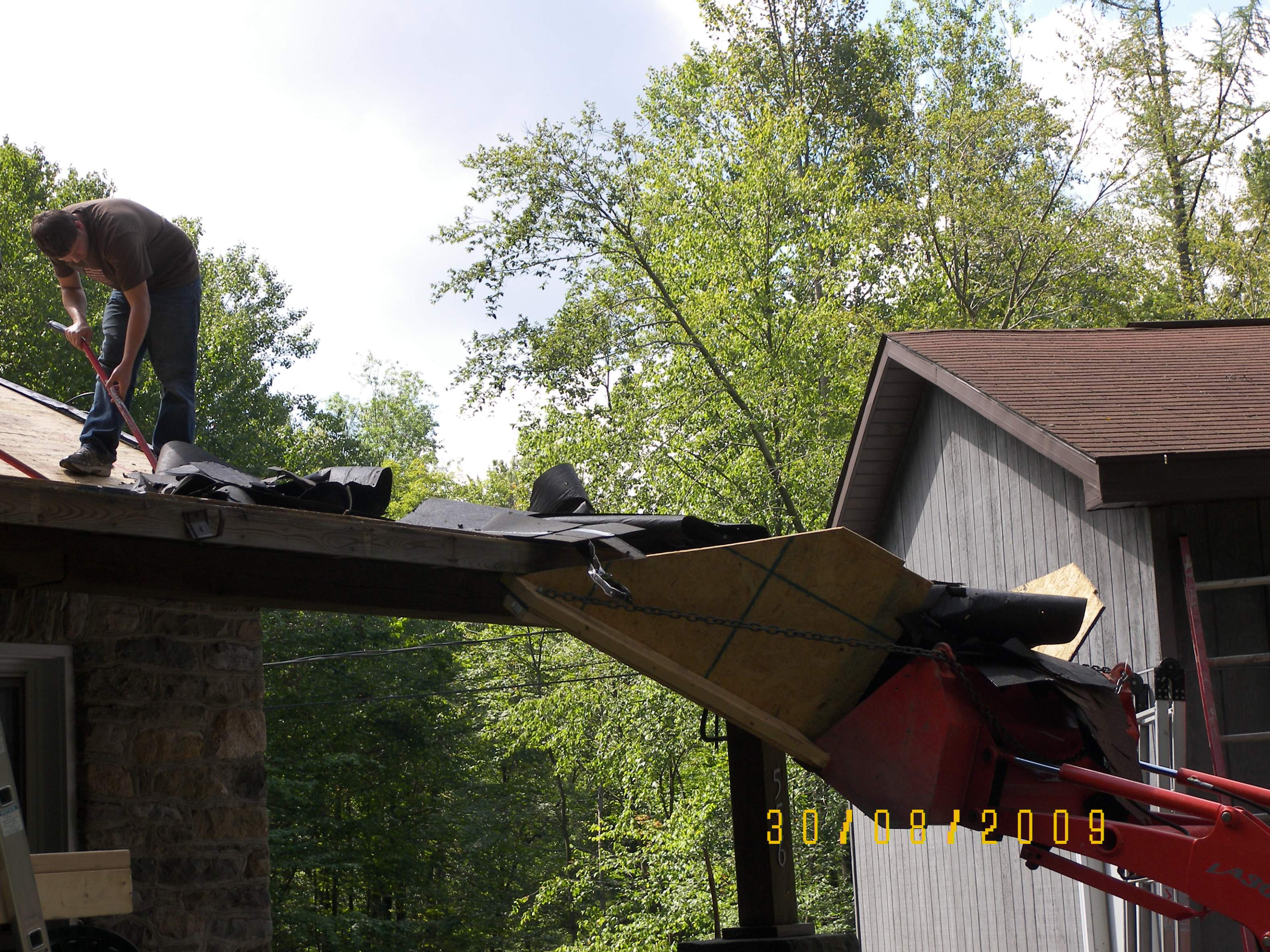

Although new to tractor ownership not new to hydraulics and mechanics. Needed to strip my roof and repair the roof deck, however, after two surgeries on my back not up to doing any kind of lifting. Tractor to the rescue. Made an oversized hopper to catch the roof shingles as they were stripped from the roof. Little cleanup and no nails on the ground. Dumped the whole load right in the dumpster. Next made an extension out of some two by fours to load the shingles and osb up to the roof. Eight foot long two by fours some scrap osb length of chain and I had a loader that could lift three hundred pounds and manage the sheets of osb. With a little help from my son and a few friends saved a bundle doing the roof and no complaints about the workmanship. See the attached pictures.
