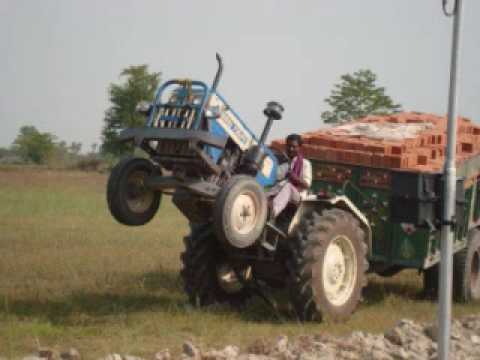

I think the key to making sure you don't trash your front axle is to use THIS much counter balance... :p
